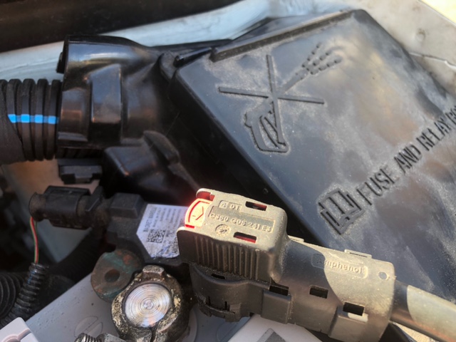

I had a look at the new battery and saw that the box next to it, "Fuse and Relay Box" is now very loose. I know that it wasn't before as I spent a lot of time by that battery over the last year and a bit. Just below the blue line, on the right, there is no clip for that black plastic pipe (?)/round half pipe, to clip in to, to secure it and stop the box from moving.

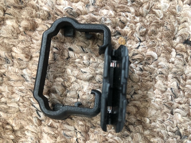

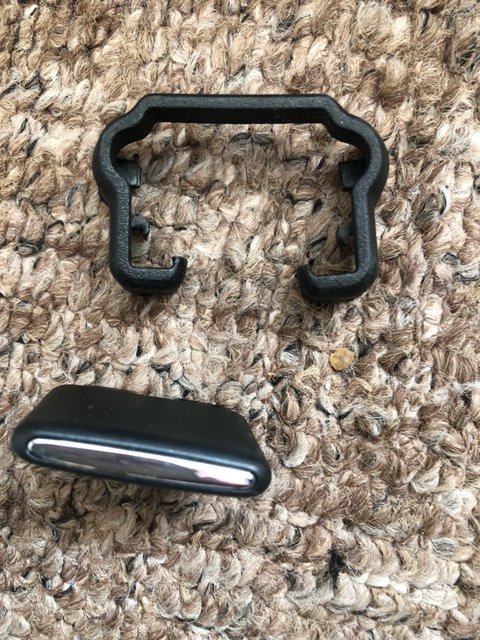

I've also found these: one in the front passenger well and the other in the back passenger well where they would have removed the panel to get to the Blue and Me. Are they needed?

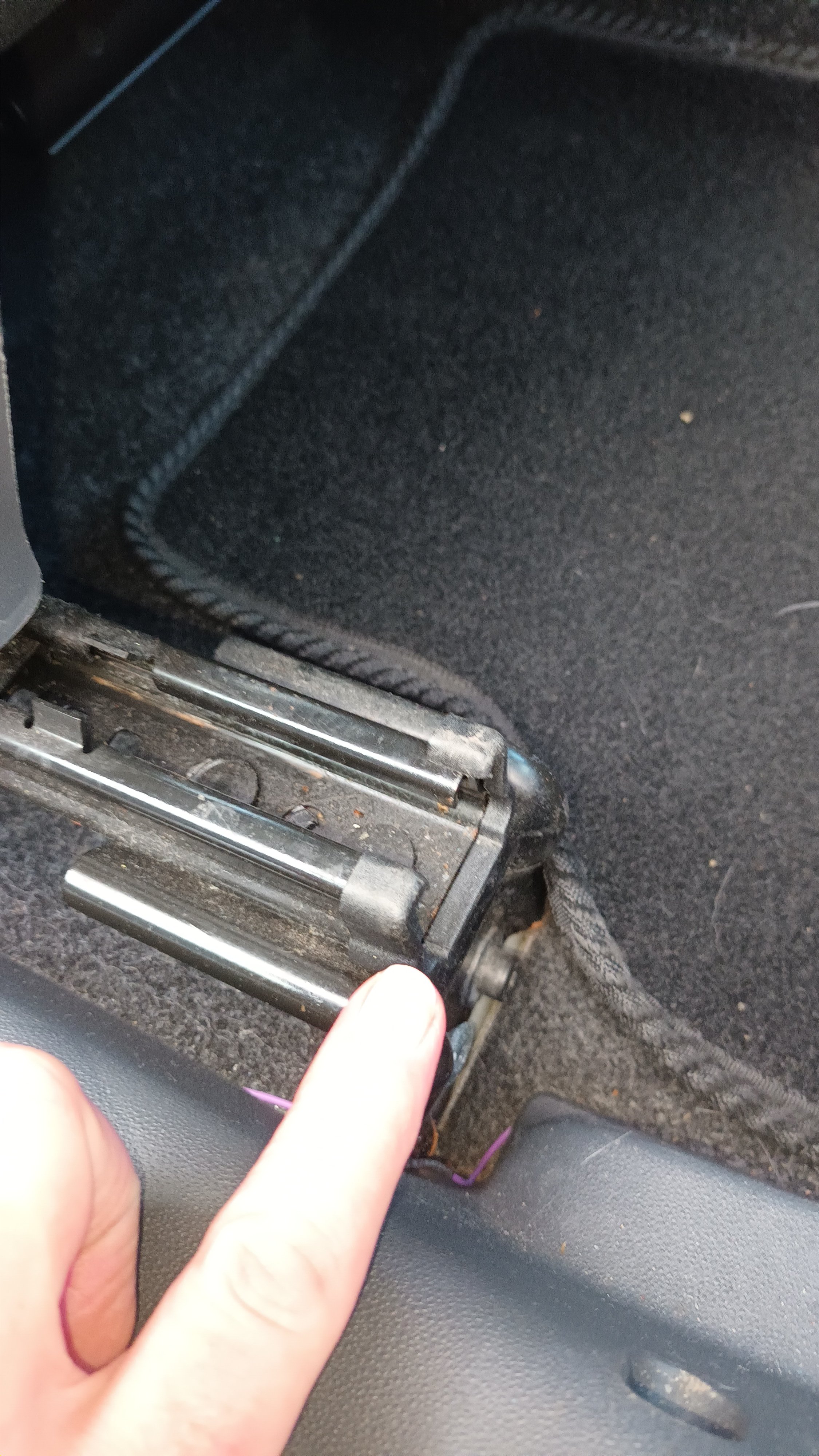

They must have taken the front driver seat out too (or the back off) as there is now a big gap between the seat and the base of the back rest.

The drivers seat gap probably the seat base adjustment, the lever on the left of the seat beside the handbrake.
The seat rail clip, press the top left on from the side not on end ways, work down and along up other side, now push the end of the clip over the top of the rail from the side, there's a peg each side that prevents you simply pushing it on the end
