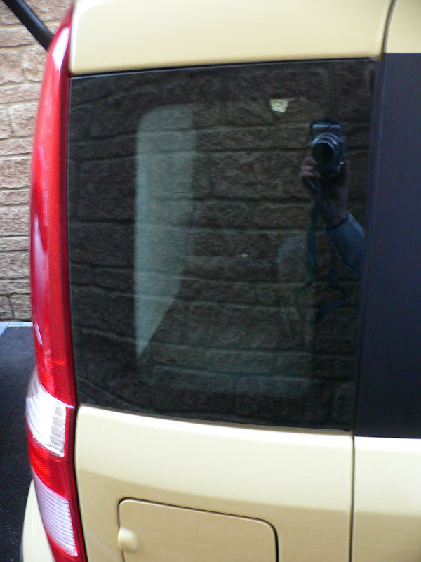

You might recall this image I posted a while back. I didn't take another picture, but it came back exactly the same. C pillar pushed towards the door. They hadn't touched it.
Anyway, complained and they said they'd sort it. So it came back today. I was at work so couldn't look at it 'till later.
It came back looking like this.
The gap between the C pillar and the door is now the same as the other side, but the glass still doesn't line up with the door. Hmmm. More on that later...

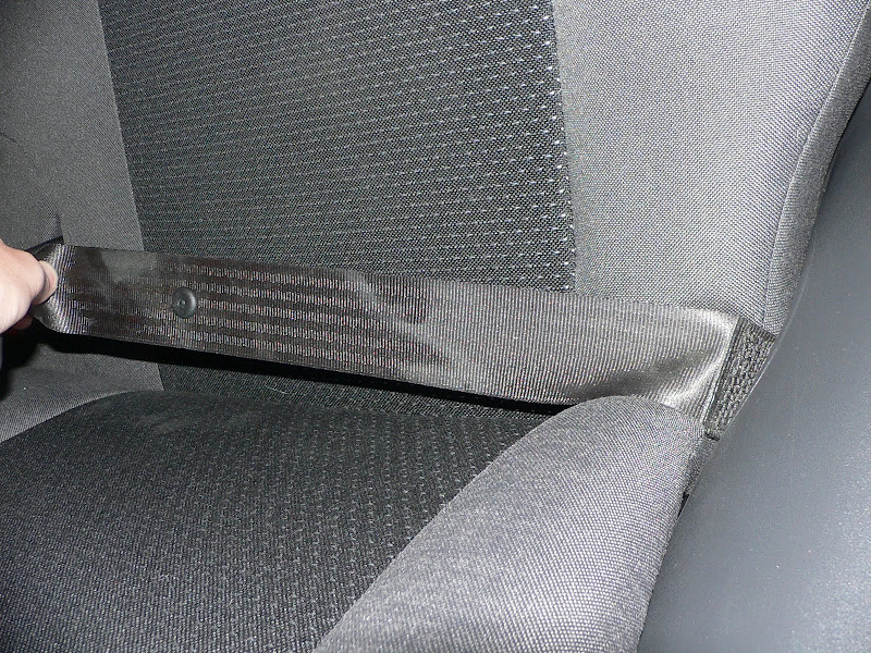

Oh look. Overspray on the seatbelt.
Overspray everywhere really, though this stuff should hoover out.

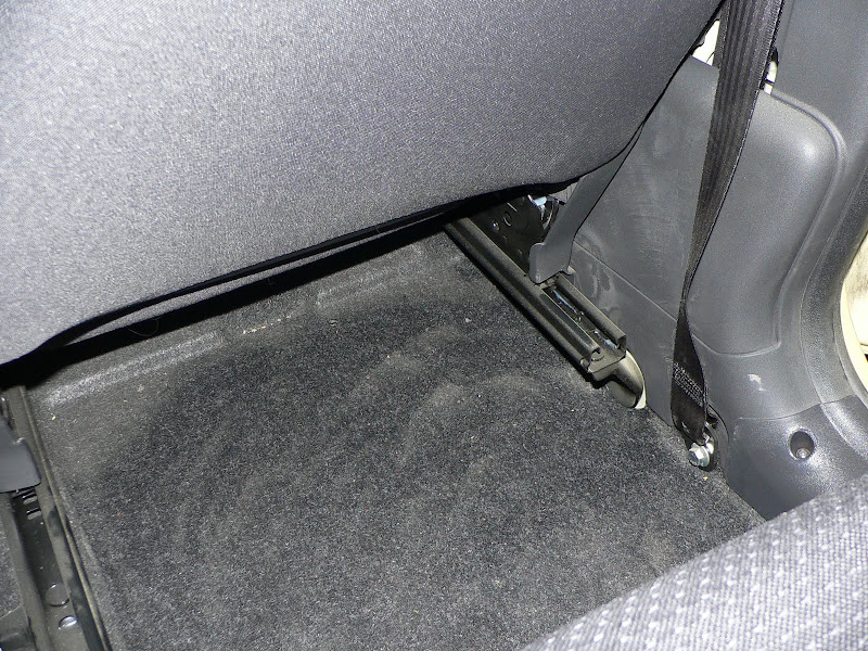

Underneath they seem to have done a reasonable job of replacing the boot floor, but it's very obviously not original.

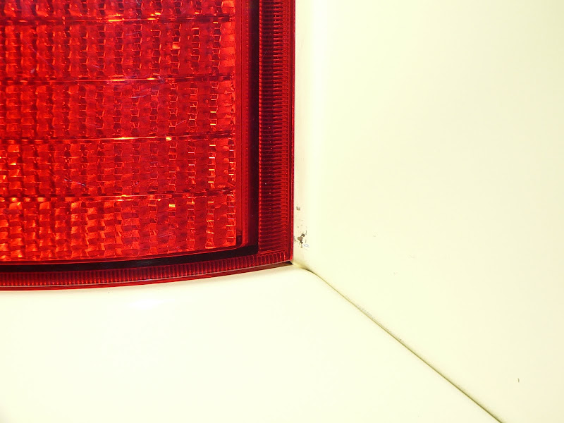

Paint chip where rear light has hit the body. They missed that.

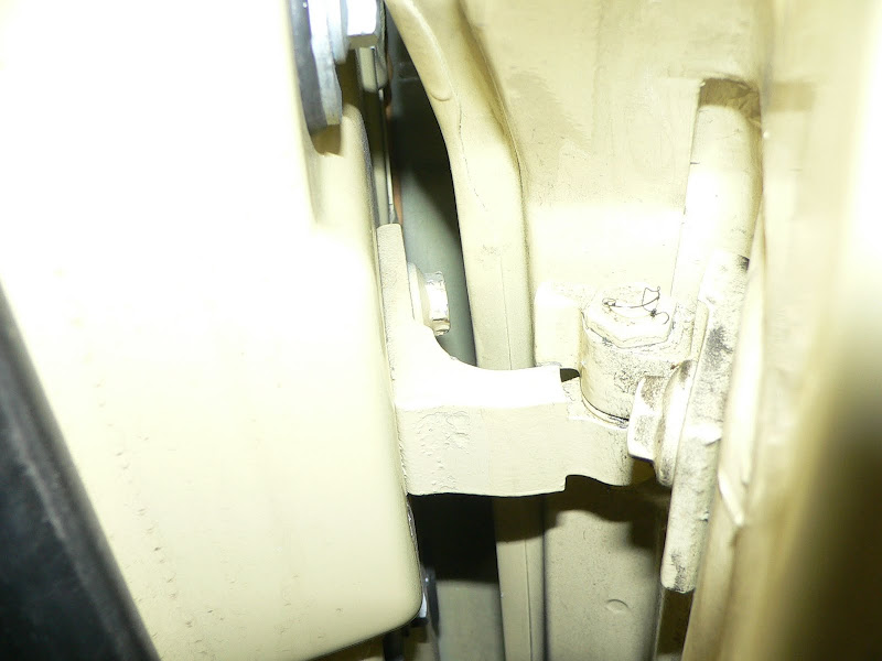

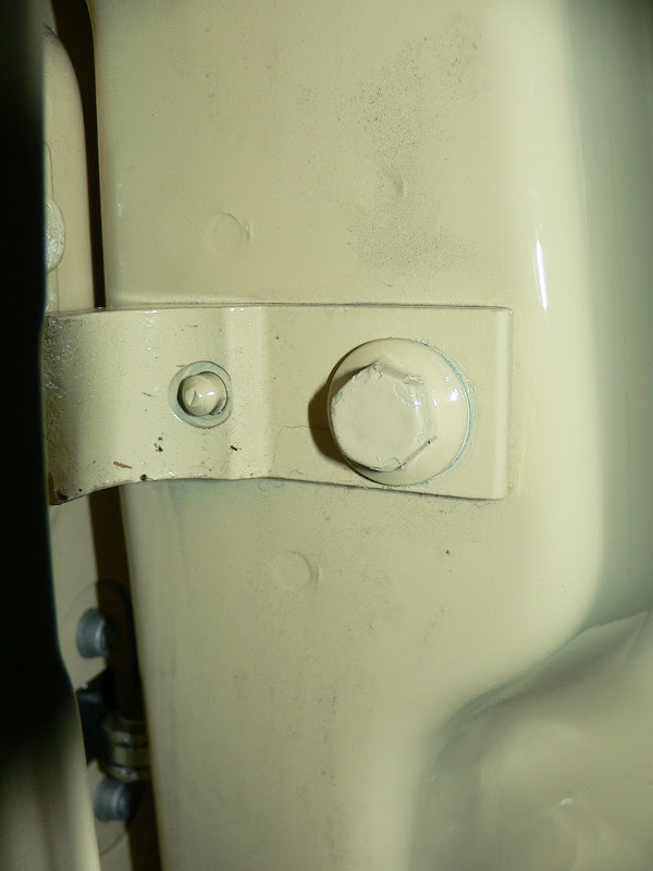

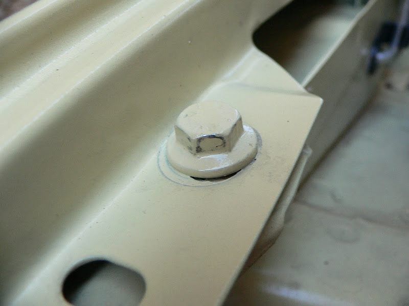

Looking at the drivers door hinge bolts you can just see the chips where they've adjusted it.
On the hinges for the rear door which are more visible, you can see where they've painted the bolts to try and hide what they did.

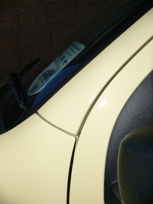

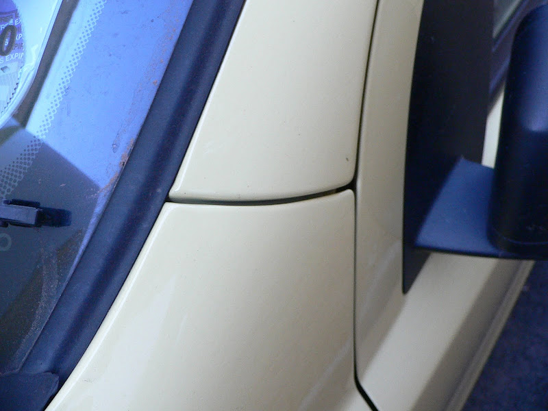

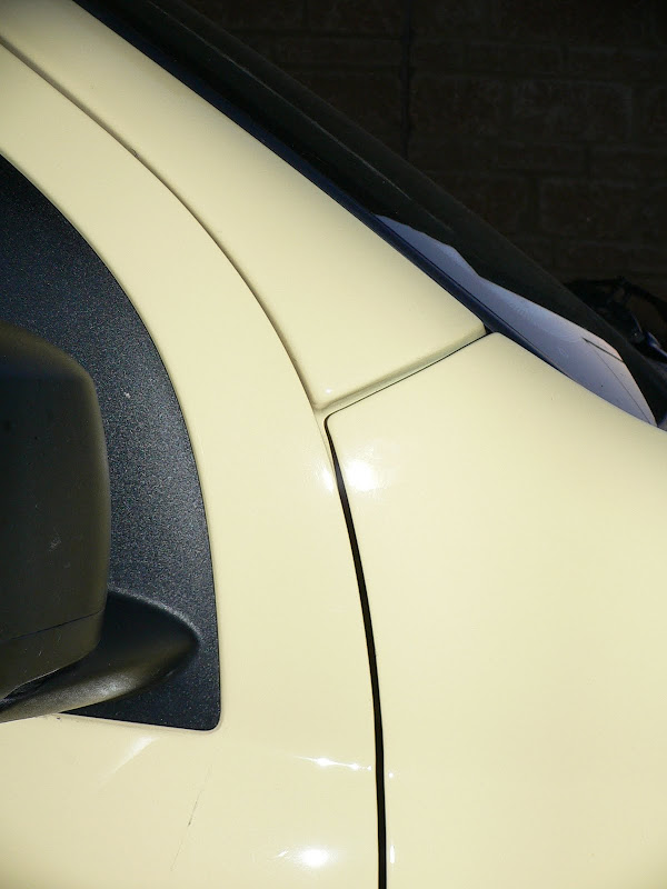

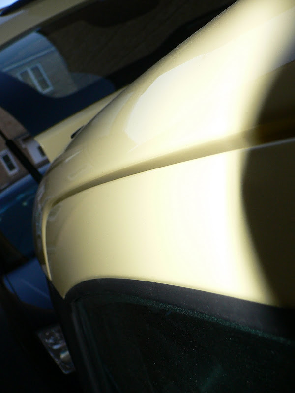

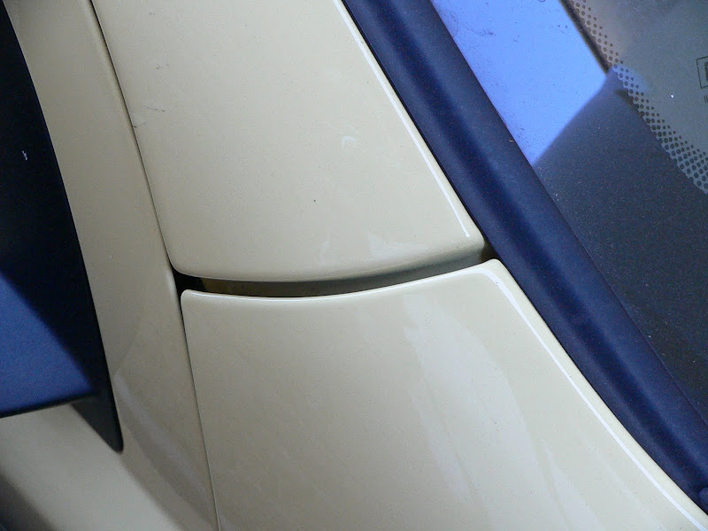

See the gap between the A pillar and the top of the wing on the drivers side.
And the same gap on the passenger side.
Mmmmm, Different!

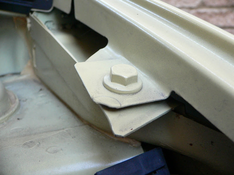

Let's open the bonnet shall we?
Looky. The bolts holding the wing on appear to have been spannered.
What are they like on the passenger side?
All nice and shiny.
So. As well as buggering about with the doors, they've gone so far as to unbolt the front wing and slide that along too!
None of which goes any way towards fixing the actual problem which is to do with the back end being shorter that it used to be.
