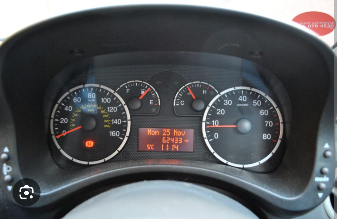

Take a short video of the dash
Switch the ignition on
Then crank the engine
I want to see the behaviour of the engine check light, battery, oil, rev counter

Morning.
Video as requested :)
Rick
Everything looking good here
Body and dash and ECU all talking to each other, canbus between the three is also working for the rpm to display correctly
around 300 rpm is correct
Display not dimming or clock resetting
Earth and battery all look good
Not the normal 100hp display, usually 3 line and a white outer edge
Ah yes, my daughter swapped that out a couple of years ago - can't recall why.
Rick
