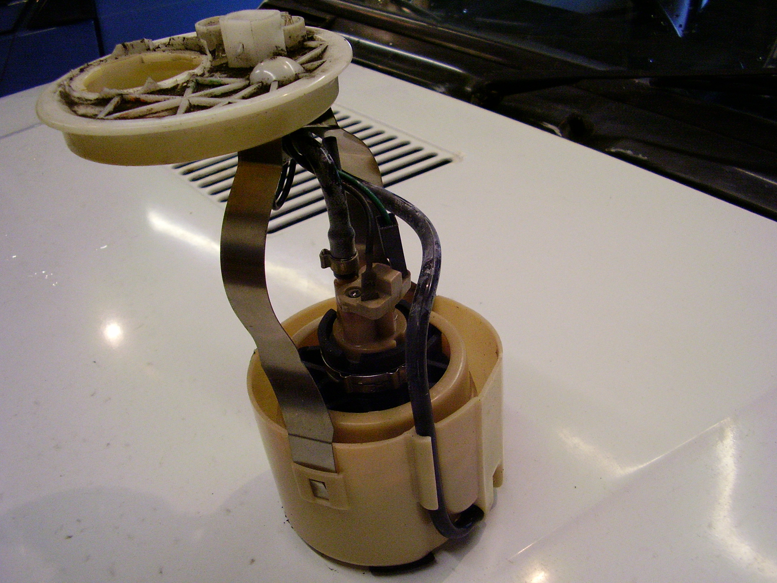

). Lift out pump unit. You should be looking at something like this:
If you buy a new pump I think this is what you get. However if you have a spare pump, the brown bit in the centre, you can swop just that bit over (as you have to if uprating the pump for mpi).
