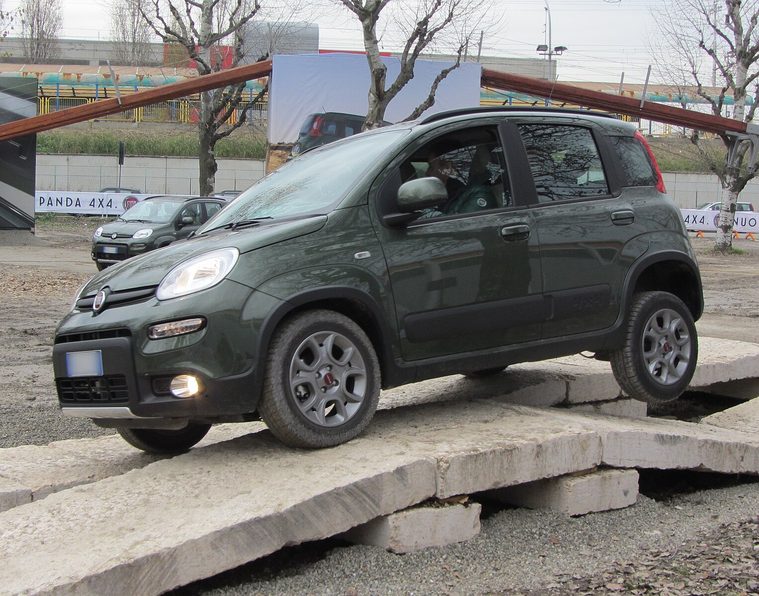

Worth noting that ELD is separate to 4 wheel drive, and I don’t believe is the cause of your issue. Confusingly Fiat label the switch ELD, but that’s not its main function, (which is to force 4WD. Pressing it also changes the throttle map and turns off parts of the traction control/ESC system)
The ELD is something different. It doesn’t lock any differentials at all (despite its name!). Instead, if the button/rotary control is set to let it operate, it allows the ABS sensors to detect if one wheel on ‘an axle’ is stationary and the other spinning (typically if one rear wheel comes up off the ground on rough terrain it will spin freely and the wheel on the ground stops getting power, owing to the way differentials work). The system applies the brake to the spinning wheel, which simulates the effect of locking the diff and allows the other wheel to be powered.
That is demonstrated in tests like this one, where without ELD drive to the rear wheels would effectively be lost
It doesn’t lock any differentials between front and rear either (in the way a pre 2016 Defender does) — because there is no centre differential there. Hence the risk of wind-up. (This is true of many larger 4x4s too, eg the Nissan Navara, or the Isuzu D-Max - both of which are normally 2 wheel drive and have a 4WD system that should only be used off road owing to the lack of a central differential)
