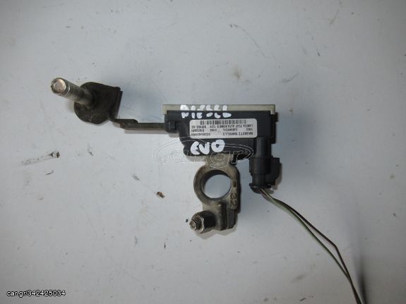

There is a Neutral position sensor on one of the shifter cables, below the gear lever. It tells the Body computer when gear is in neutral, so it enables start-stop. This sensor needs calibration by Fiat Examiner or MES, if the battery or the ECU is disconnected. Your mechanic might disconnected the negative terminal and also damaged the cables leading to the battery node on the negative pole. Finally, i would check the condition of the ground on the other end of the negative terminal, it's right below the battery and might is corroded...

I've cleaned my ground points and my mechanic has also done that, and has inspected the negative terminal wire, said they're fine.
