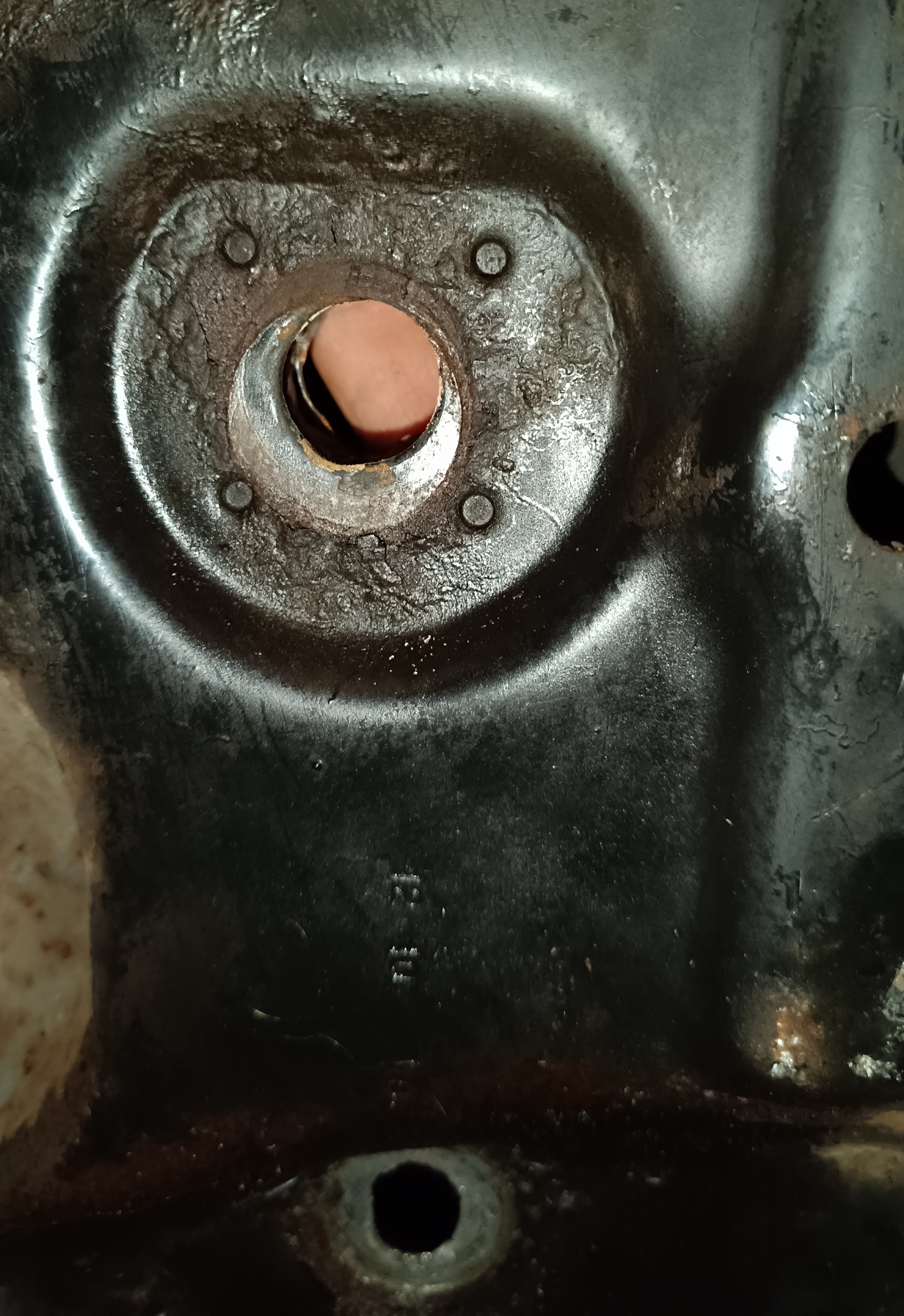

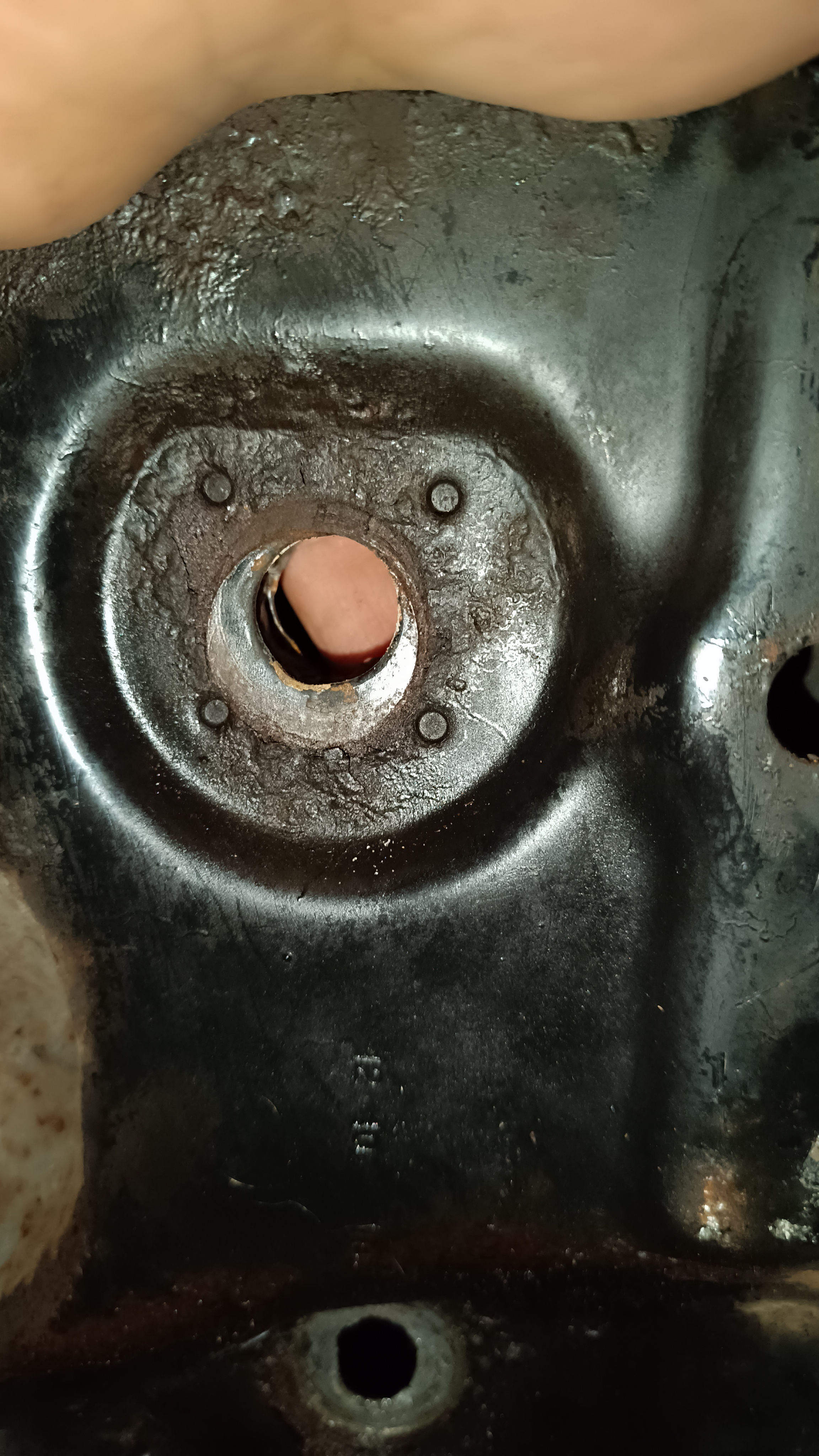

So anyway the car used to have 6 aluminium seating plugs, see the first picture. One was still on the subframe so i assumed the others were still on the car...but they aren't. The subframe has been off in the past and the mechanic only put one seating plug back and just bolted it up quickly any old way, see the second picture. This misalignment then led to the subframe failing.

Fiat dealer for this one I’d suggest, I suspect they may well know the part number off by heart.
I was meaning alignment when the bolts were in, not just getting the bolts in. Some cars are sensitive to that as millimetres will affect the alignment of wheels and handling, which can be negated by tracking to help.
