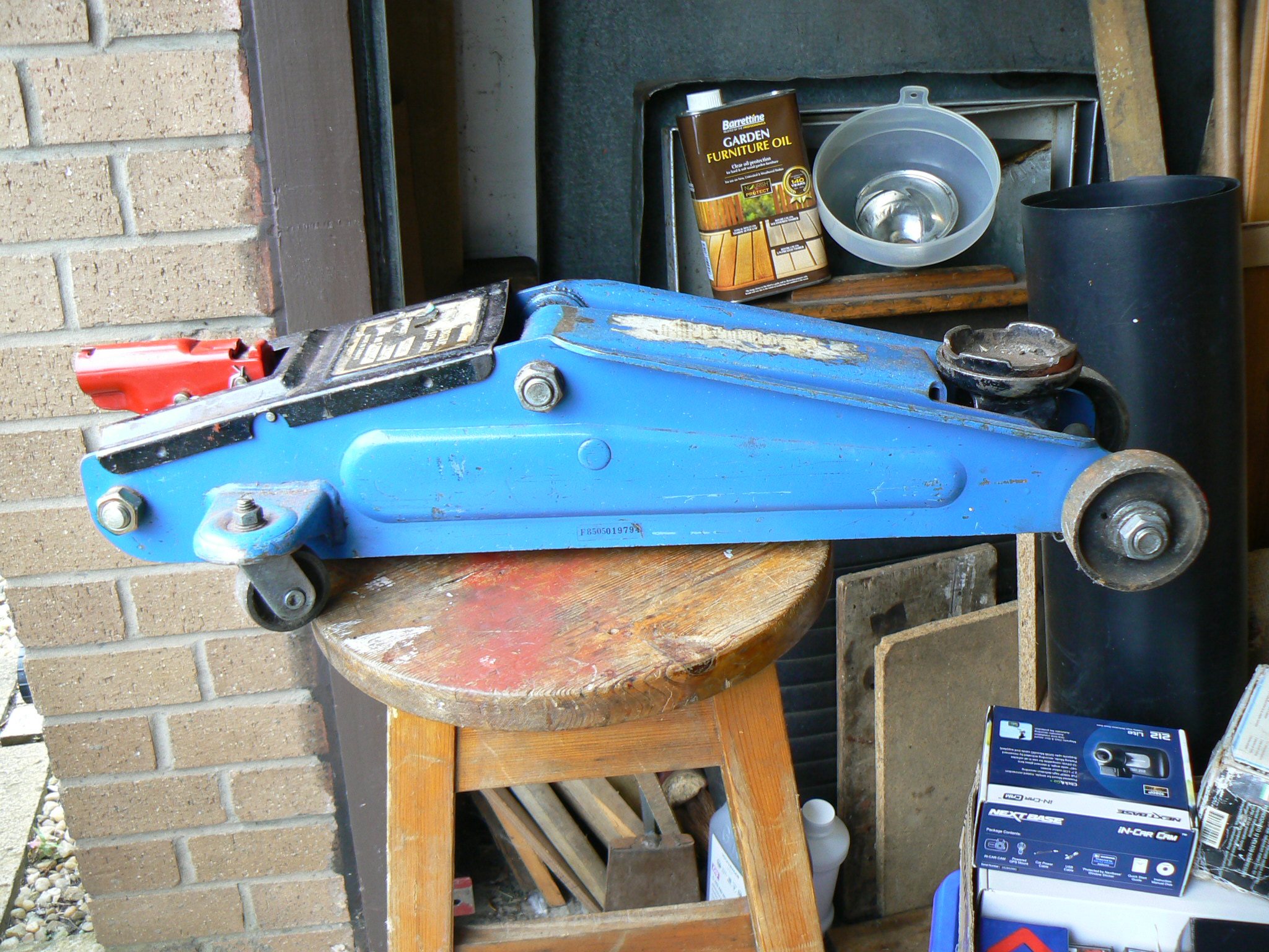

Anyway, not long after getting the new jack home I thought "Oh dear, that looks like it's got a higher saddle than the old Hilka":
And whilst the wheels are bigger the saddles are in fact the same height at rest so it's not a problem. (some of the levers are sticking out the bottom because the pumping element was removed before I took this picture)I then noticed the saddle on the Sealey is slightly smaller in diameter so marginally less stable a platform for a sill puck etc.:

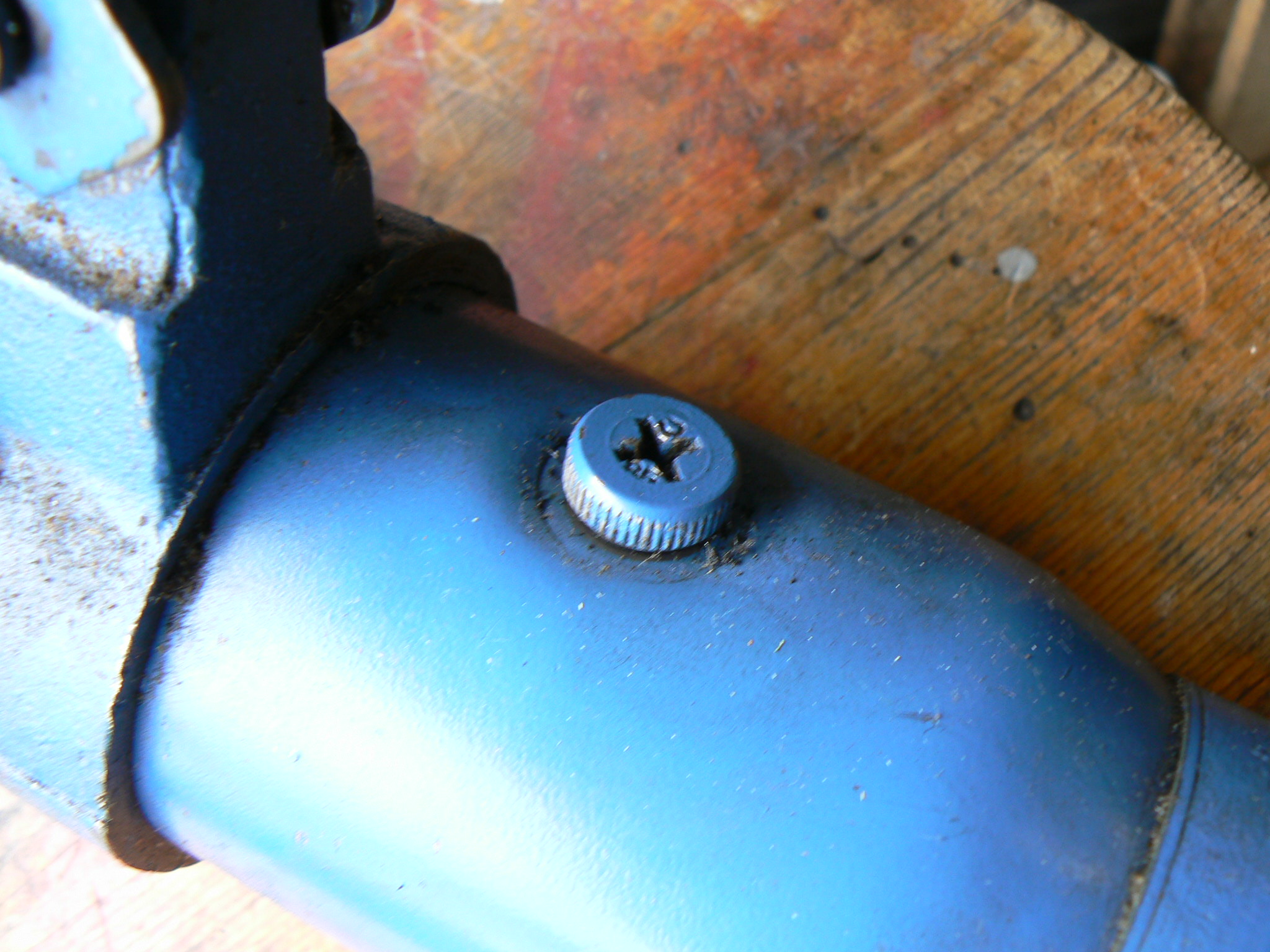

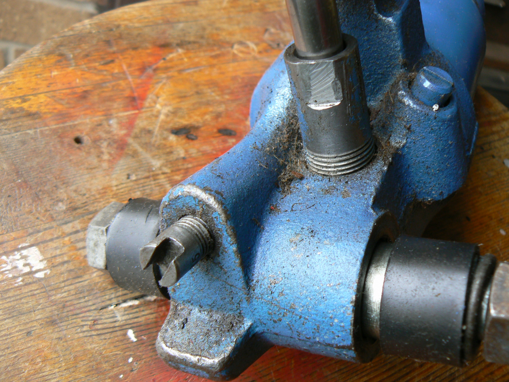

And the release valve now has a flattened end rather than a slot and it looks like it's formed simply by stamping it flat in a press rather than it being a machine operation? I've also seen the slotted type with the lugs snapped off. By the way, if you have one of these - of either type - don't be tempted to over tighten them. Damage it in any way and you'll regret it as spares don't seem to be readily available. Doesn't need any more than "nipped up" anyway.

The plunger body looks a little different too, maybe they've modified it to make it last longer than the old type?
The change in the release valve has probably made the lever cheaper to produce too as all they have to do now is squash the end of the tubular handle:

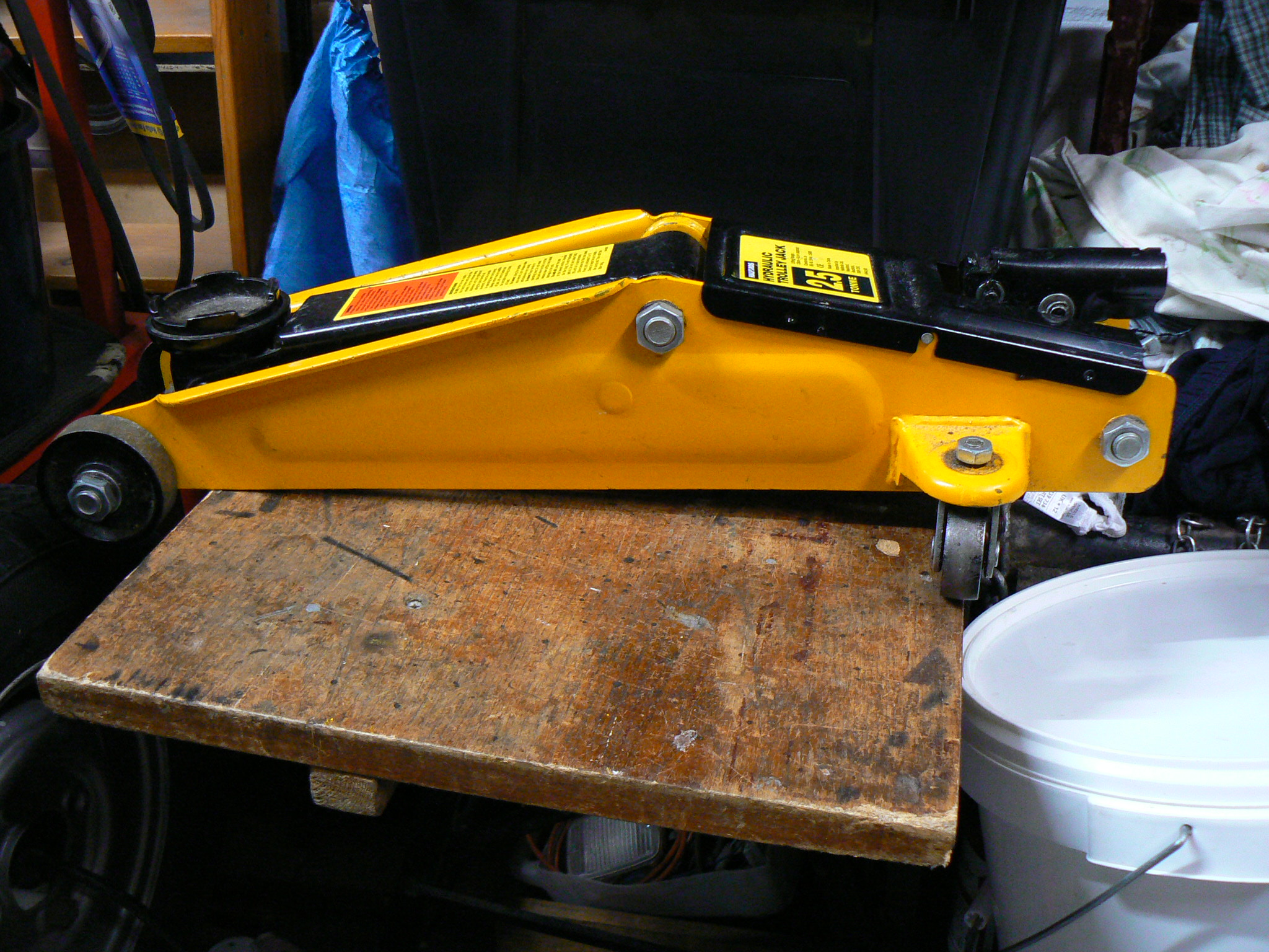

So, my conclusion is that these are actually quite good jacks and I was ever so pleased when a neighbour who lives up the road arrived on my door shortly before they moved away and said would you like this:
Hang on though, doesn't it look very familiar? Hell yes, It's a yellow version of my old friend the Hilka:
Branded Halfords though - still made in China just like the Hilka - Happy days. Would I like it? I almost bit his hand off!

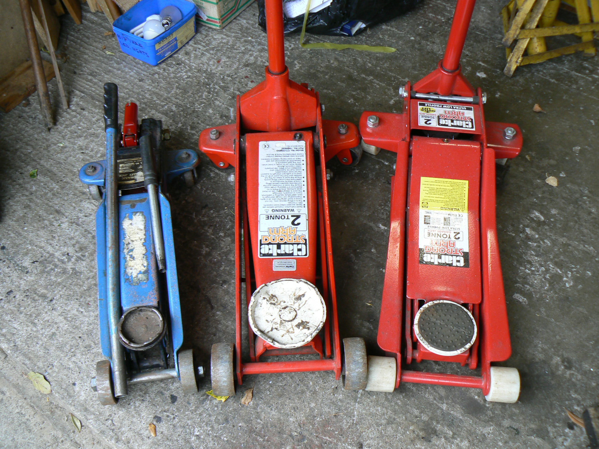

Ok, lets try to rationalize some of my thoughts here. First off, if you can afford a more professional jack then definitely go for it. Here's my two big "every day" jacks with the wee Hilka to their left:
They are much more robustly built - intended for everyday workshop use of course - and much wider so more stable but I'd still NEVER go under a vehicle supported just on a jack no matter how well made/expensive. However they do cost. The other advantage is that quality bits of kit like this generally have spares available - like seals etc - and I find Machine Mart, who sell the Clarke branded stuff, give good support.

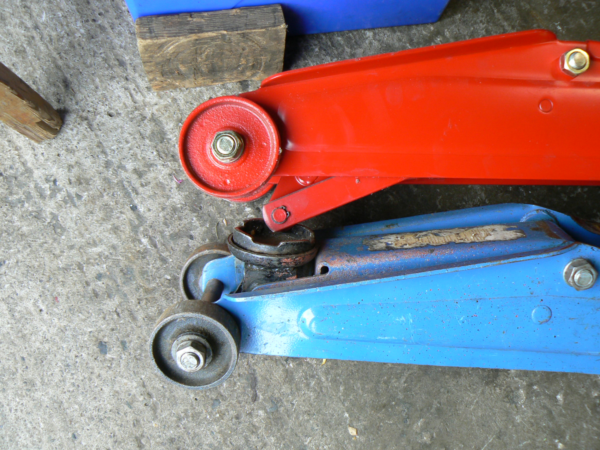

The big thing is how much usable lift they give - the important word being "usable" here. This is really down to the length of the lifting arm - by which I mean the distance from the pivot point in front of the operating lever to the middle of the saddle. A short arm can't give a big range of lift - simple as. Some manufacturers advertise "high lift" on these wee jacks but when you look at them the saddle is well above the end of the lifting arm when at rest so the resting height is too high to get under lower vehicles. My wee Hilka has a lifting arm length of 10.5 ins (265mm approx) and a resting height saddle, to ground, of 5" (125mm approx) which means it'll go under anything with 5" ground clearance and jack it up to, a slightly unstable, 17.5" (445mm approx) - these are all actual dimentions taken with my tape measure. I've found this to be very adequate for most common maintenance tasks like brakes, track rod ends, oil changes and checking gearbox oil level, all this sort of stuff. Lets me get the axle stands under easily.
If you look at the big jacks in the last picture above you can see how much wider the wheels are, so they are much more stable and also how much longer the lifting arms are so they can lift higher. The middle jack can lift to 19.25" (485mm aprox) and the low entry jobbie goes to around 20" or 551mm. You can see how it's lifting arm is longer in the picture.
