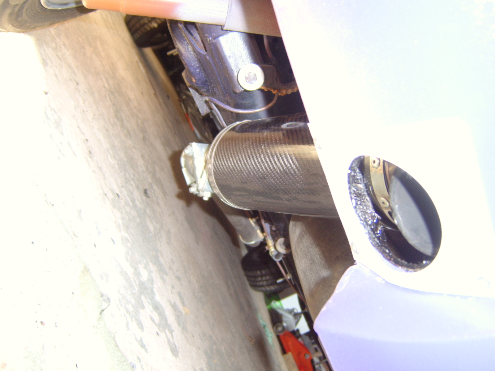

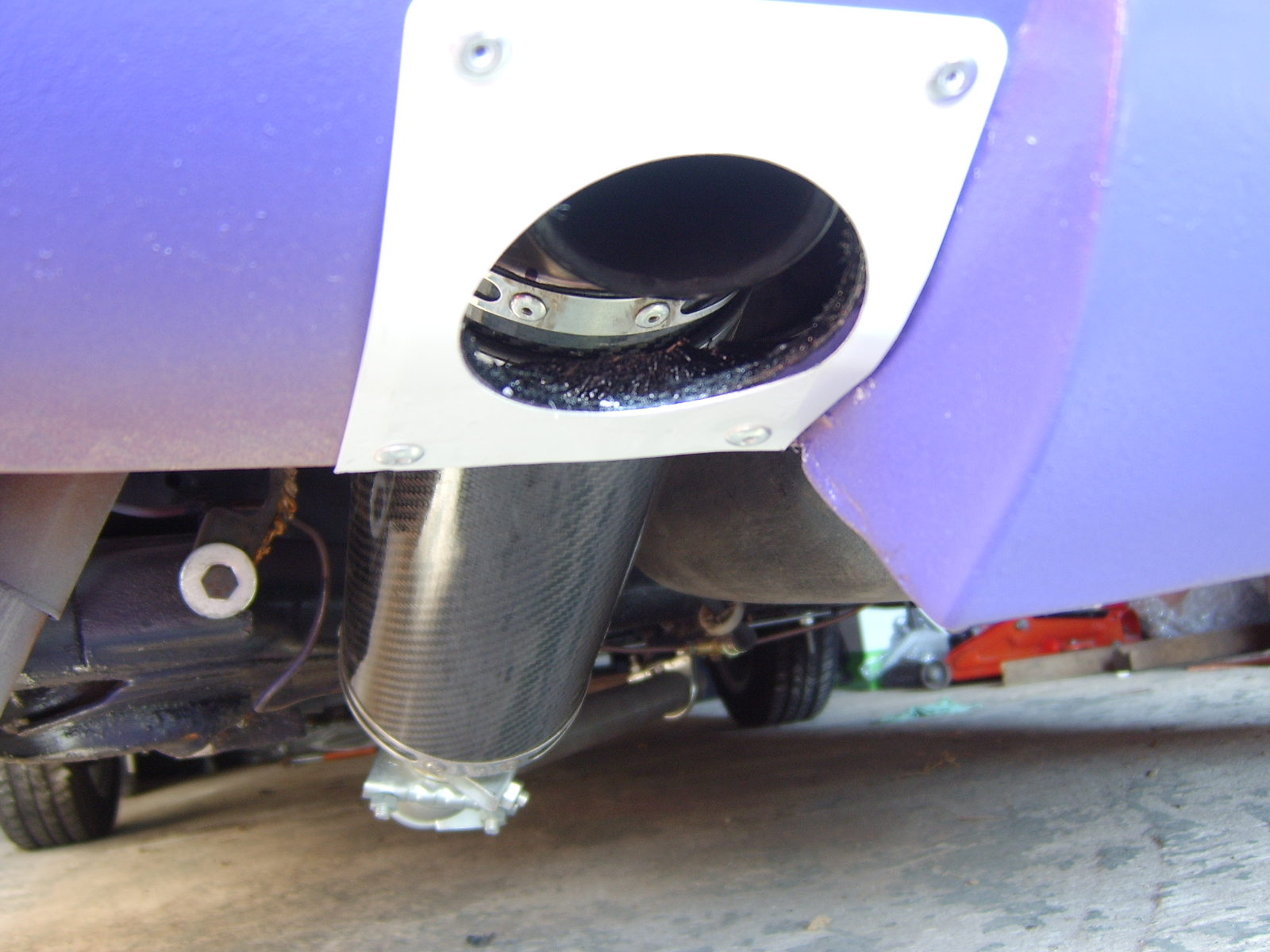

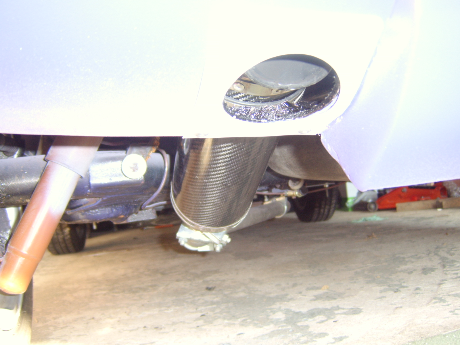

Well set about raising the end can, seeing as its carbon fibre, i shortened it, re packed it with propper gause but struggling to refit it now, need to weld a hanger on body to hold the exhaust, weld another hanger for the can and line it all up, doesnt sound much but its tricky in a confined space....hope can get it done during the week....
fitted new MAP sensor, checked the pipe for blockage(clear) but not started it yet...
will let ya know how it goes...
kevin
yes i know(learnt the hard way lol).
i have a non combustable tea towel sized mat i use so that will be going round the plastic fuel tank....
mind you i will only be welding on a L bracket with a hole in it so i can bolt to it....nothing major, just a bit confined under the axle stands.
will take a pickie...when done before its back on the wheels.
