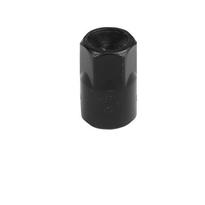

Is this what you mean of a male hex

Mate it should be a hex socket, had a look and I think its diesels and maybe HGTs that can have a bolt with washer. We have a 98 Mk1 1.2 8v and a 2005 1.2 8V and both have sump plugs whith a female hex socket. Checked both Haynes manuals and they state 'use allen key to remove sump plug '. The one I have is a double ended gizmo (12mm one end and10mm the other I think) that fits in a 19mm spanner or socket.
