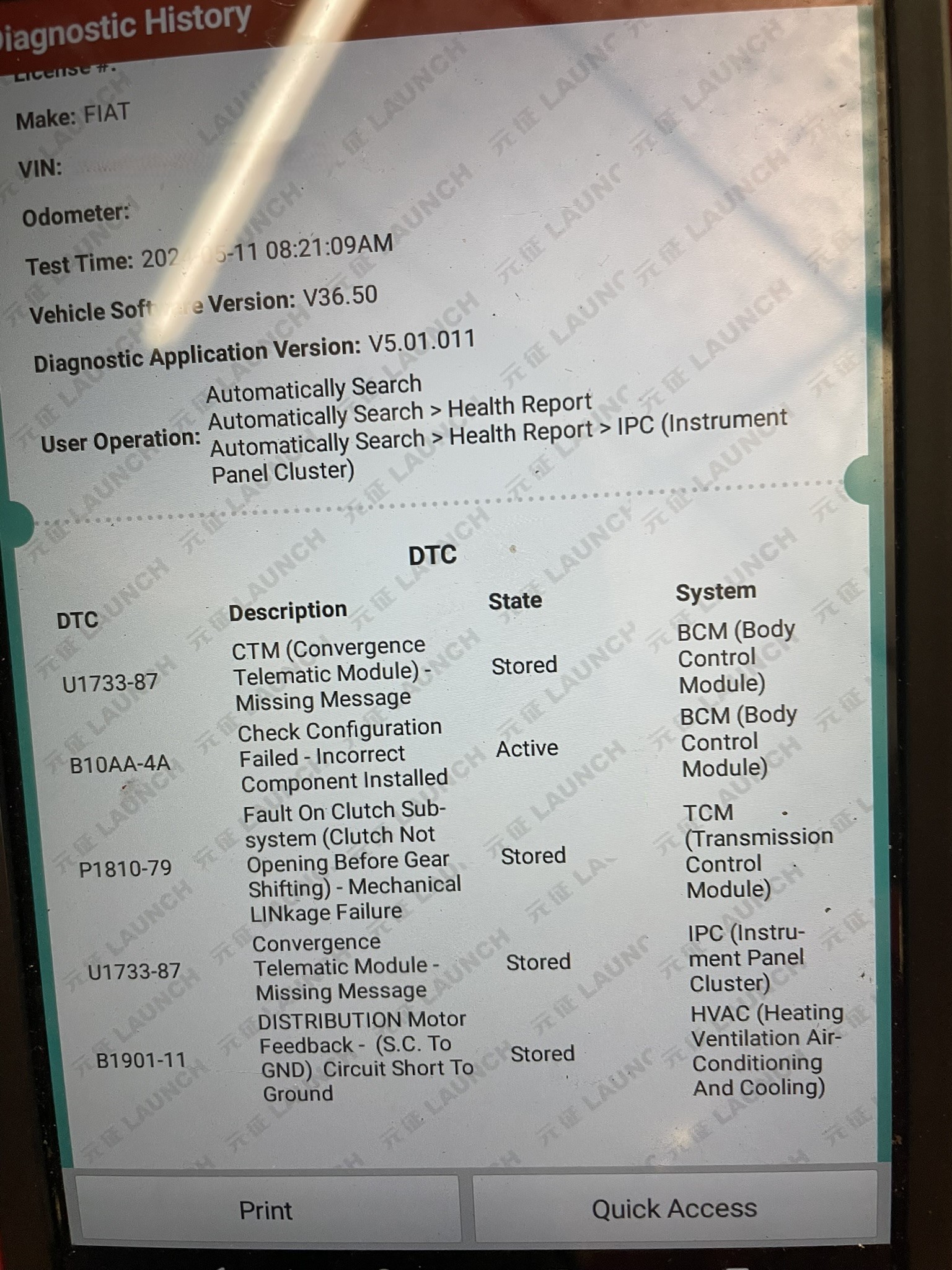

Hi again,
So I got a diagnostic test done today from a nearby garage and below is report:
I understand first two entries indicate the faulty B&M node for which I need to go with Option 1 (i.e., repair, reinstall and Proxy), but curious about the third one i.e. P1810-79. Is it related to the faulty B&M by any chance or something else I also need to worry about?
FYI - No issues with the auto-transmission or engine lights / messages when I drive the car.
Thanks,
Ray
surely stored means stored code? in which case it could have been there for years?
I guess so - never seen a manifestation of this 'stored' code on the instrument cluster warning me about anything ever since I started driving this car (from last year) - mechanically, auto-gear shifting works normally...
