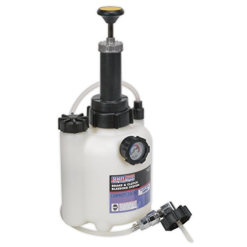

FYI: disappointed with the Eezibleed kit - the valve on the top of the pressure vessel/container is sh*t. For example: the slot on the screw head to regulate the pressure to the fluid reservoir with a screwdriver is extremely shallow (it's obviously been etched on with a very low powered laser from 300 miles away - that's 480 km for our soon to be divorced EU comrades) meaning even a very thin screwdriver blade slips out of the slot, and control of pressure with this valve is a mystery to me. On my previous version which I'd only used twice, the head of the regulator screw sheared off!
However a little research came up with a potentially much better model with good reviews. If it's less than an hour of dodgy garage labour, I might invest:
Sealey VS820 Brake & Clutch Bleeding System
173 reviews, 4.5 stars on Amazon.
£43.25 & FREE Delivery in the UK (05/03/2018).
If anyone has a definitive location for the second bleed nipple, other than "It's somewhere in the engine bay area...", I am interested.

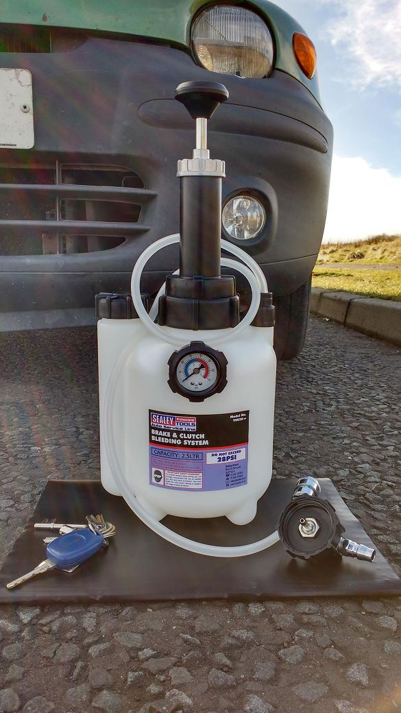

I've splashed out on the Sealey VS820 Brake & Clutch Bleeding System (see pic).
Haven't used it for real yet but on first inspection it looks the canine's cohones. Much higher build quality than the £20 Sealey bleeder.
I have tested pumping up the pressure - it took 100 pumps over 85 seconds to get to 20 psi which is more than enough to bleed the clutch.
Advantages:
- Solid high quality build (garage quality?)
- No spare tyre needed, so only one connection needed - to car fluid reservoir
- Proper high quality push fit air connector to connect to high quality reservoir cap adapter
- Pressure gauge incorporated
- Supplied 42mm reservoir cap fits the Multipla (big bonus)
- No crap needle valve to stick on you
- 2.5L fluid reservoir
Disadvantages
- At least twice the cost of the cheaper Sealey bleeder
- It's big!
- Nothing else
My clutch is still OK after bleeding the other day, just a little sticky, so I think I'll test the new bleeder for real next week to see if I can get any improvement.

With pressure bleeder on reservoir and flowing the spanner fell off the 8mm nipple and fluid went everywhere ... naughty word naughty word.
Air in system ... much worse, pedal not coming back.
