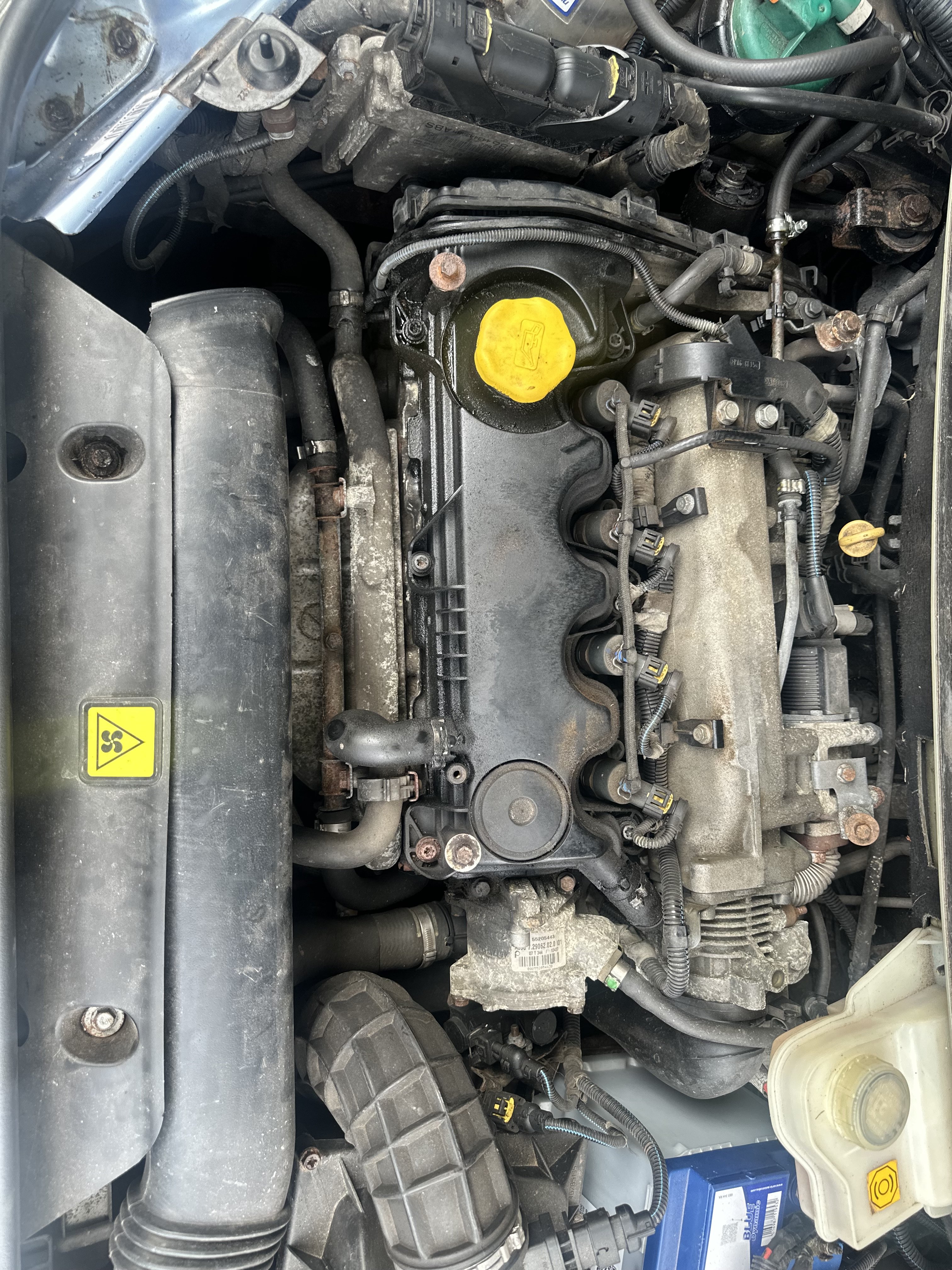

Your multipla 2008 - post photo of engine

If your photo in post #4 is real then it's JTDm 120 but engine code must be 186a9000.
