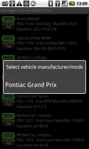

with torque Pro have you loaded the manufactures extended PID's (eobd)
I don't use torque Pro. but this screenshot might point in the right direction
You are right.
But, sadly, I dont have any of them (nither the mixture correction nor the fra and dtv).
