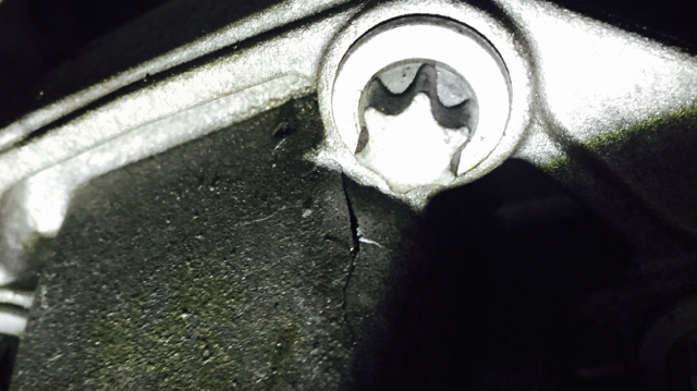

So 3 months after my gearbox repair, this happened:
Halifax gearbox & clutch were not helpful on the phone when I spoke to them, apparently the warranty they supply only covers the bearings and nothing else. So if the damage was caused by anything else I would have to pay them more money, which I did not want to do due to their unhelpful attitude. The saying "buy cheap pay twice" springs to mind.
So decided to get it repaired properly at my local garage who I really trust but knew this would be expensive as they send all gearbox repairs to a specialist, but means the entire gearbox will have a 12 month/40k warranty. And as the gearbox is off makes sense to replace the clutch/DMF/Slave cylinder.
Still waiting to get my car back, but have been told that 2nd gear lost a tooth which is what made the hole in the casing. I really hope this is the last of my gearbox problems!
