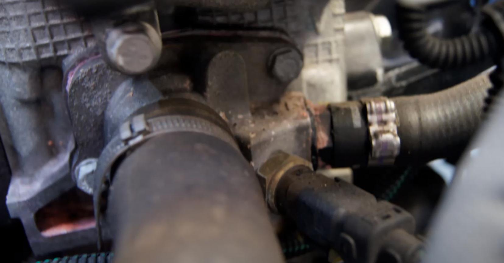

If you've had the cambelt done they should of put a new water pump on it at the same time, it's a general rule of thumb as the water pump runs of the cambelt. I take it it's a 1.2, there are 2 areas on this engine I would check,
1) Thermostat housing:
These are notoriously common on the 1.2, where the coolant hose connects to the housing the outlet on the housing is plastic, if in good order it should be dead clean with no anti freeze residue.
The picture above if you look closely there is a pink residue around the housing & hose, this is the 1st warning sign of a faulty housing, following the residue it starts leaking onto the gearbox then eventually collapsing where the plastic outlet has become so brittle which would also lead to instant head gasket failure if not switched off in time, this is one of the very few parts where aftermarket alternative is much better as they have a metal end instead of plastic, they are usually around £20-£30 from a motor factors with a new thermostat inside.

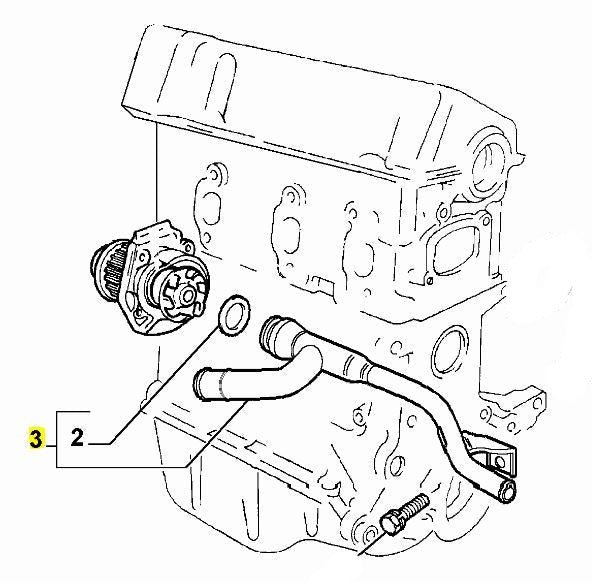

2) Steel coolant pipe:
Another common one on the 1.2 is this steel coolant pipe which goes across the front of the engine which connects near the water pump, these pipes corrode & start leaking, we've just changed the pipe on my dad's Punto 1.2 which is the same age as your Panda as that was starting to leak due to corrosion, the part came from Shop4Parts & had a much better seal than the original part, it was around £25-£30 with the forum discount
The picture above shows the offending pipe where it goes across front of the engine near the exhaust manifold, the end with the seal goes into the block by the water pump, getting the exhaust manifold heat shield off gives a little better access as this is what my dad did with the Punto

The water pump was done with the can belt. Already had the thermostat go and replaced. I tried looking for the steel pipe but can’t locate it, if it is they is it a easy fix?

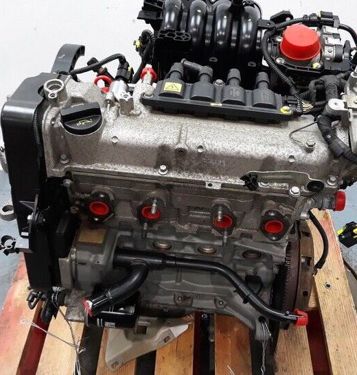

Here is a picture of the 1.2 FIRE engine as in your Panda, so this is the front of the engine as you'll see when you lift the bonnet, usually the exhaust manifold would be there, the steel coolant pipe is the black pipe in the picture which usually is behind the manifold. It is doable with the manifold in place it's just a little more fiddly
