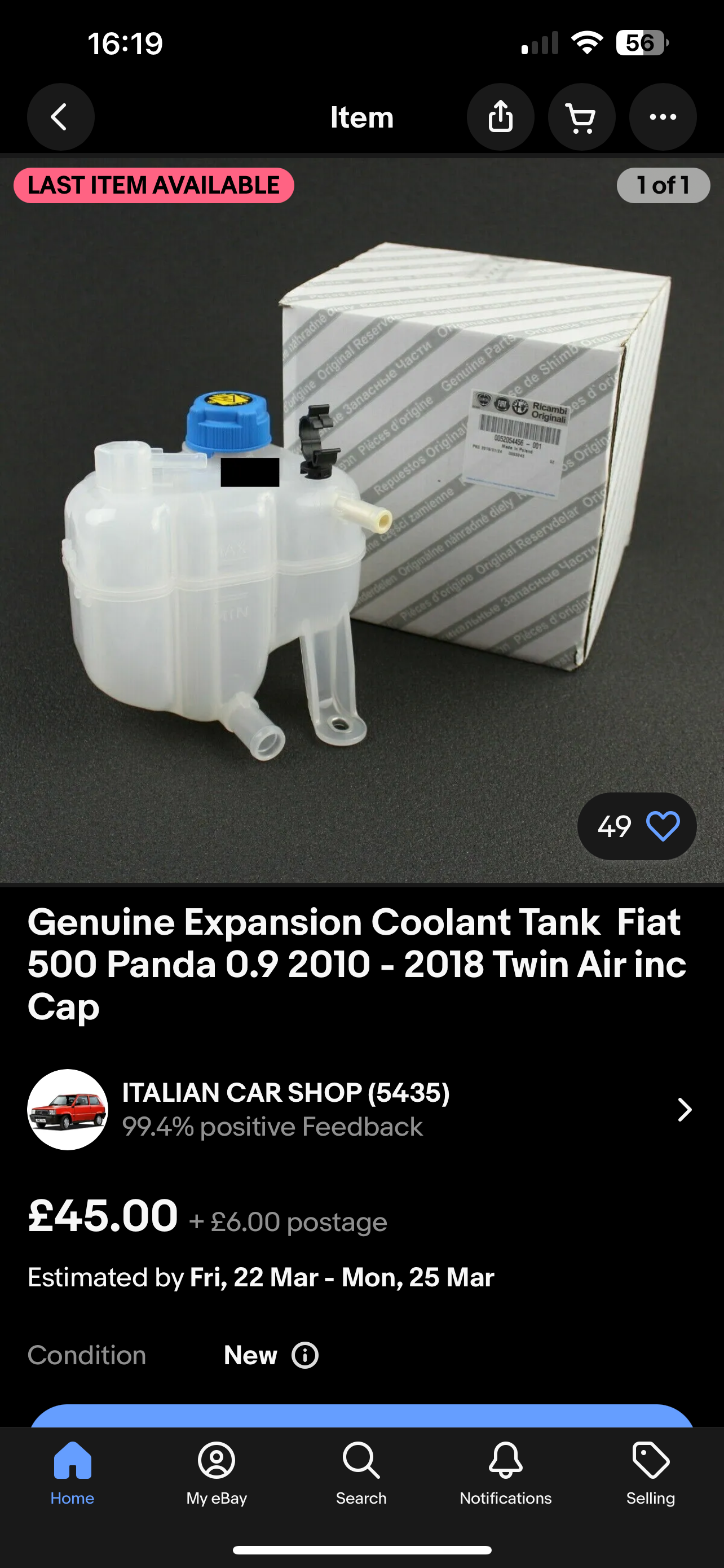

Hi my twin air was the same I just went to a local motor factors and bought the correct colour job done my TA was using a bit of water over a week so I bought a new genuine water bottle and cap off eBay done the trick never had to top it up again
