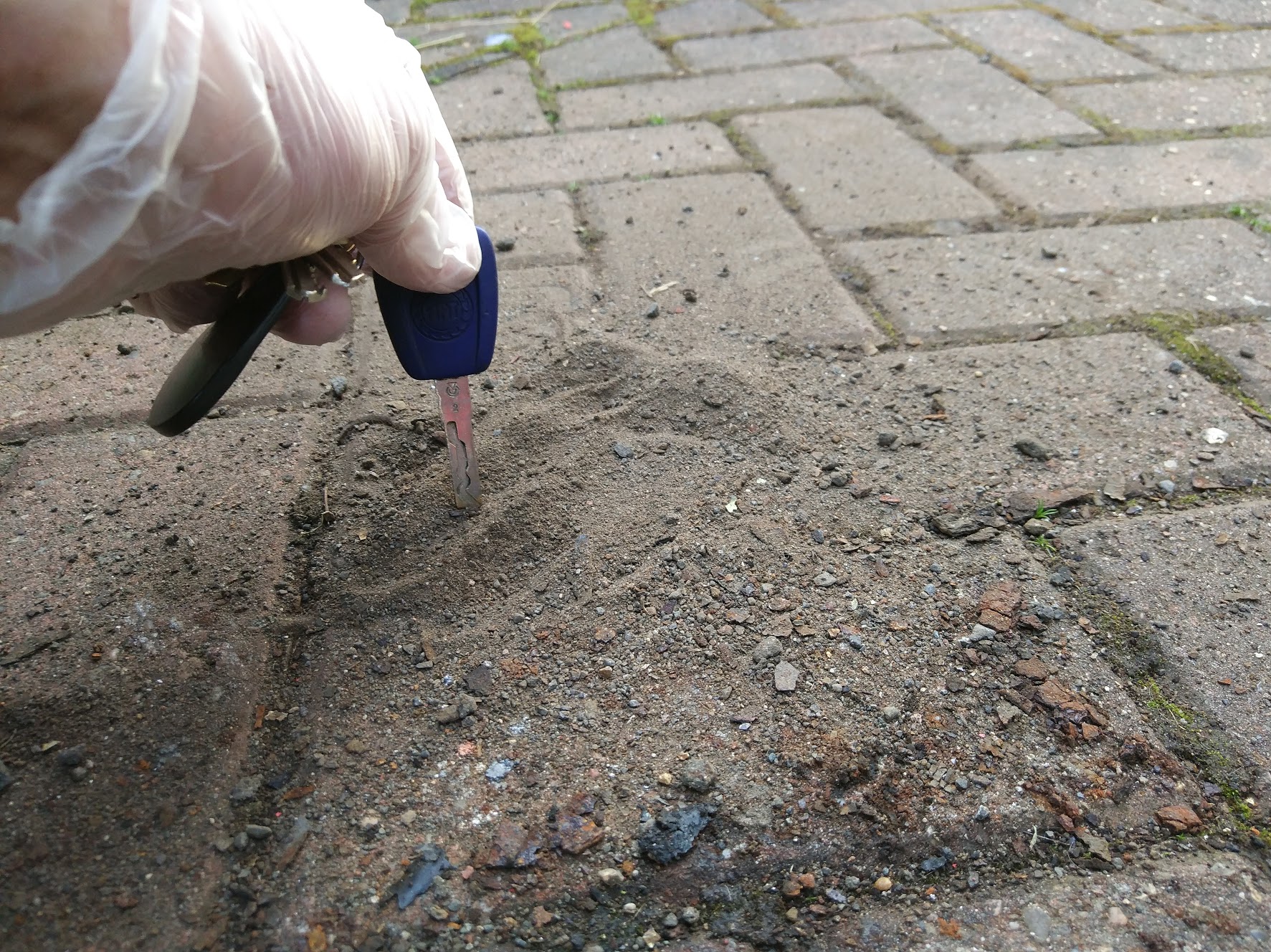

There is a mud trap just behind the front brake hose chassis bracket. Clean it out and slather the metal with chain saw oil. It will fill up again but the oil will soak and protect the structure.
Do the same with front subframe or anything else that's looking exposed.
And what a trap it is, I pulled a lot of soil out of that little space. Source of some surface rust as well.
