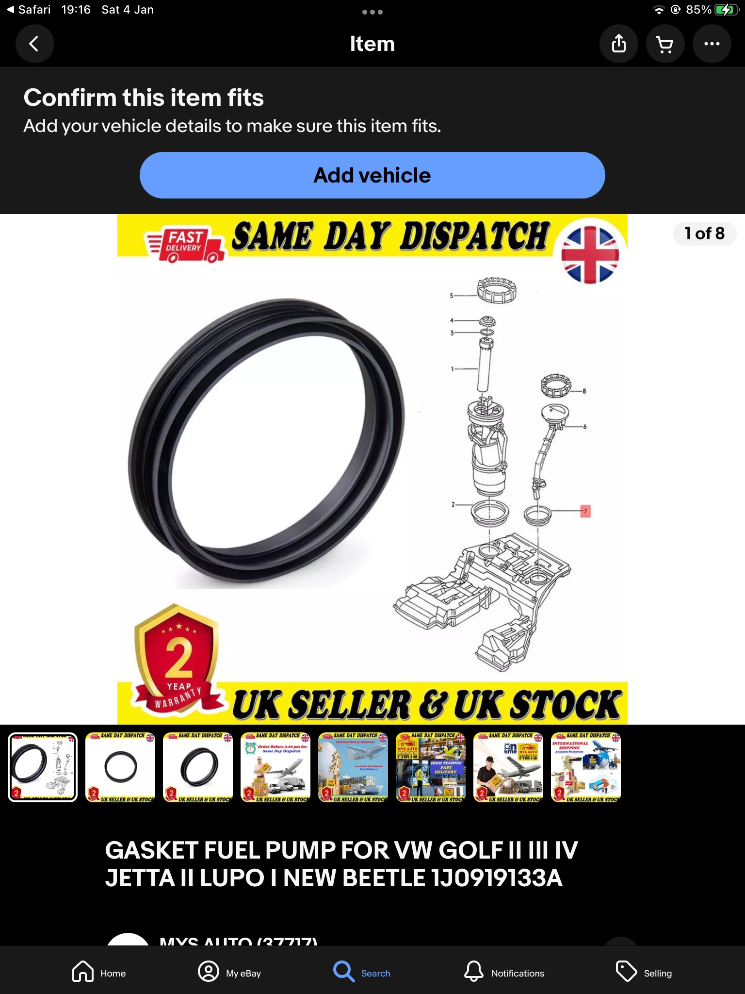

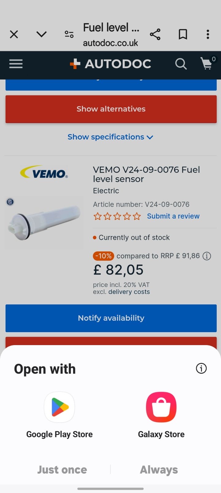

I have a Panda injection 1993 model. There is a leak and i found three parts i must change. Does anyone know a website / marketplace from where i can buy these items? Alternative if someone has these parts (new) to sell, i would be happy to buy directly.
- Tank seal where the petrol pump is attached
- Seal of the petrol level indicator between the indicator and the pump upper part
- Seal between the big nut and the pump
See attached photos for reference.
