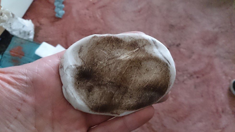

It was silly dirty!! checkout the clay bar, that's after only one panel!!
