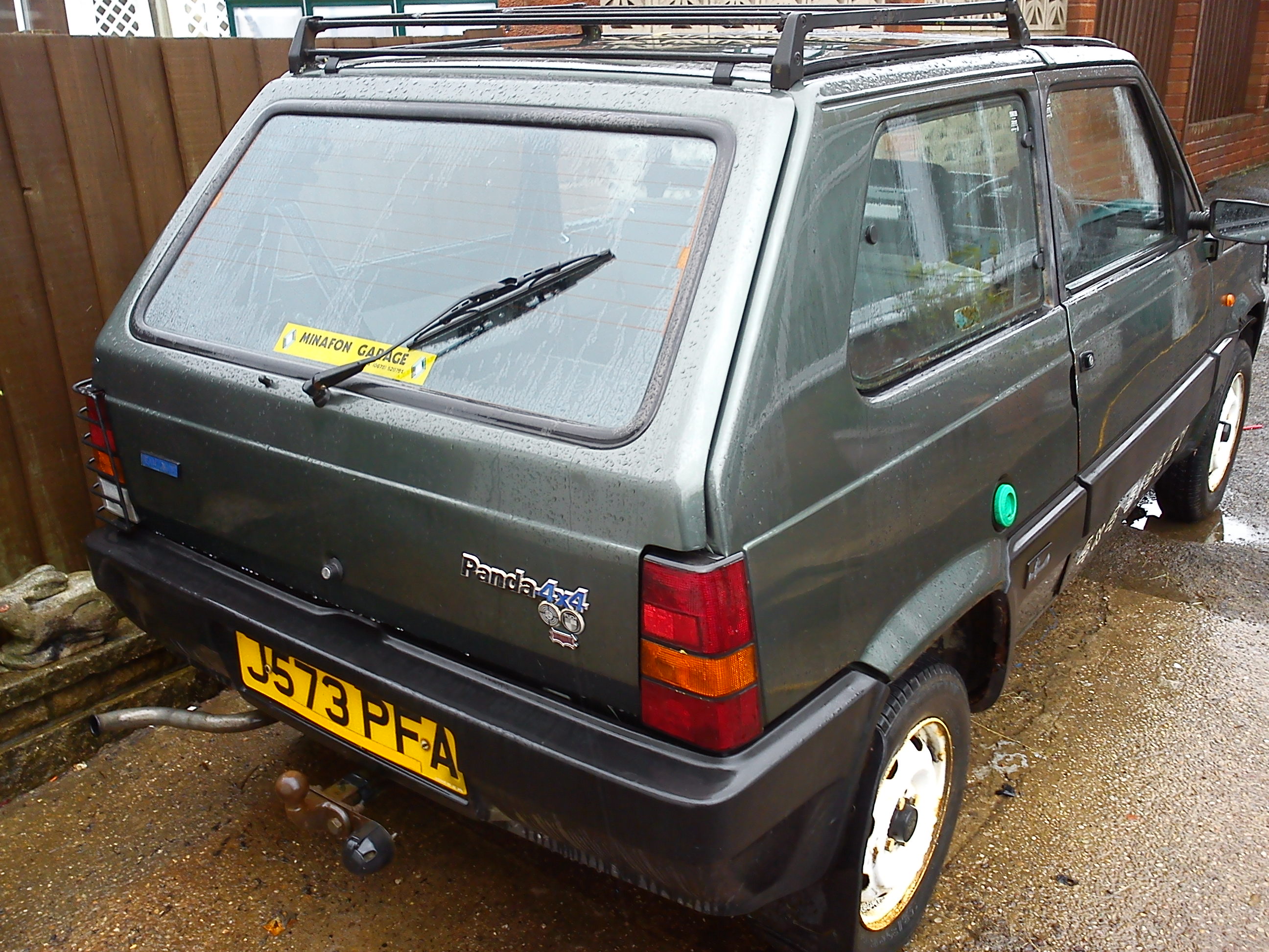

Edit: about half way through the time it took me to get the car on the road it found the name Talon. So everyone Meet:
Talon. My Fiat Panda 4x4 Sisley:

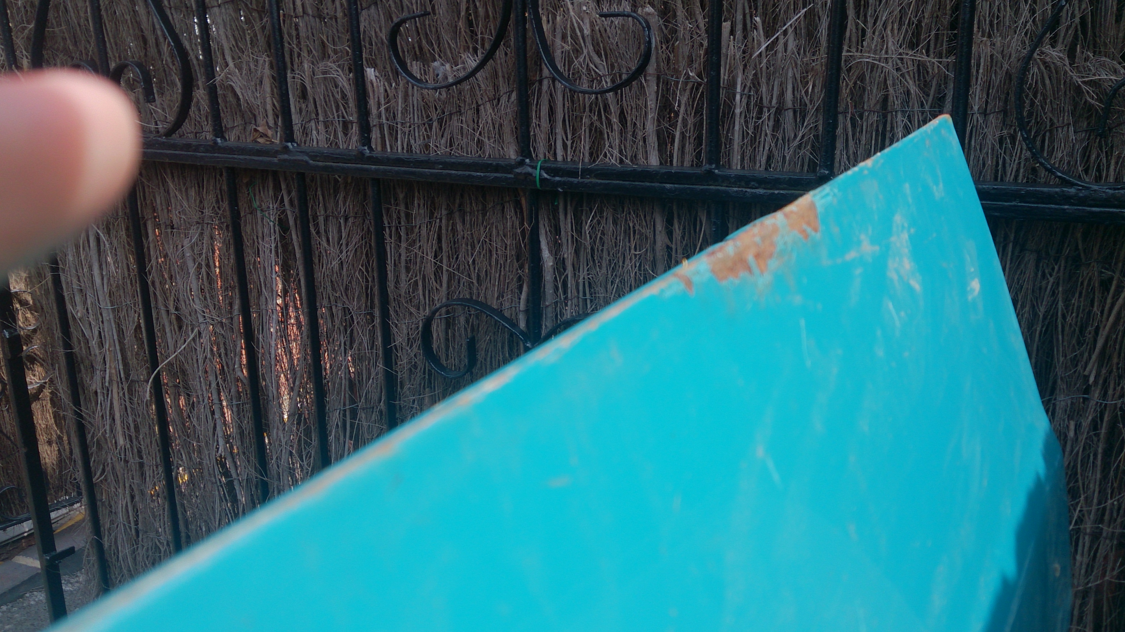

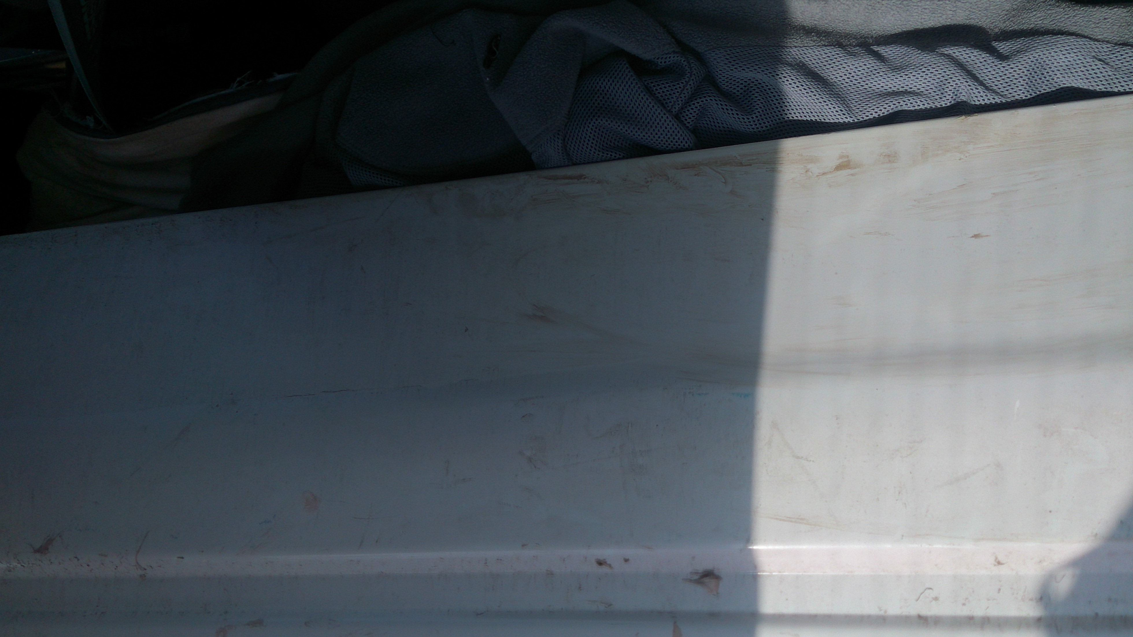

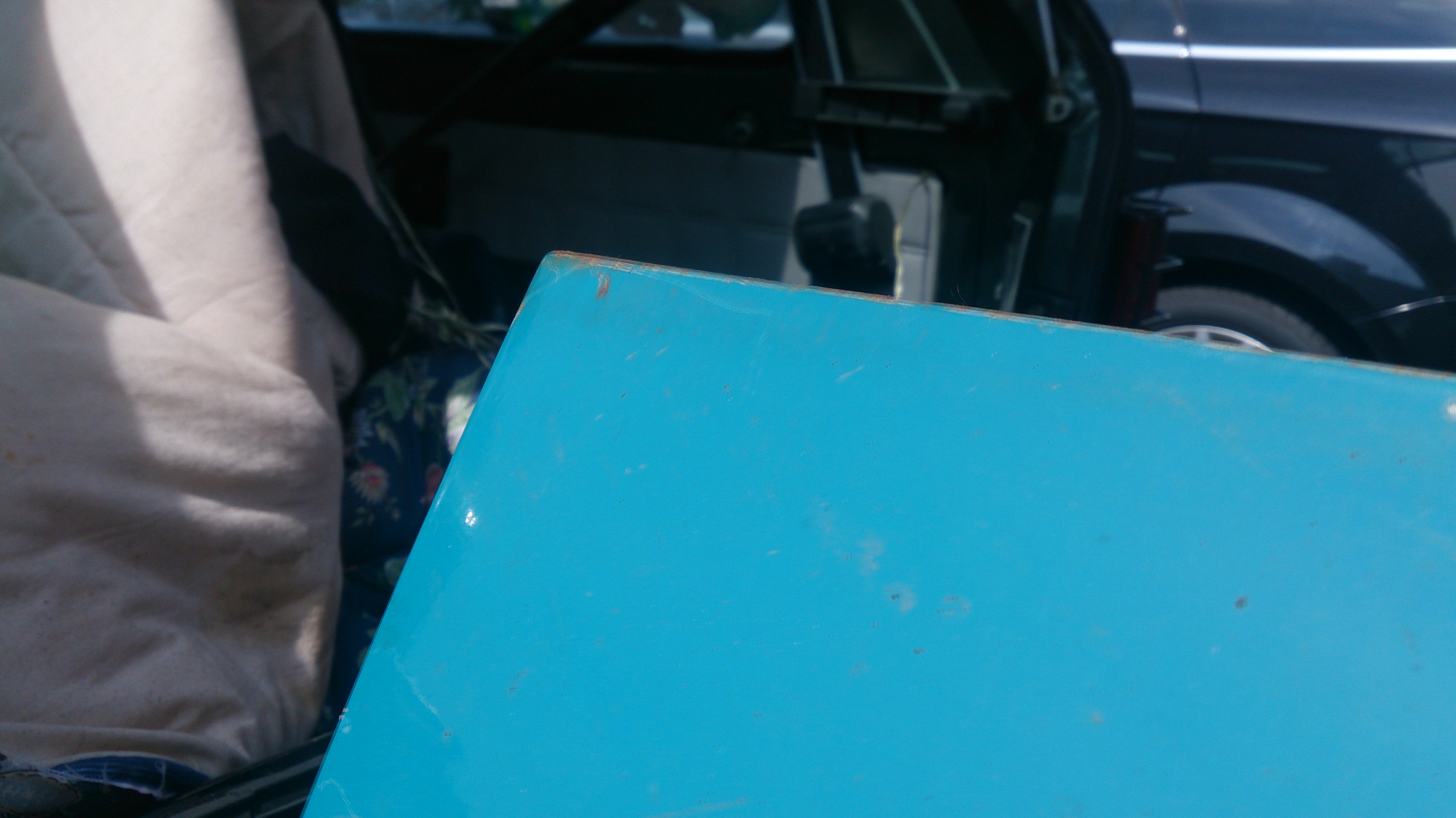

So. what did i get for Talon then?
one Rust free door, and one somewhat rust free door!
now that is the kind of door rust i can sort out!

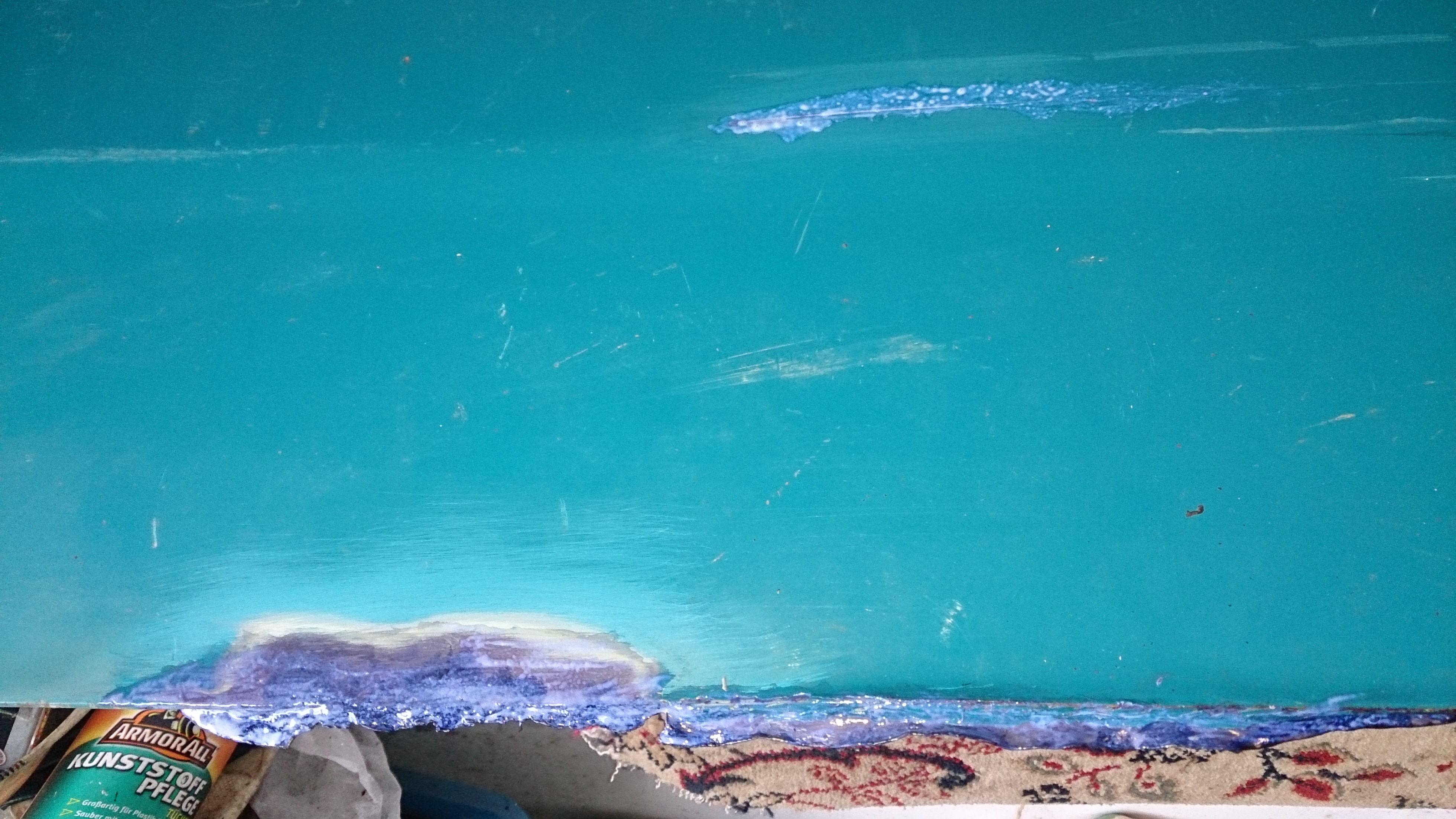

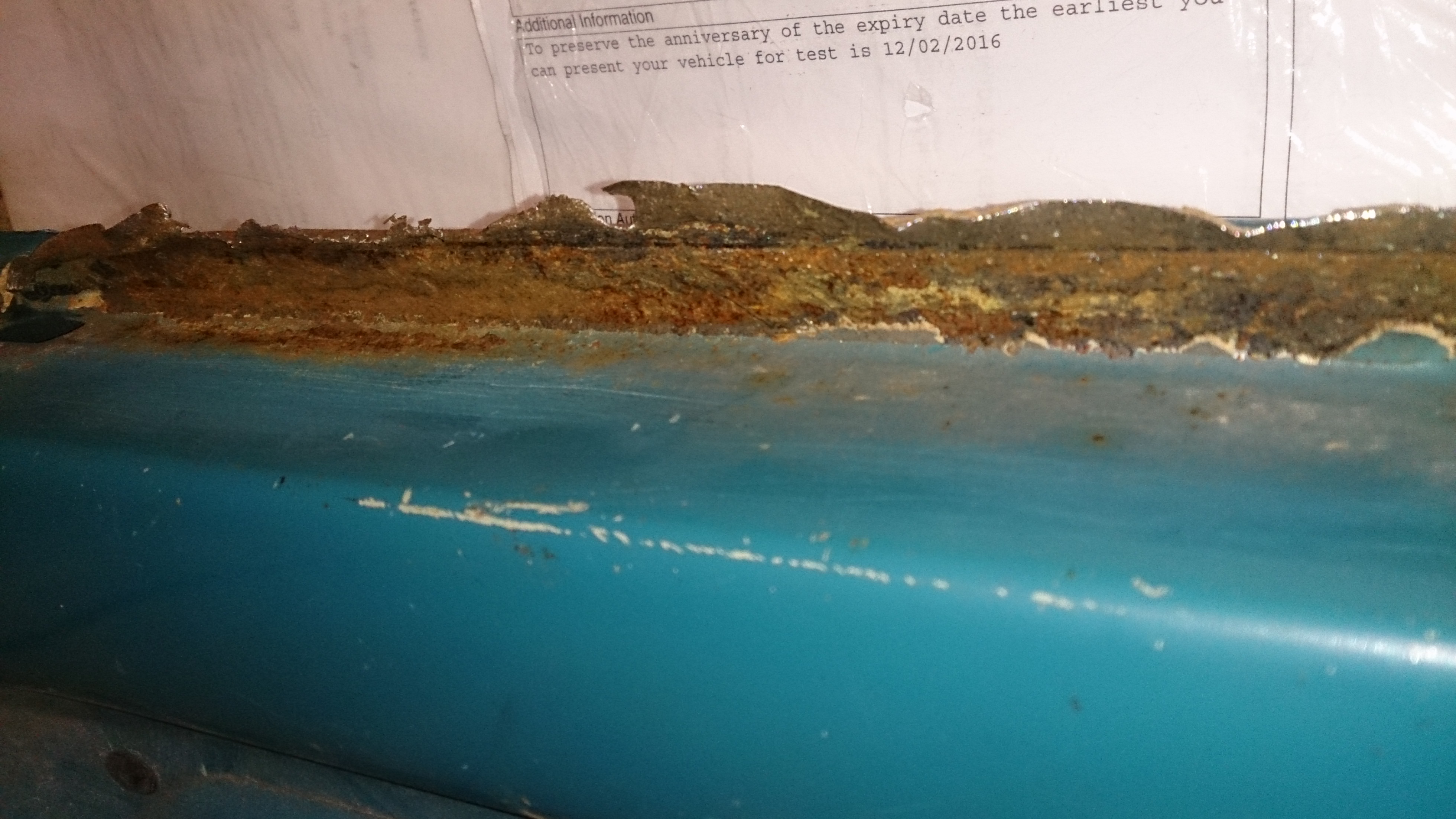

i did a bit of work today on the doors.
the rust had worked its way a fair stretch under the sealant and lip.
however i have chased it all the way and i think i am at a point where i can say i think i have found it all.
i am going to have to reseal it all as i have opened the lip up using pliers and a flat blade. it was a must do thing to do though.
check these pictures out..
yeah pretty sure i can save that.
i have scraped all of the larger chunks of rust out, i do have to wire brush it, and more scraping is needed.
so far no holes have appeared in it!
i think the rust converter will do the job, i will be able to bend it all back into shape after painting it inside the lip then when its dried i will just fill the door full of what ever oil is the best to use. then waxyol. or the other way around..
well.. all loose rust chipped off. i found 2 small holes in the lip that the door skin folds over i think i can leave them there though.
i have painted everything with the rust converter, even between the skin and the lip..
heres some pictures:
i still have some more work to do on this corner. it needs the paint sanding back.
This is the stuff i am using:
am i doing it wrong? as i am not sure... i know i can hide most issues with filler. though i would like to use as little as i can.
please do comment.. i'm going to need all the help i can get. i have never done bodywork before.
John, what you are doing is ok, but I think I would have cut those sections out and put in some fresh metal, what's there looks very thin and even with the rust converter it might not last all that long before it starts to come back.
You also need to remove as much of rust as possible when doing this sort of thing, looks like you have only scraped it back? A wire wheel on a drill works ok but a poly strip and clean disc on a grinder is much more effective, there are also rust remover gels that can be used aswell.

I agree with this. I tend to flap disc and or wire cup on a grinder the metal to shiny and cut out the bad bits. Then I use the rust converter (similar to what) you have. I like to under coat with a good zinc primer like Galvafroid before painting too.
That said, grinding would almost certainly have made a hole and more work. Doing what you are is fine for now - it will come back though, but then you will have more experience and it will be easier!! (y)
