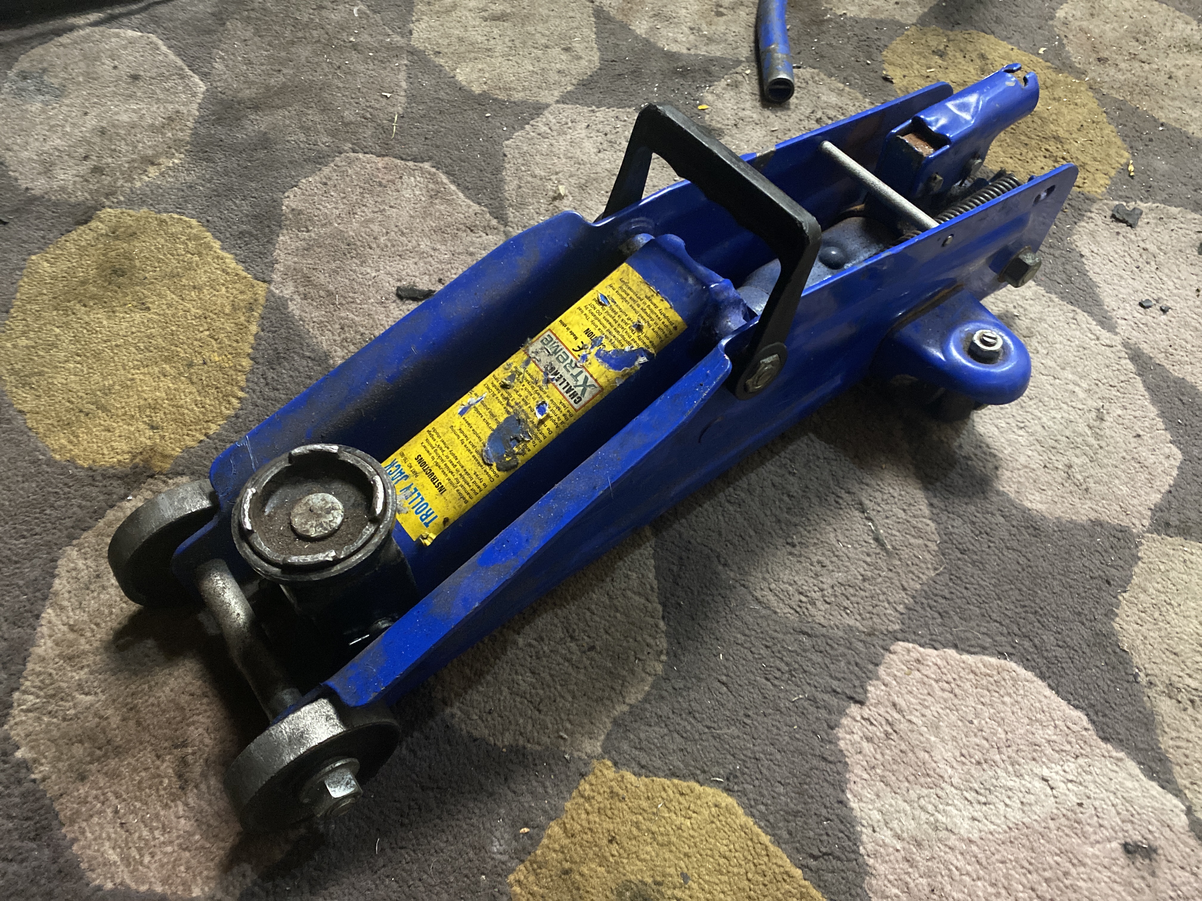

This jack's main hydraulic element is one you find in many brands of these small "hobby" jacks. I suspect there's a factory somewhere in China, Taiwan, or wherever knocking these out by the million which the jack manufacturers then buy for their production. Here's a couple I own at present:
The yellow one was bought just a few years ago from Halfords but the blue one must be 40 years old if it's a day and they are, to all intents and purposes, identical. The blue one has a red pumping element because it's original one failed and I fitted the element from a similar Sealey to keep it going - the cylindrical bit that does all the work, contains the main ram, oil reservoir, smaller pumping piston, over pressure relief valve and a screw type valve which allows you to either pump or relieve the pressure to the main ram. I've attempted to"mended" a number over the years with varying success. The biggest problem for anyone trying to mend them is that there's no spares backup - I've not found any suppliers, but if anyone knows of one please do let me know with a PM.
