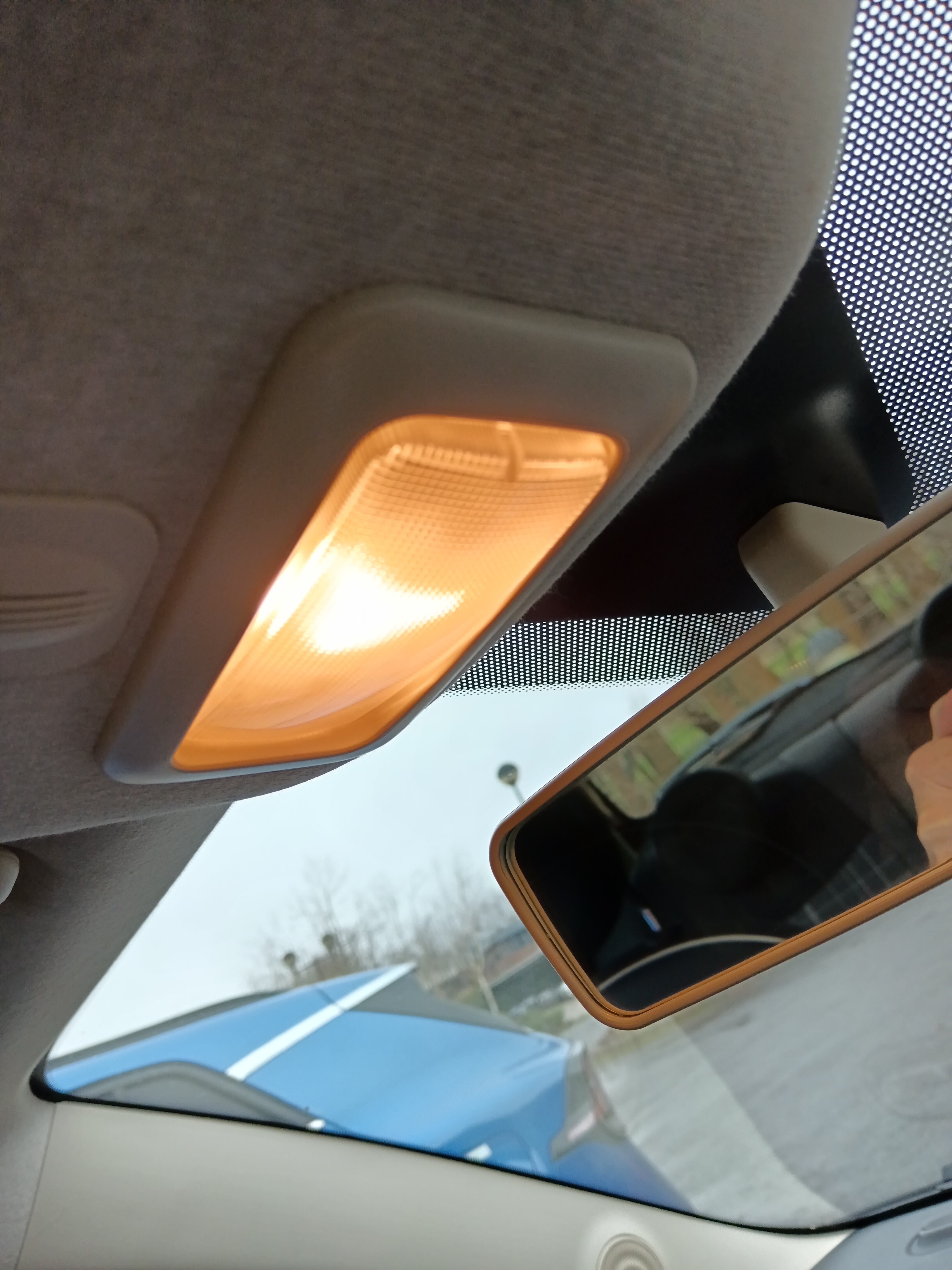

Just the basic 'rocking"lamp in my 2018 Lounge model, appears to be 1 bulb
Level: operated by door switch
Left side depressed : ON
Right side depressed : OFF

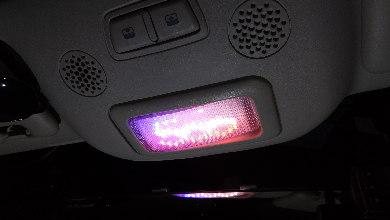

The switch is integral to the lamp and I can vouch for the possibility it's been clumsily assembled, as I did :confused: when I replaced the globe with the LED '500' circuit board. But that involved removing the lens from the lamp body, which you don't have to do to replace the 5W festoon bulb.
As you can see above it's also possible to simply reverse the lamp body, so 'on' is at the right, nearest the driver in RHD. 🙃
