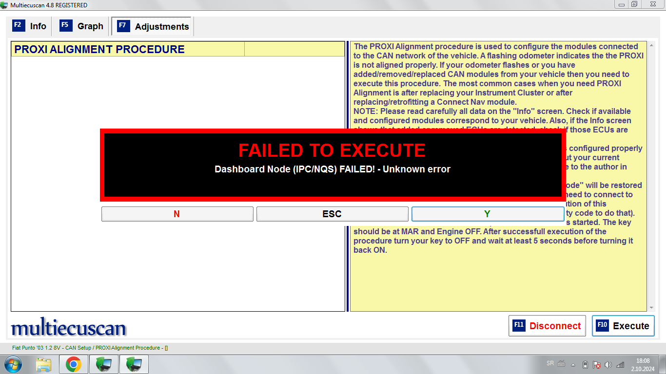

So my friend is trying to install instrumental cluster from punto mk2b to mk2b. Of course it fits but proxy is problem he gets "unknown error"?

I can't imagine how it could work. Both engines have different ECUs and as I assume the instrument cluster is getting most of the data from the ECU, they should be somehow paired. Perhaps another diesel engine's cluster would work (another displacement or power), but petrol and diesel engines have completely different engine management systems, so most probably the data received / transferred is completely different.

Thanks for the answers. Here's what really trips me up the most: One guy managed to make it work, swapping from a 1.4 petrol to a 1.9 diesel, without any trouble. And here I am, trying to swap a cluster from a 1.4 to a 1.2 petrol, and I'm getting the same 'unknown error'.

With all due respect, I am quite sure there was no 1.4L version from '99. They came out with the MK2b, which is the same as the 1.3L. Therefore, clusters from the MK2b are not compatible with the MK2a due to the older body computer, and that makes sense. I successfully managed to install the cluster, and everything works great—Trip B, I installed the temperature sensor, and I even managed to correct the mileage with the Fiat KM tool. I also found a guy who installed a cluster from a 1.4L into a 1.2L, so that should work as well.
