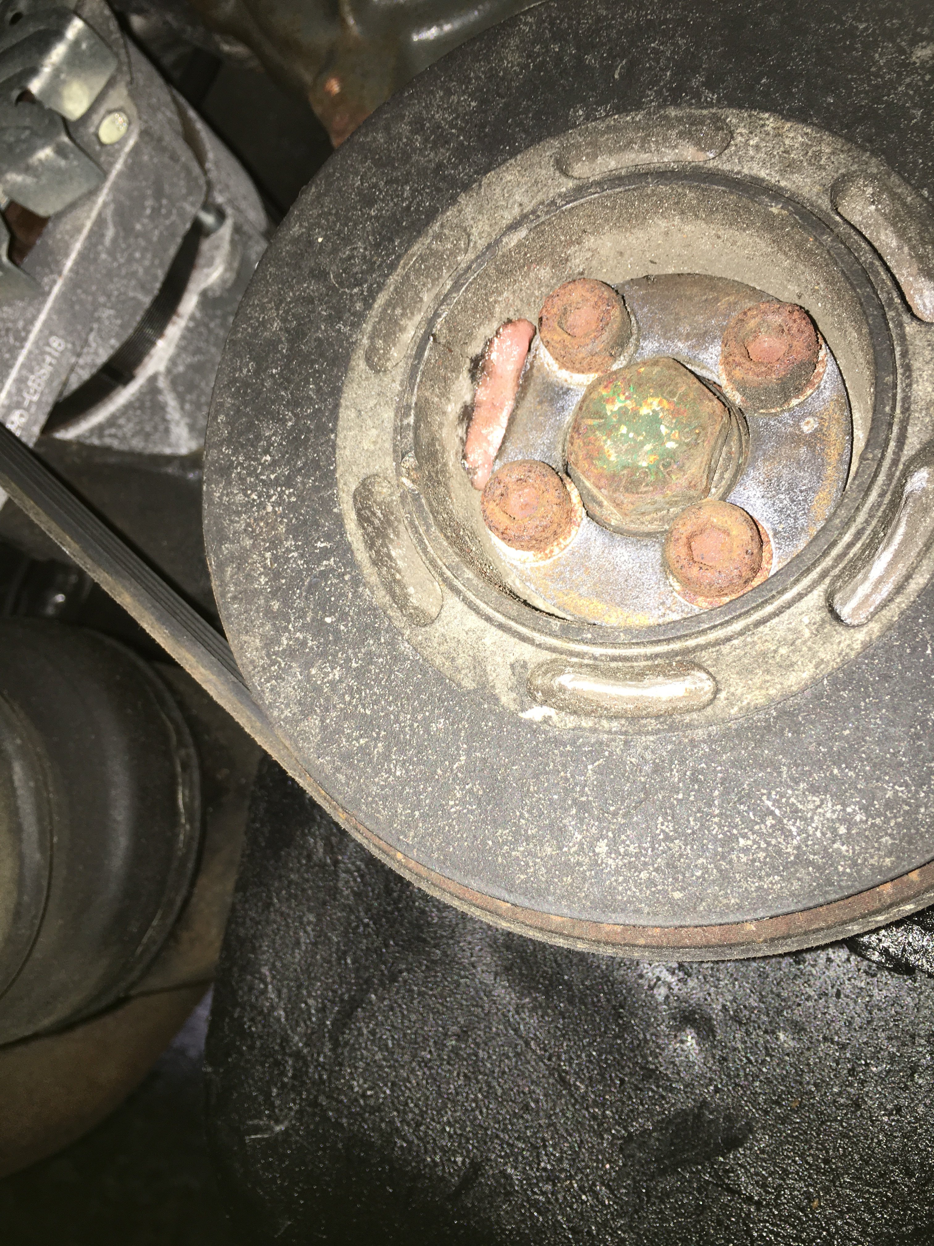

Im reading right now about timing check. I didnt see any marks on the wheels but on this car it is about locking the wheel with bults.

Now I try to find out how I find TDC and sync the pulleys. I dont se any marks anywhere. Just som paint marks
Not sure if my book goes back that far, but what engine code etc?
When coming up on compression on no1 we had whistle that went in the injector hole and with a little practice back and forth you could find tdc. With cam cover off if firing on no.1 then no.4 inlet and exhaust cam lobes would be on the rock i.e. which ever way the cam turned it would move a valve.
At college we were shown how to time an engine with no timing marks at all! Probably not precise enough for modern engines but certainly worked in the old days
