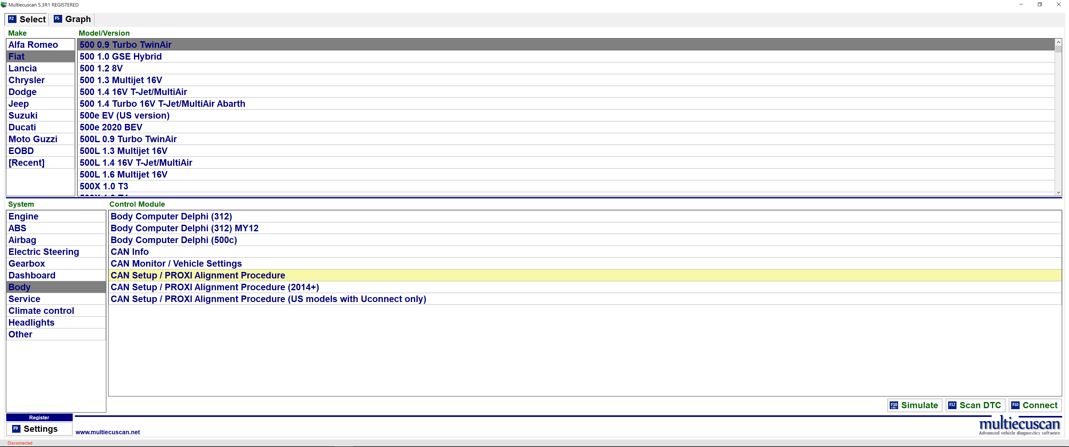

What model is your vehicle?
There should be a Proxi Alignment that better fits your year.
For instance the one highlighted in yellow.

My model is 2008 and i made for mistake proxy alignment 2014+, if I try the alignment you suggest doesn't remove ETM but I always get "invalid signal from ETM" and odometer flashing. My blue and me seems fine, I don't get any errors from it.
As long as I know ETM should be present only in models after 2014 (restyiling model) so I have to find a way to remove it.
