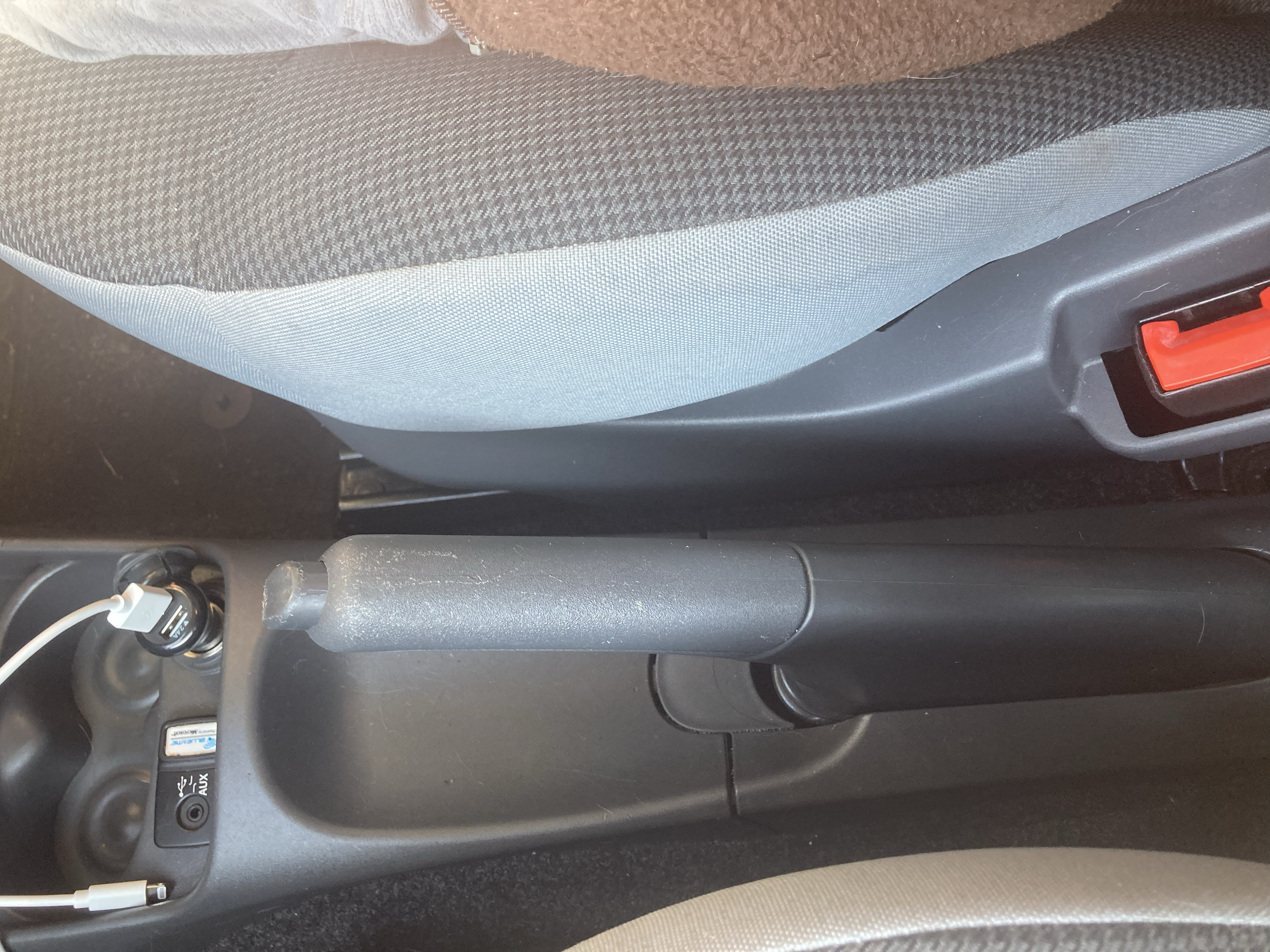

Hello all,
Just got a 2014 Fiat 500 (POP with Dualogic) last Friday! We had some issues popping up straight away ; check engine light on within 24 hrs of purchase + dualogic failure with gear shifting to N at random.
I had an independent Fiat guy had a look at it and got a report, and the car is being sent back to the dealer's mechanic, who's done the RWC (I'm in Australia).
Something I thought was kind of odd was that the driver's seat's height adjustment handle appears to be missing where it's supposed to be? It was advertised to be height adjustable but I just cannot figure out how! I had a look at owner's manual online (didn't come with the car) and it's meant to be there.
The plastic casing for the seat appears to be clean and free of damage so I'm wondering if someone's swapped the seat altogether at some point. I just sent a note re; this with the car.
Would you have any insight? Was there a model/trim that didn't come with the height adjustment? It's just hard to imagine a car being shipped without height adjustment at that point in time (2014).
Any thoughts would be appreciated. Cheers!

From what I can read here, the Pop doesn't have seat height adjustment. And it's not even an option.
(Kind of unbelievable in my opinion. Can't remember seeing a car without it in the last 20 years?!)
I'm both disappointed and fascinated by this. 😅

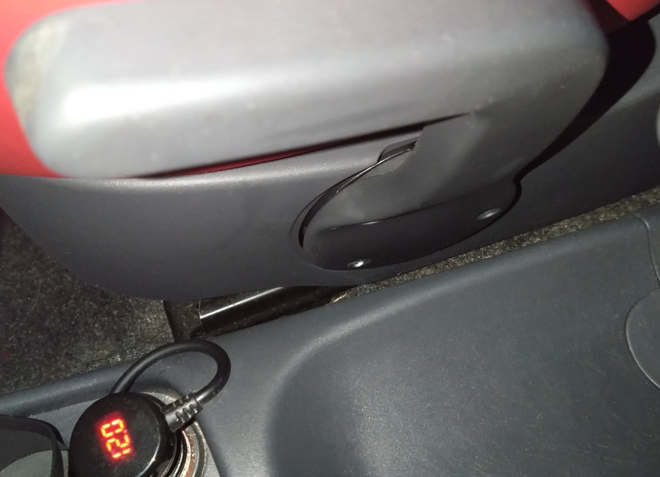

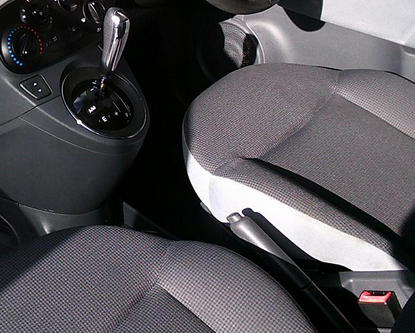

When we bought our two 500C's in 2013, mine a Lounge Twinair Manual and my wife's a Pop DL, both had the seat height adjustment, but a flick through the Carsales website just now shows that it was standard on most, but not all, Pop's in Oz;
The above is a 2014 example.
I drove both cars more or less side-by-side for six years and I have to say I hated the DL! 🙃
