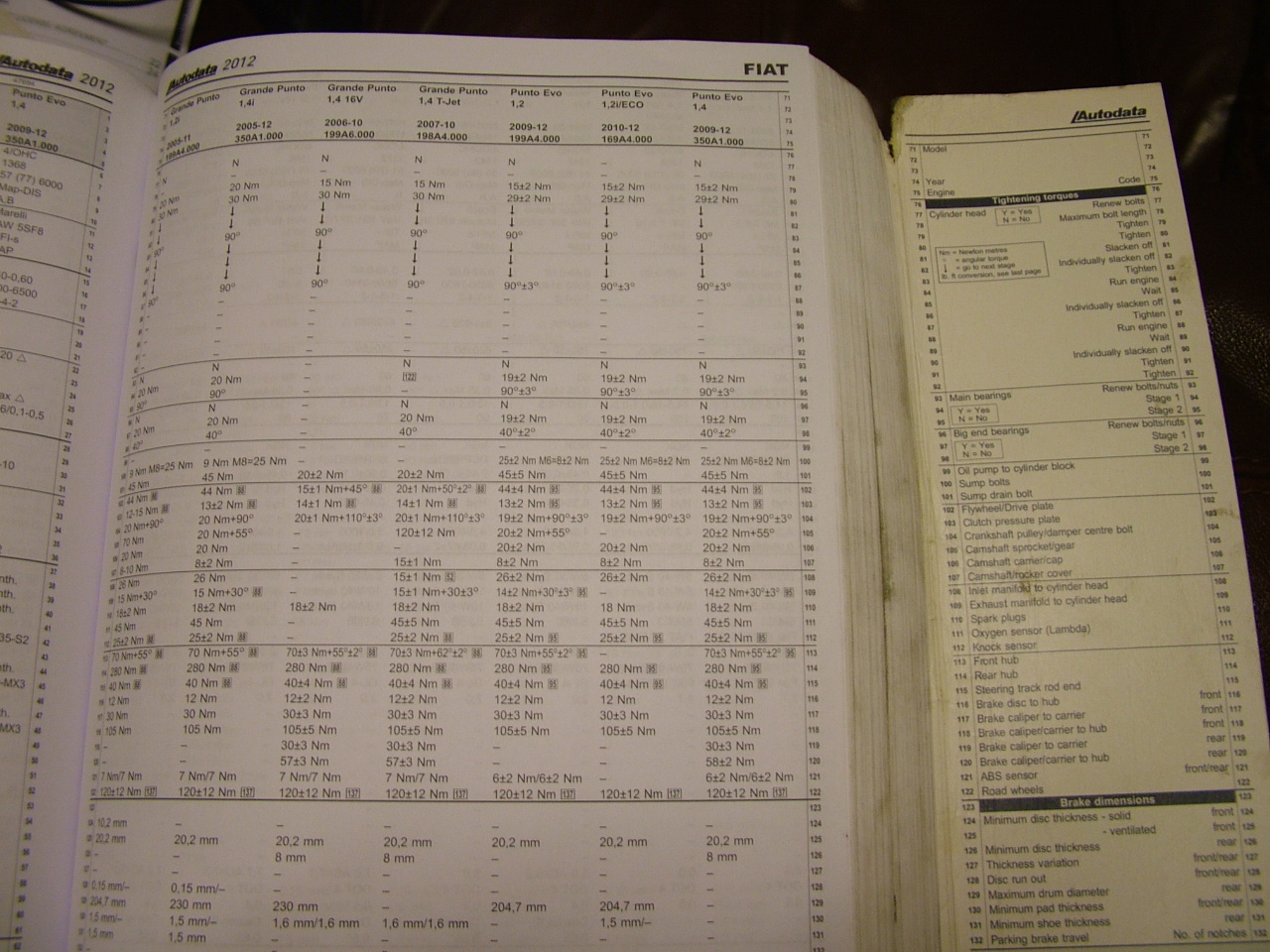

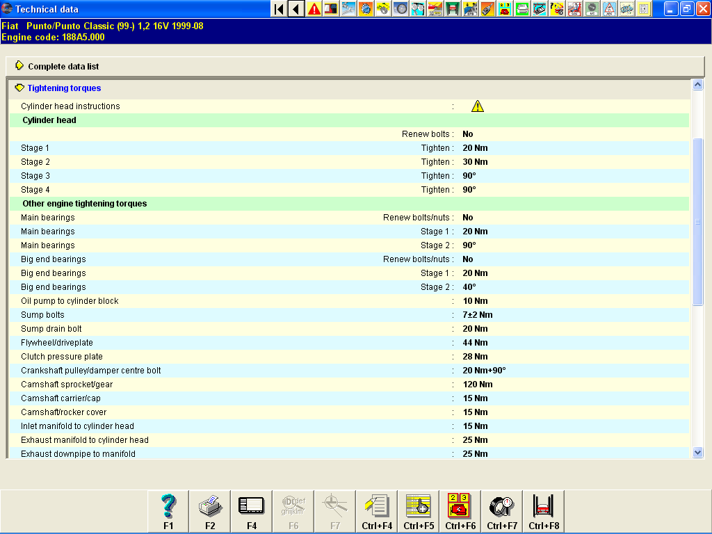

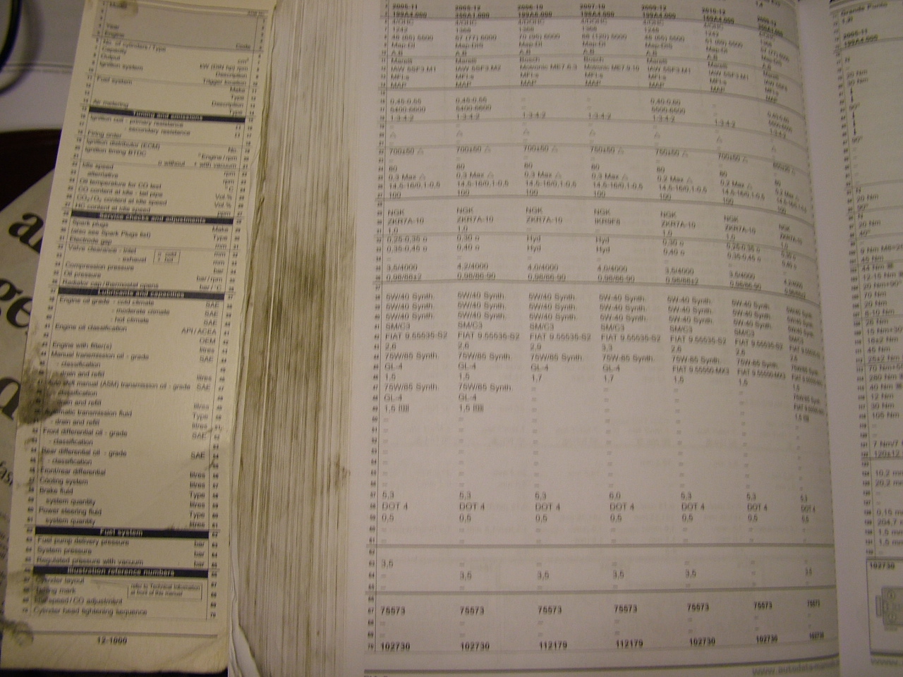

What is the engine series number?
Does any of this look familiar?

Hi Mike, sorry I'm not sure of the engine number. Can it be found from the reg WR10GZB?
I can't , but you may see it on on the chassis /vin plate or sometimes in the V%c log book or your owners handbook.
Can you see if any of your numbers match up with the numbers at the top of the pages I gave you.
Hi, it will be the top right on the 1st page Punto Evo 1.4

So will it be 15 then 29 then 90* then 90* again but what pattern

Find any manual for 8V FIRE engine (with M9 thread bolts), torque specs will be the same (like 20 Nm -> 30 Nm -> 90 degrees -> 90 deg.), pattern too (it's universal "star pattern" for most engines, you start from the center bolts and work toward outer ones).
