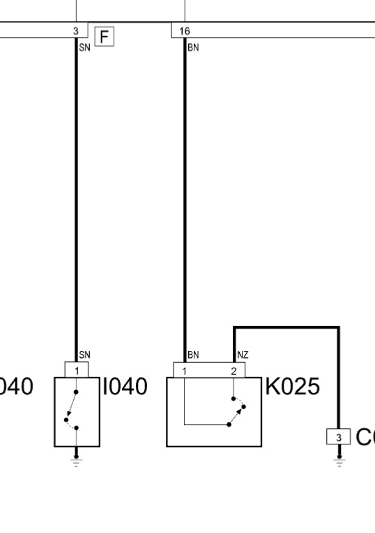

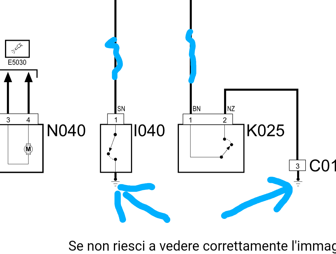

The body computer (BSI) tells the dash to put the warning light on
The BSI receives both the handbrake and Fluid level independently there is no shared wiring
They are both very simple to check with a scantool
Both are just switches that short to ground, you can watch them operate as you unplug them then short to ground
The light on the dash can be controled via any decent bidirectional software
Handbrake switch is here

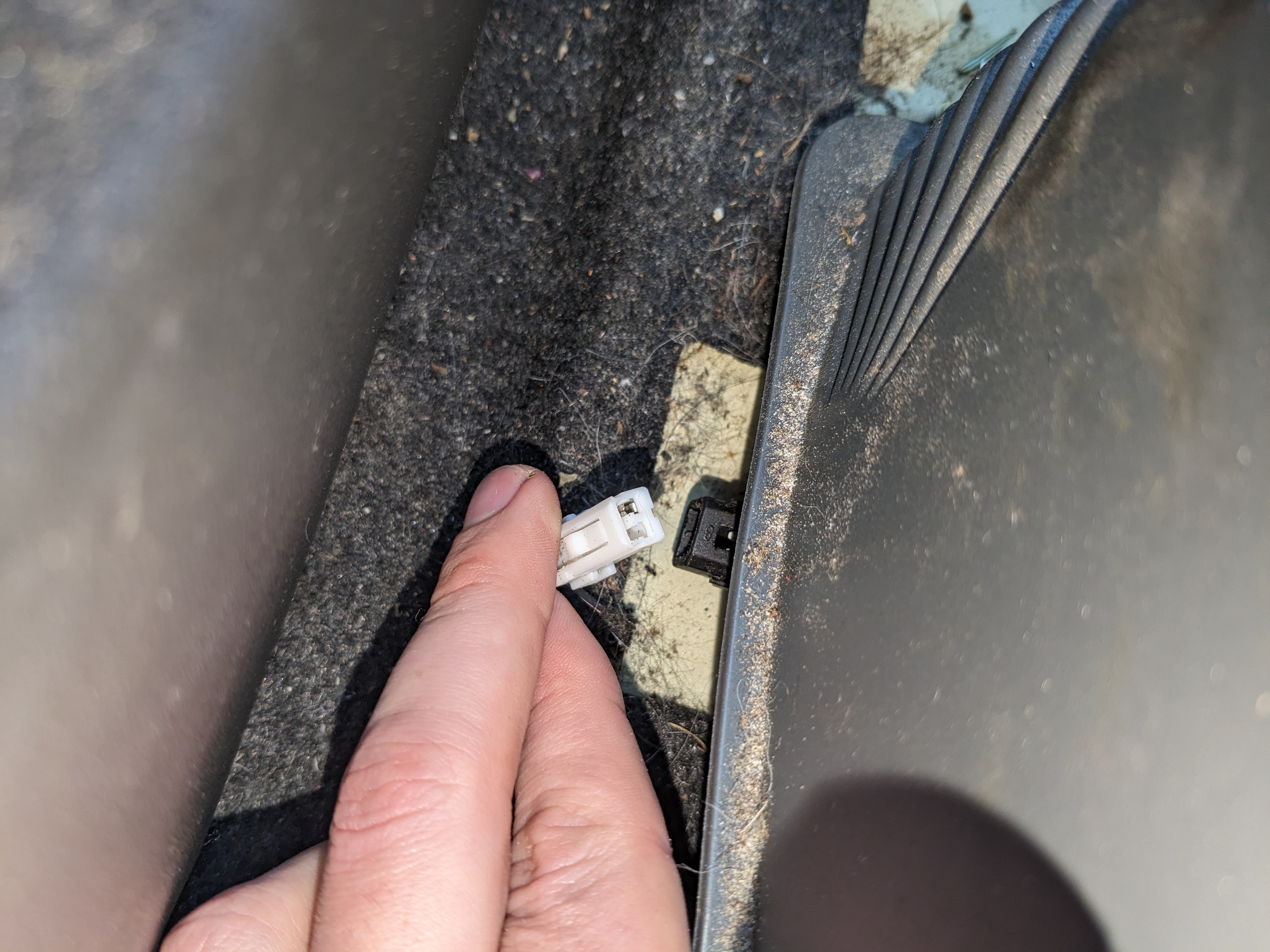

I accessed this handbrake switch area. Unplugged it /Plugged it in. Handbrake on/off.
Still the light remains.

Both switches are just paths to chassis when closed
Just unplug the connector and put a pin in the end and jumper it to some bare metal
Or the switch on the handbrake should read zero ohms from the pin to ground or open circuit depending whether the brake is up or down
So I got my multimeter on Resistance. Placed it into the handbrake white plug & then touched the other lead down to ground (the nut which fixes the handbrake down). This gave a me a resistant of 2 milliOhms.
So I think I did what you asked right?
