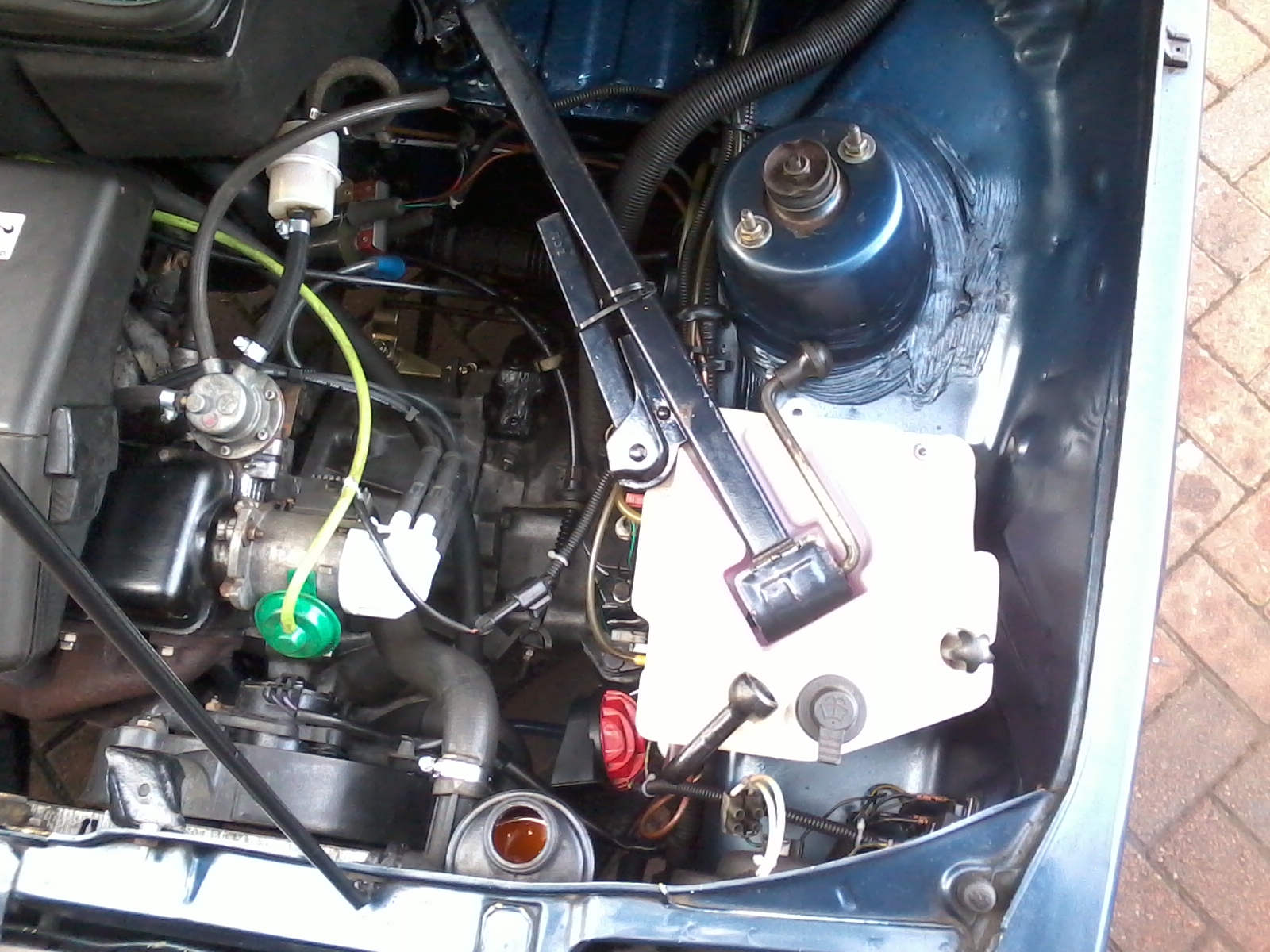

OK this is what the gearbox end of the underbonnet looks like now, look at those shiny new bits of gear linkage peeping out the bottom!:D (The washer bottle's not actually illuminated, that's just how the picture's come out) Taken it for about 20 miles worth of shakedown today and the gearchange is pretty stiff so I'm hoping that frees off a bit with use, and it's like a proper Panda box now, shorter more exciteable gearing and no discernible synchro in 3rd...doh:doh: Father in law says after we got it back in "oh yes the synchro was pretty weak in one gear I remember now" Well it's staying put now so crunchy 3rd it is.
:eek: ...now, I'd need to be driving the old fella to answer that wouldn't I. Still haven't quite cured the gearbox oil leak yet (anyone know where the breather is on the gearbox?) and I'm working full time for the first time in months so I'm not quite getting round to anything at the moment. Needs a decent run I reckon, linkage is stiff and it's a bit noisy but as I said the gearbox hadn't turned a cog in anger in 15 years and several bits of the linkage are new.
