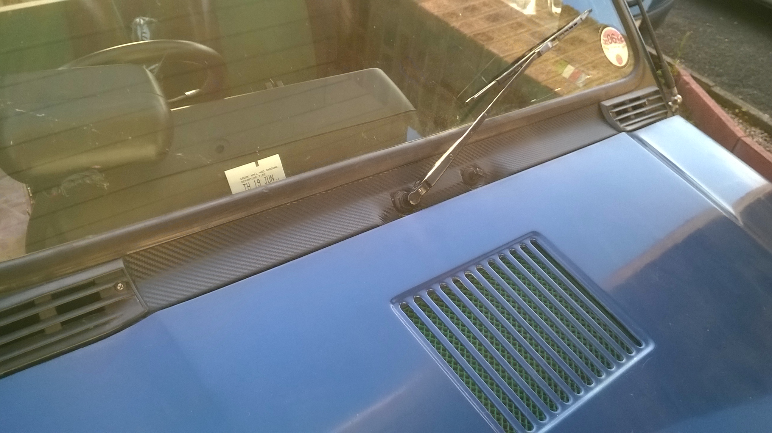

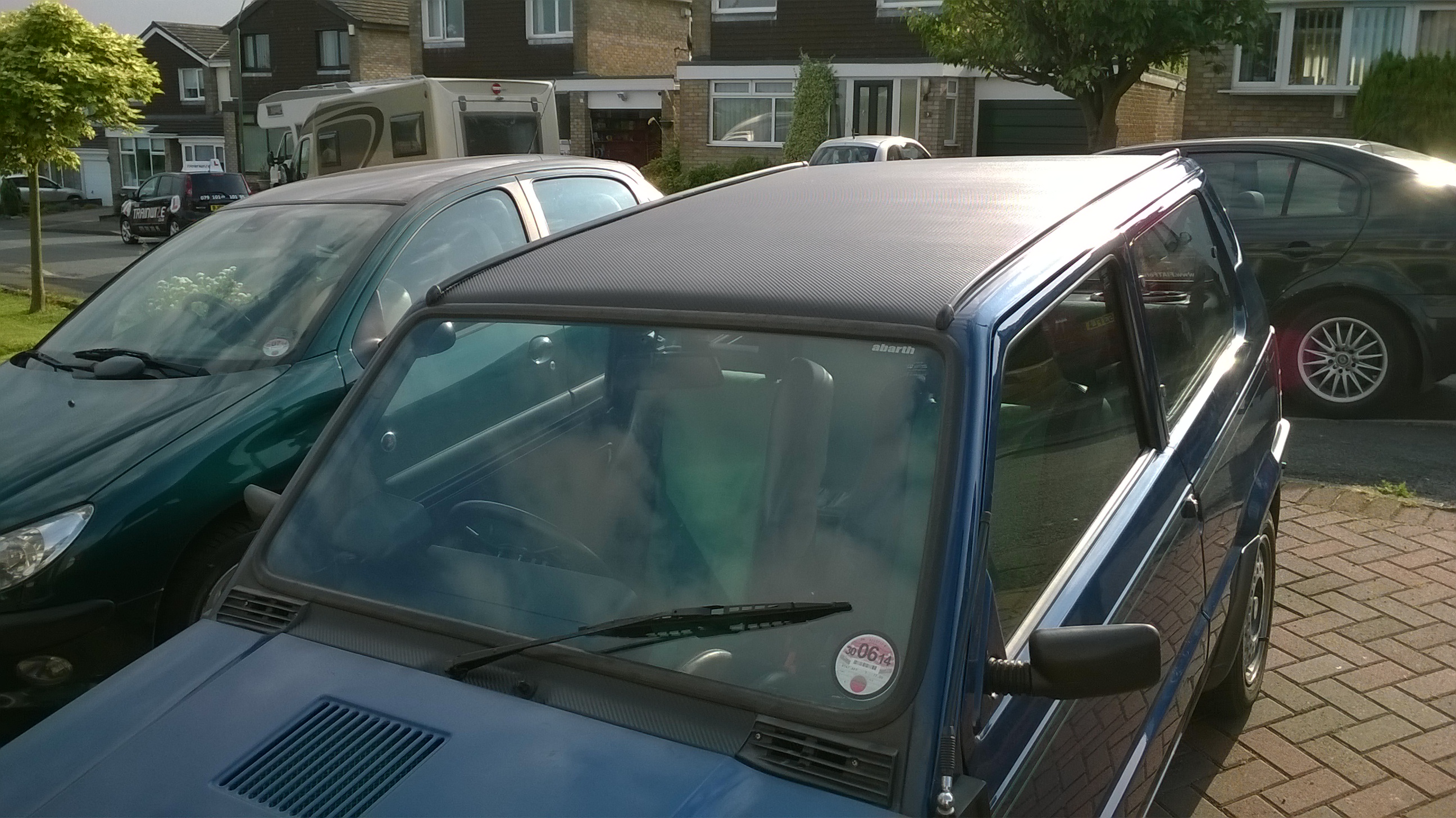

Highlights include the new mk2 golf splitter and chavtastic blue lensed driving lamps (they were reduced OK) in the front bumper, Momo steering wheel, aftermarket gearknob on shortened gearstick, 40mm drop on new standard shocks, mystery retro pepperpot wheels (anybody any idea? came off a Tipo in a scrappy) converted to Uno electronic dizzy, K&N panel filter in standard airbox with shortened intake, Powerflow stainless exhaust rear section with Y10 standard front section, array of extra instrumentation (tacho, oil pressure and volts) and assorted other bits and bobs dotted around that my father in law (the previous owner) fitted and I just find out about when new stuff I buy mysteriously doesn't fit:confused:

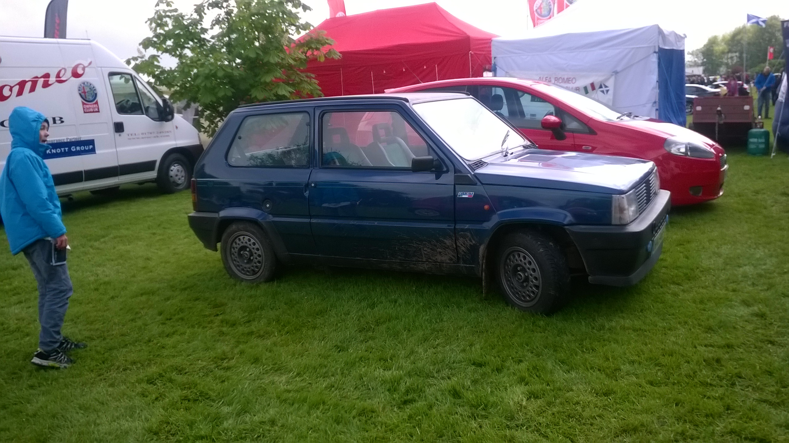

Pic of GW at the show after he'd been plodging in the mud like an excitable 3 year old..

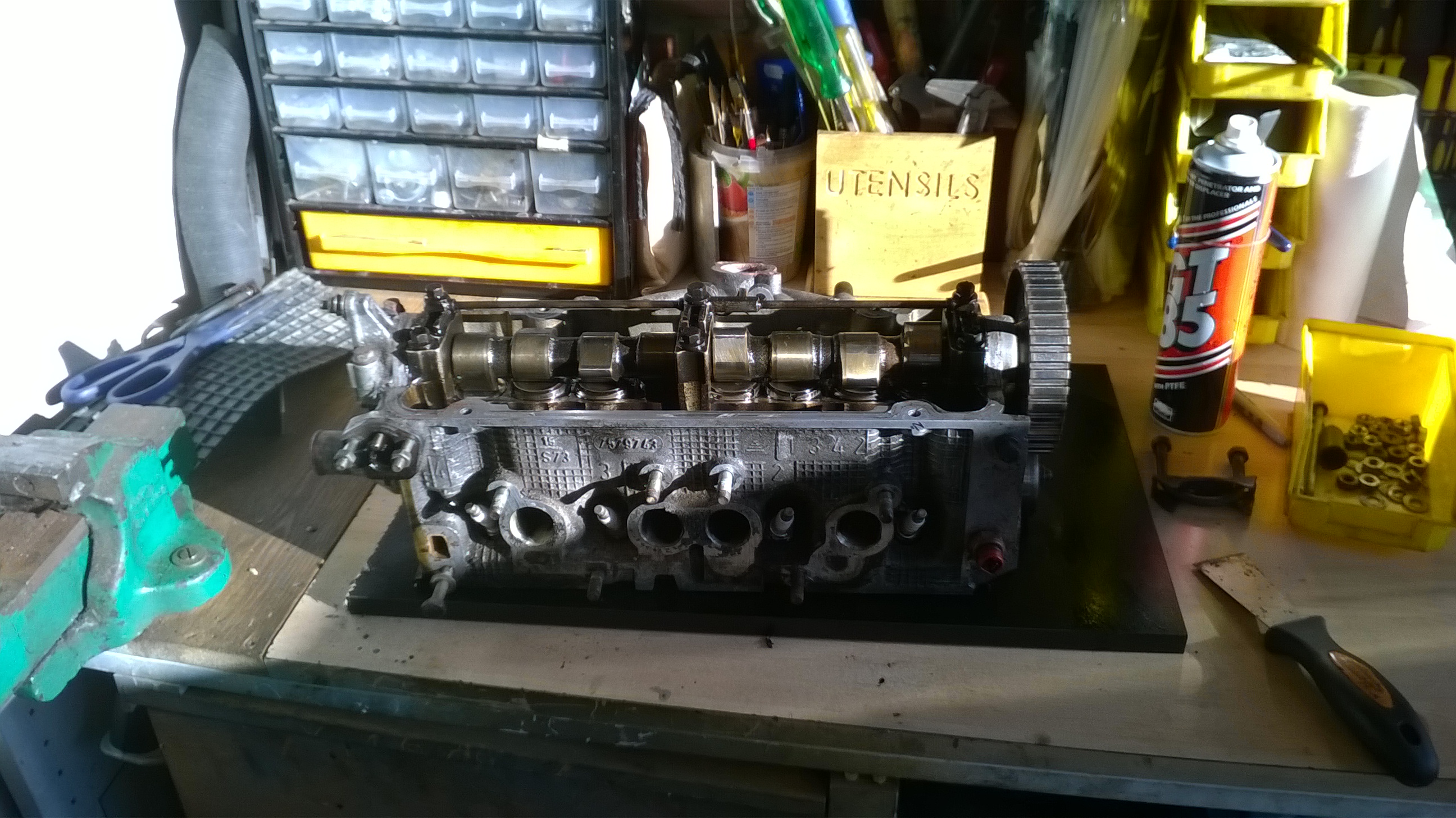

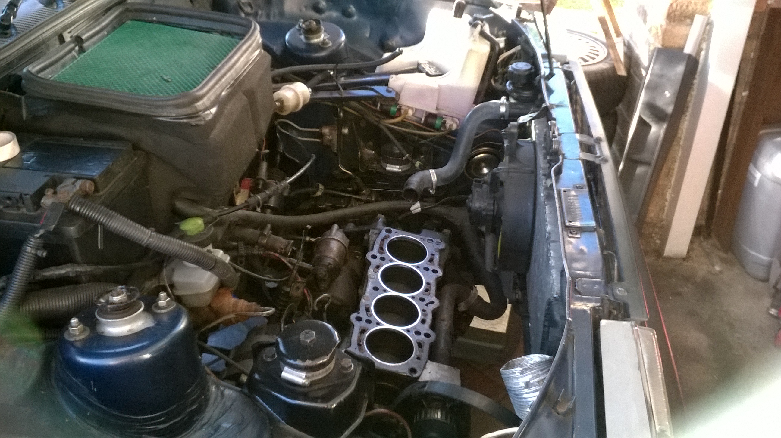

Grumbleweed was running worryingly warm on the way down to Stanford Hall, no heater, and pressurising the coolant. So since I've been building up the bits for an engine refresh anyway I figure it's about time I had this apart before (hopefully) the head goes all out of whack. Plan is to pull the valves out, clean up, lap & re shim. New piston rings, light hone and big end bearings while I've got the head off, then reassemble with new timing belt & water pump. That's the bits I've got so far anyway (shims aside)

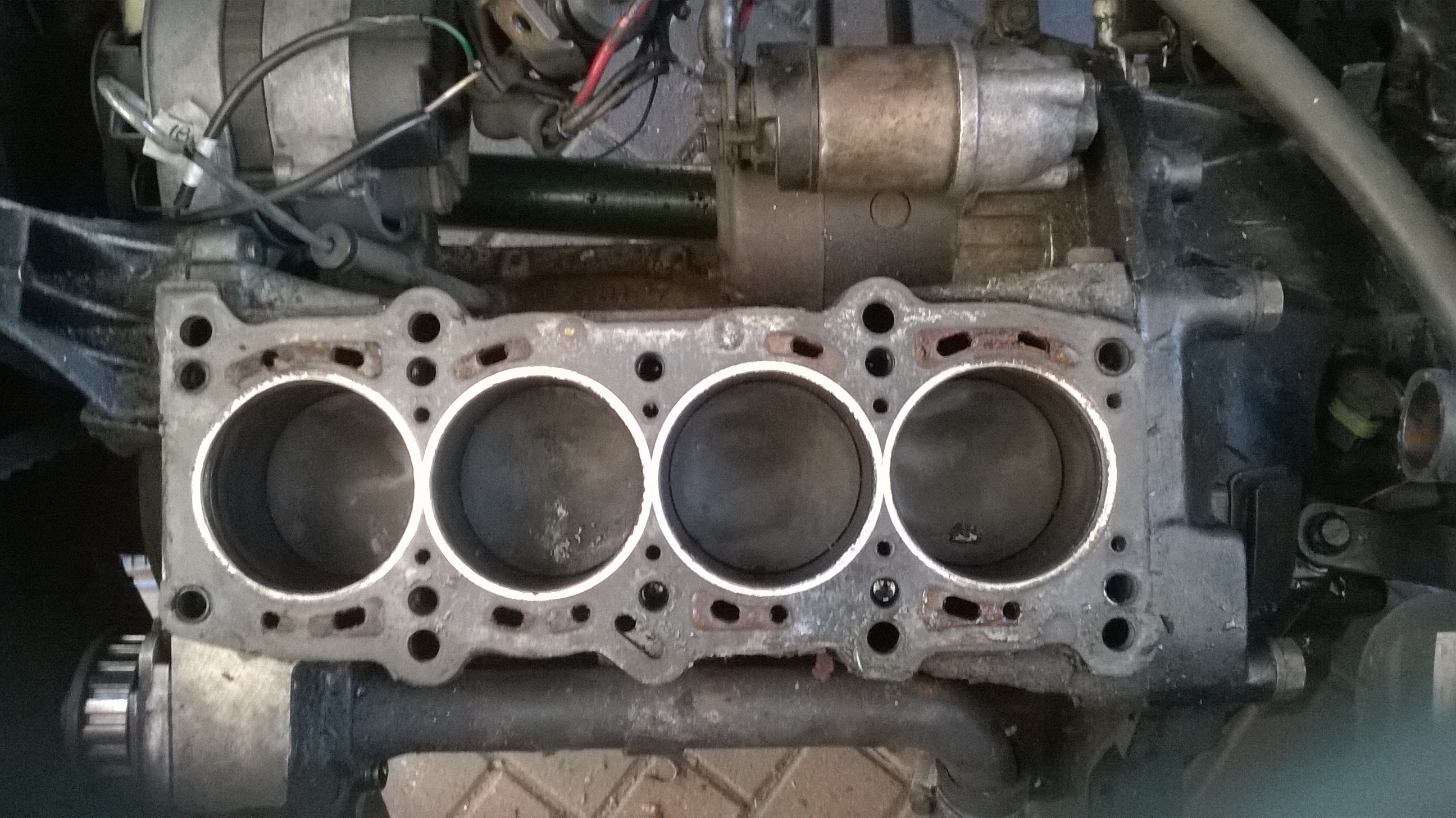

HG looks like this when I've gone in. First time I've had a head off but I can't see any obvious fail points on the gasket, possibly been seeping past the seal around no. 4 maybe, but no actual gaps in the gasket. Any more practiced eyes got an opinion?
