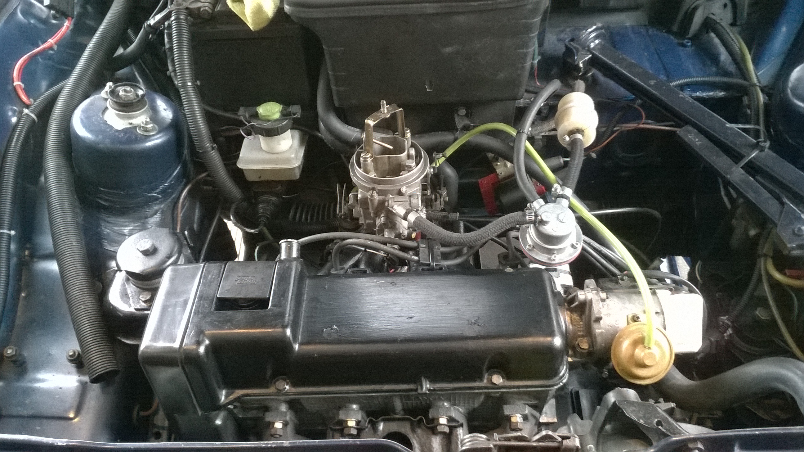

So having failed to take any pics of the engine work, here's some pics of it back in again: Satin black inlet manifold & block now(y)
and here's an enginehttps://www.fiatforum.com/gallery/data/500/WP_20140721_001.jpg ...

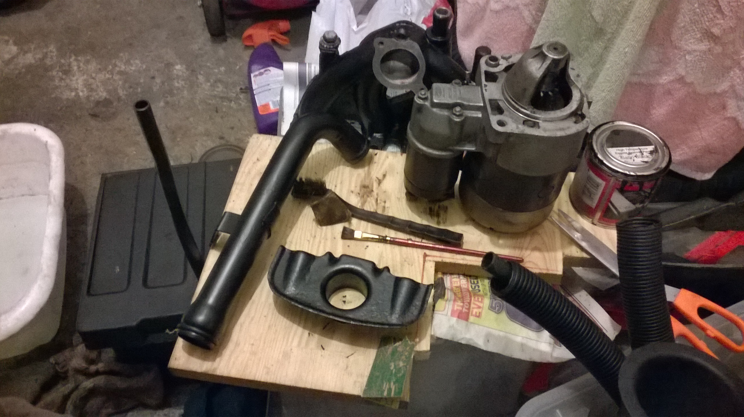

and what I got when it was in bits: Exhaust manifold all cleaned & painted

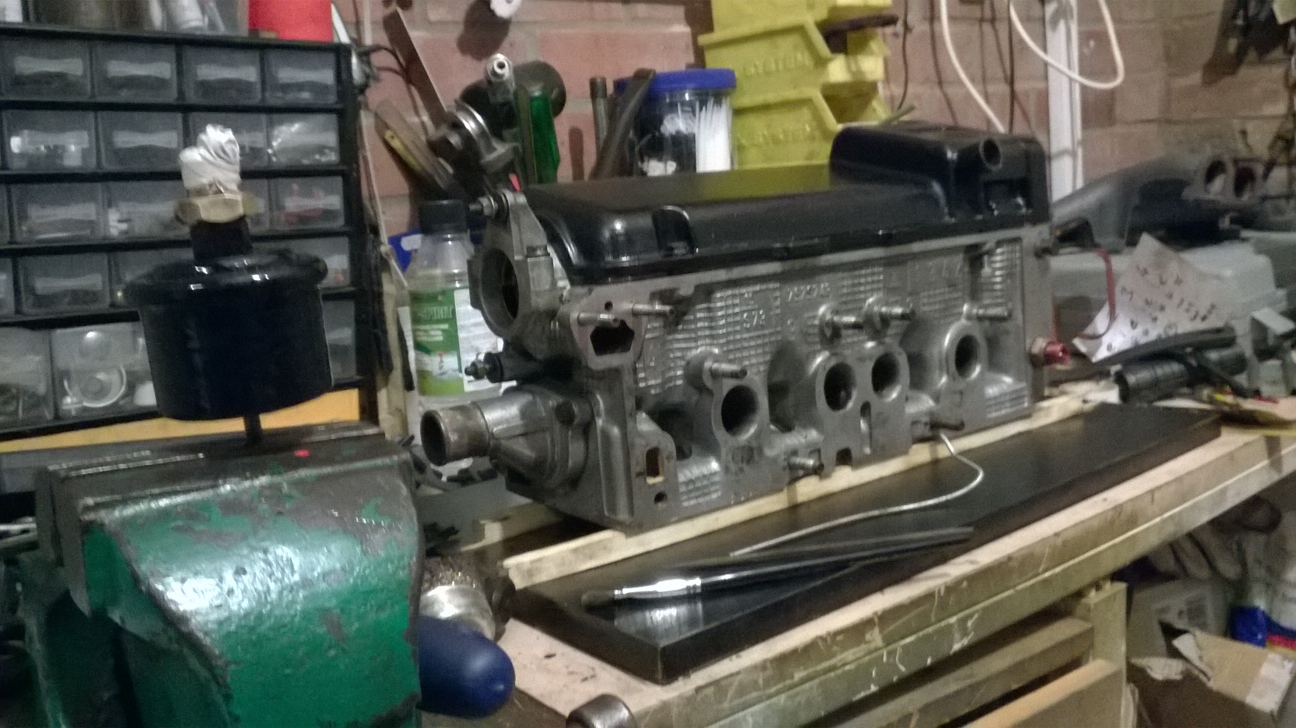

head back together, oil pressure sender finally cleaned & painted, looked hard up
Valves, before and after
sorting out shims
