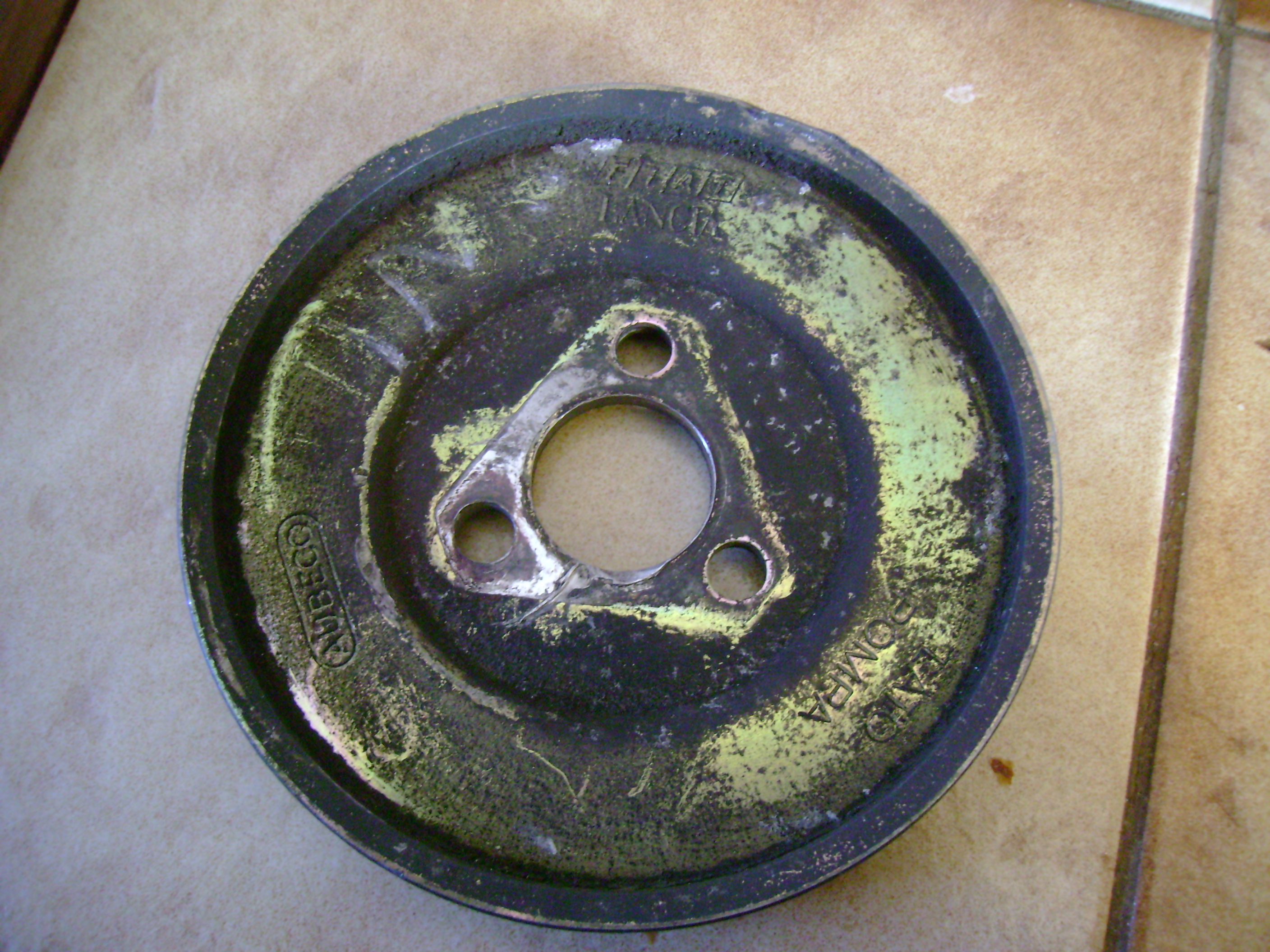

  • The water pump has a certain bolt flange diameter, but when I purchased the pulley, it was another diameter. Anyone have the proper part nos. for matching sets?

Looking at the 16V parts slides I see that the water pump to pulley interface is a flange with 3 bolts securing the pulley to the pump shaft flange.
Is this what you have?
If so then I believe the pulley is P/N:7641892 costing around £45 (UK pounds in May 2010) and it weighs 460 grams.
Why don't you kave a look on ePER on this website (see menu bar a top of page, 5th along).

Regarding the water pump, to clarify, the engine came with a water pump on it. The bolt diameter was smaller than the pulley bolt diameter. I purchased the pulley a while ago, will have to check the part no. and report back.

The pulley I purchased was part no. 7701502. It doesn't fit the water pump on the engine (engine didn't have the pulley when I received it), but I will probably purchase a new water pump anyway.

Thanks, my pulley that is too big is 3 bolt, and 65mm from hole to hole, about 40mm to center to bolt line.
Maddogmorg, do you know of the part number for your pulley, I think that one would fit.
