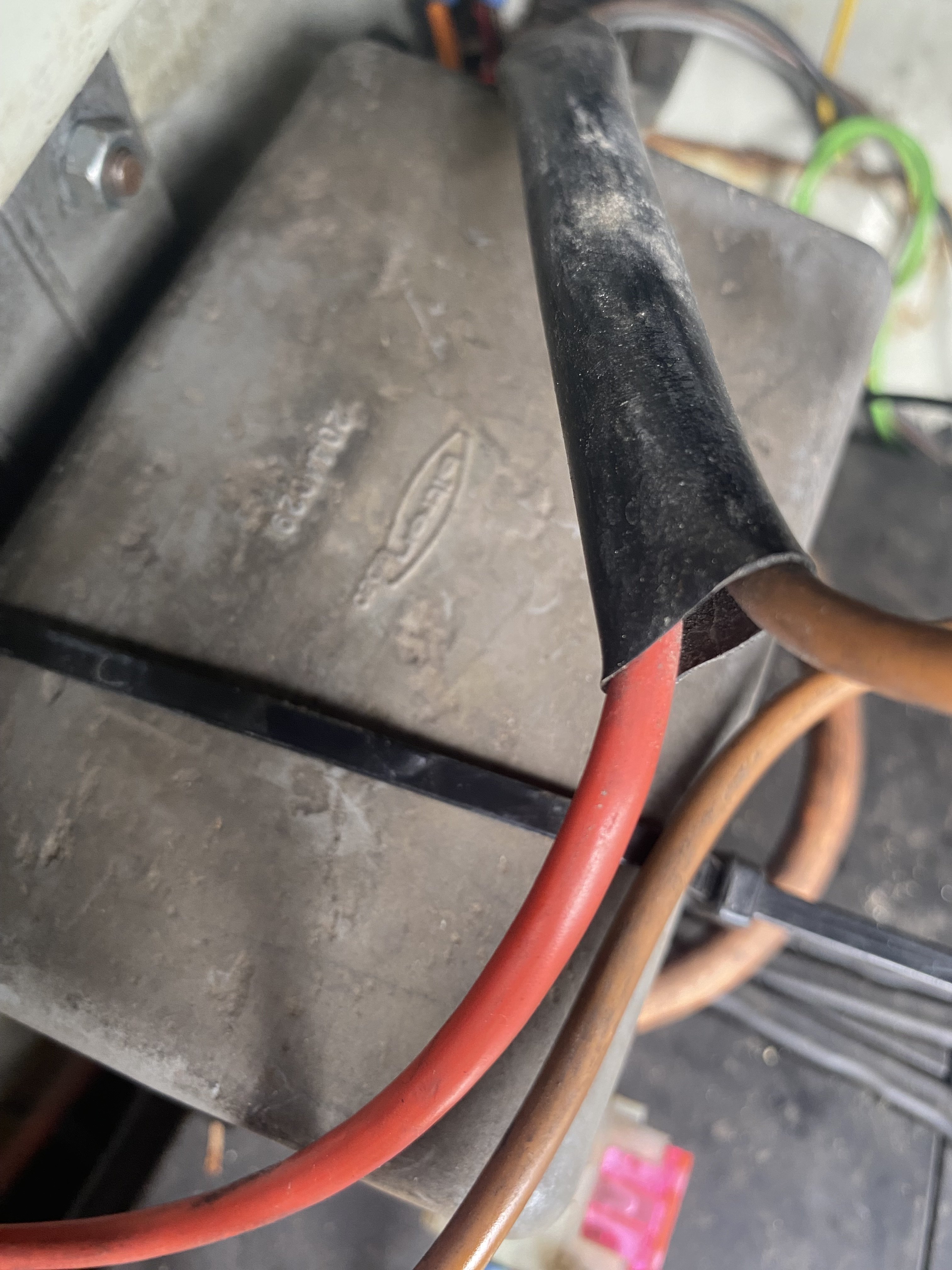

Hi I think my glow plug box is faulty it has the bitron video 2044029 does anybody have any info on an updated part number as I am having difficulty finding the correct replacement part any info greatly appreciated. The van starts but is Smokey on start up and for the first kilometre
I don't have specific data on the glow plug relay, but depending on the colour of smoke it may give more of a guide.
The early 2.5 indirect injection engine and to a certain degree the later 2.8s etc. are a fairly heavily built commercial engine that takes a while to warm up so that the pistons expand and the engine runs more efficiently.
I have owned several in the past and one thing I always did was make sure the thermostat was working correctly so that the temperature reaches the middle of the gauge promptly where the engine will work both efficiently and less noisy also.
This side of smoke issue would be "blue" as in oil burning to a degree.
If "white" smoke smelling of diesel from incomplete combustion from cold, whether from a heater plug or relay issue or a worn engine with lower compression I would expect to clear much quicker after pulling away than any "blue" smoke as in oil burning, certainly less than a kilometre.
Have the individual heater plugs been tested if applicable, depending on the type of cold start system yours has?

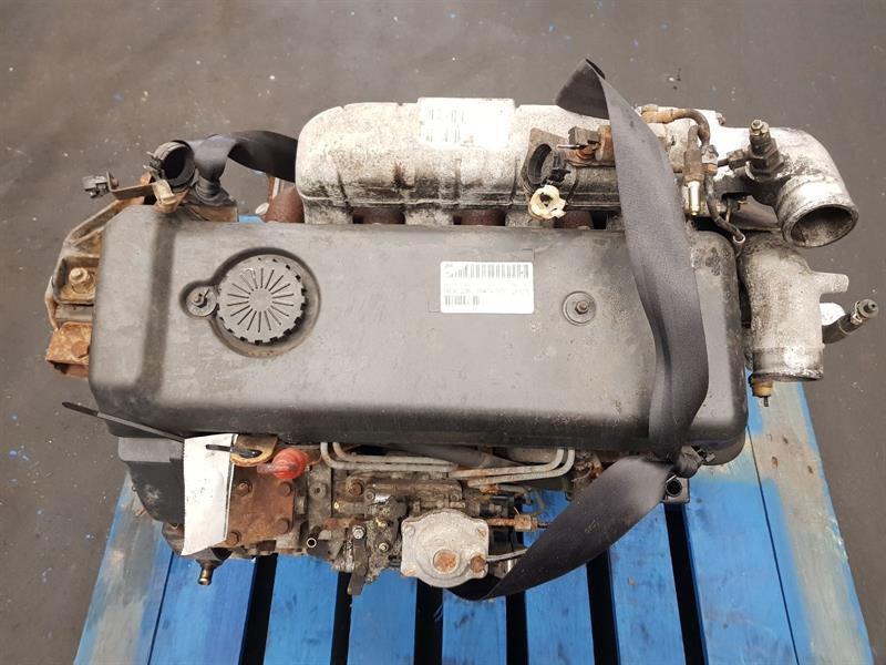

Hiya Mike cheers for the reply im unsure if the auld girl is turbo or no turbo the previous owner stated it was a 2.8 turbo and it stated 2.8 on registration certificate but I have been informed it’s a 2.5 I have yet to climb underneath and check the manifold for a turbo it is an 8140.27 according to the vin plate I just purchased the bus and am trying to find exactly which model it is as looking for info can be tricky if you don’t have the correct model I will check and bleed the system today when it arrives get the new thermostat thanks for your help and knowledge
An 8140.27 is a 2.5 litre turbo, but without intercooler.

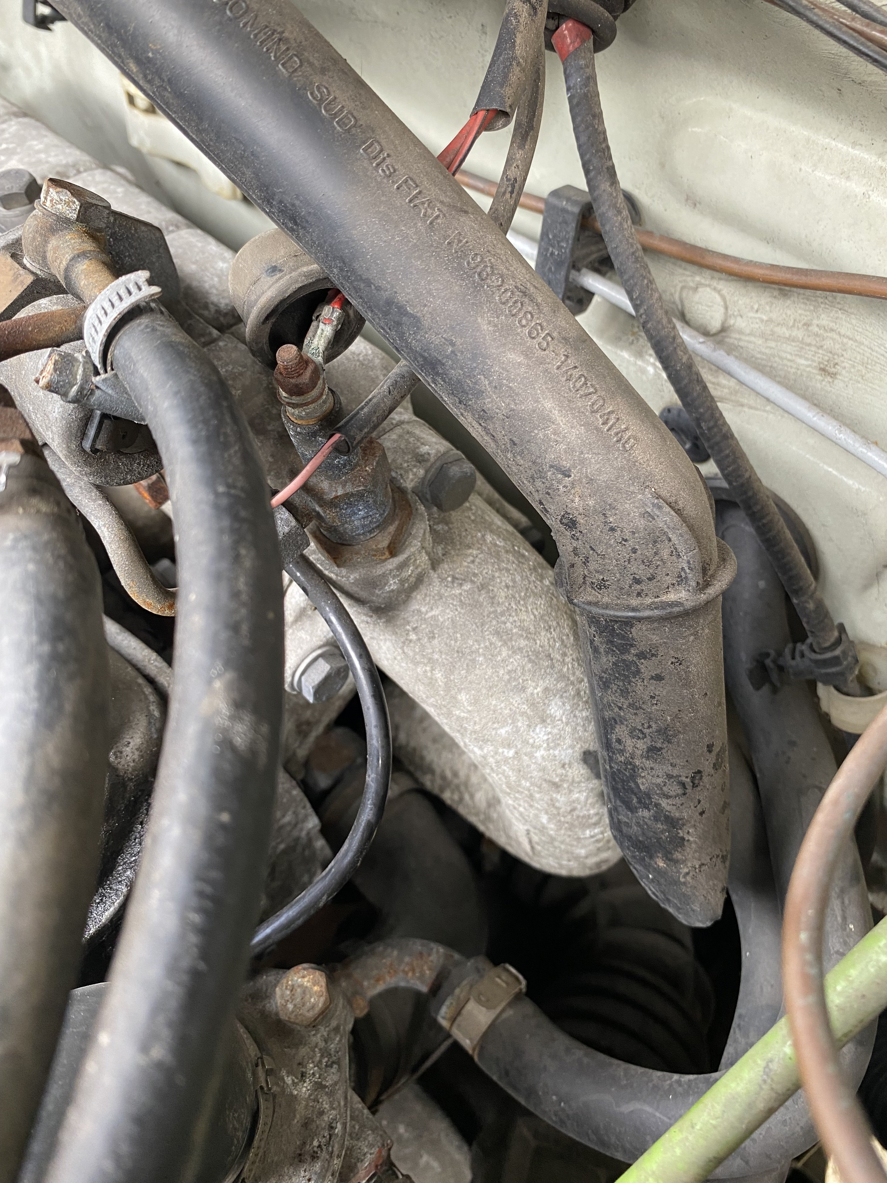

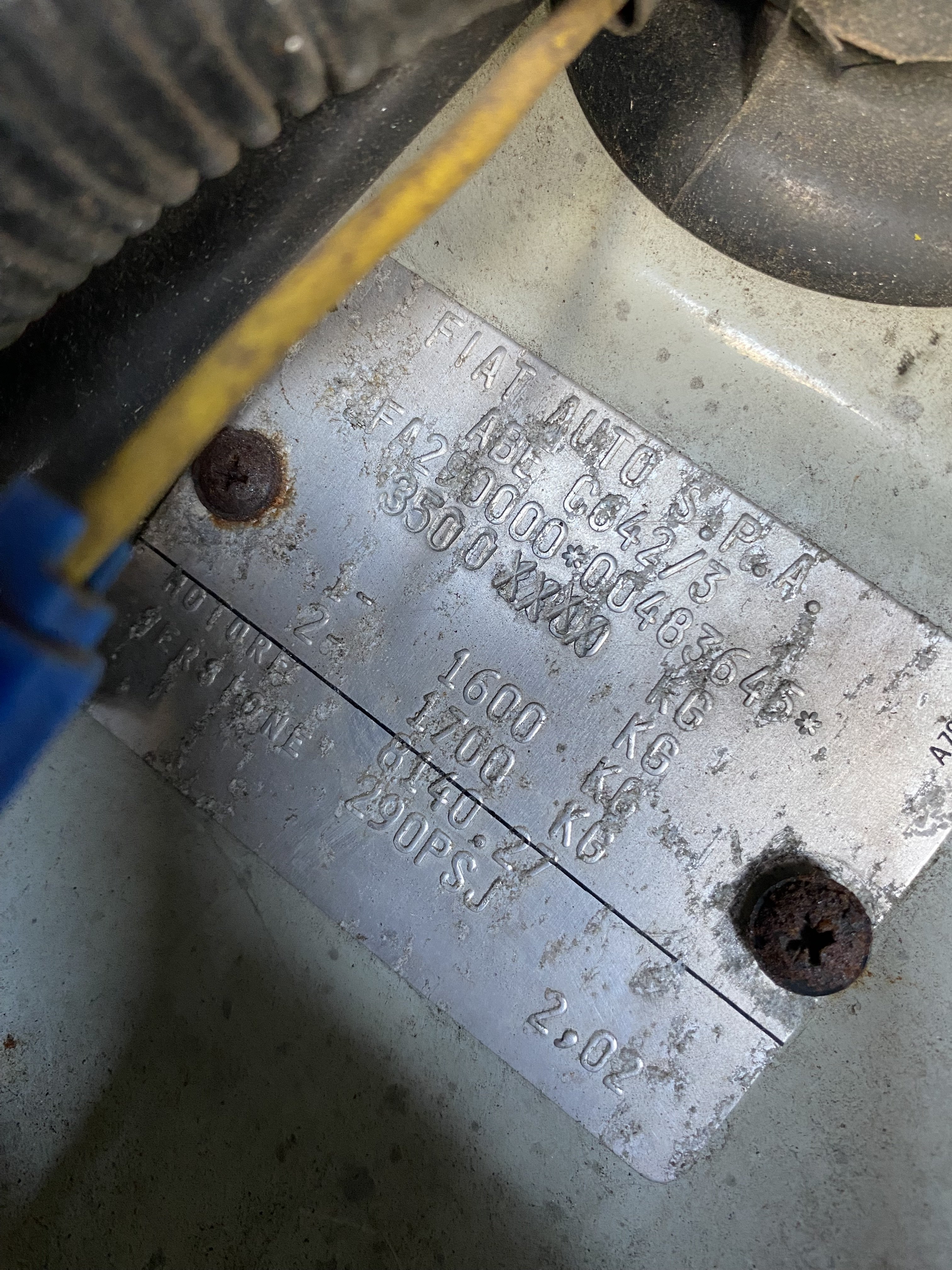

Hi Mike that’s exactly it it also had the flame start as opposed to glow plugs as I just discovered also just removed the thermostat seems to be working ok but I will replace regardless for peace of mind then it’s onto the temp gauge issue next
As @Communicator mentions, it sounds like the original fitting according to the Vin plate is the 2.5 turbo but not intercooled, however from what you say from previous owner and the fact you say it has the flame start device then more than likely previous owner fitted the later 2.8 engine.

I note the oil return hose from the turbo doesn't look shall we say quite "factory" installed. I trust it is suitable rubber for oil at high temp and not just old heater water hose?;)
It may also be an idea to see if the turbo actually spools up and delivers correct boost, assuming the turbo is in fair order and the actuator is not seized or diaphragm faulty (both common faults) although if no black smoke under load up hills with full throttle , then I I assume the turbo is working.

If the engine has been changed by a previous owner to a 2.8, then an 8140.23 is the most probable candodate. This has the same maximum power, and slightly higher torque than the original 8140.27. The 8140.23 is also a non intercooled turbo diesel.
Broken wastgate linkages are not unknown on these engines. In my experience, fitting an intercooler can noticeably improve the driving experience.. However with the turbo at the rear of the engine, some innovative pipework would be required.
