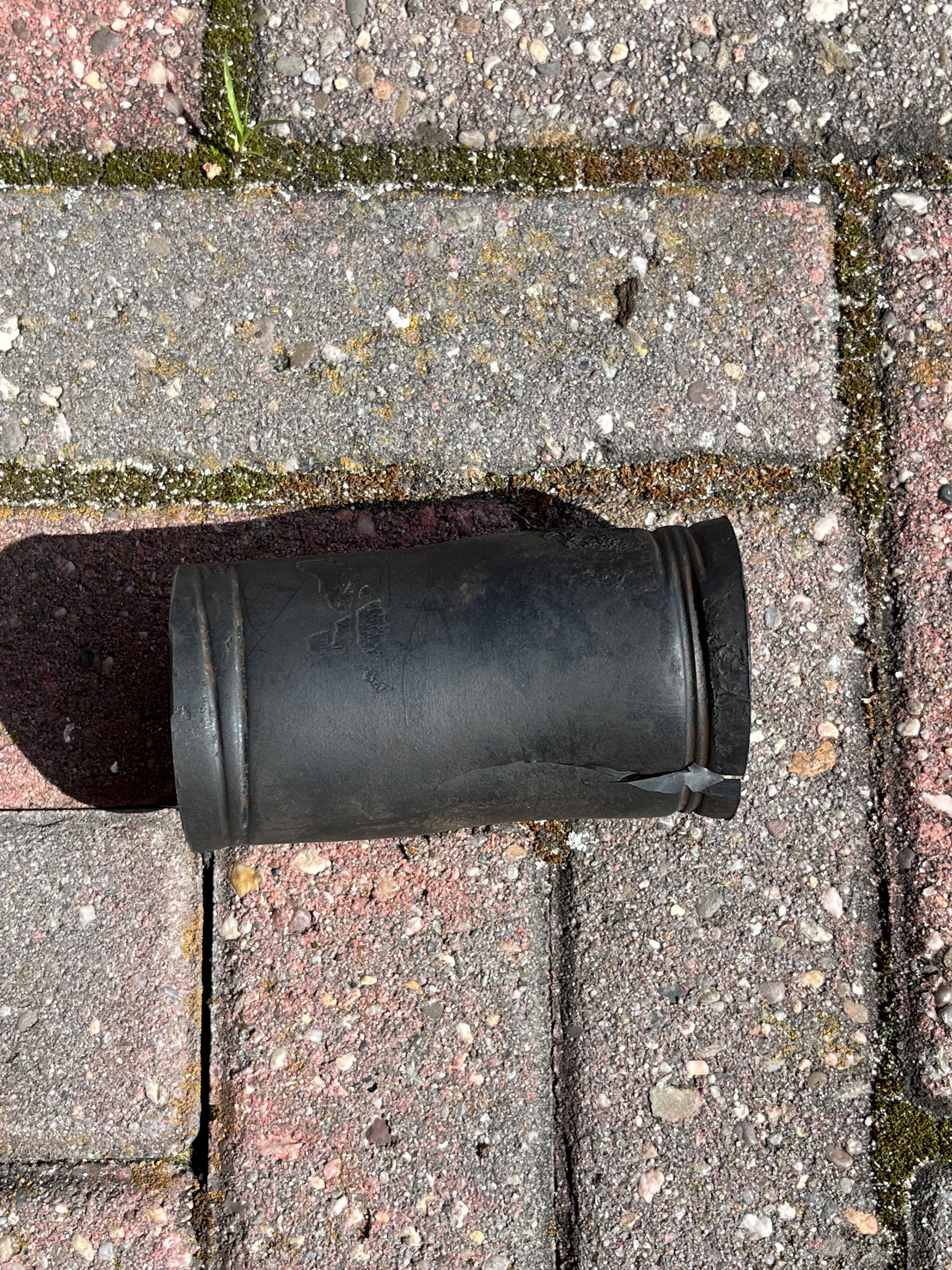

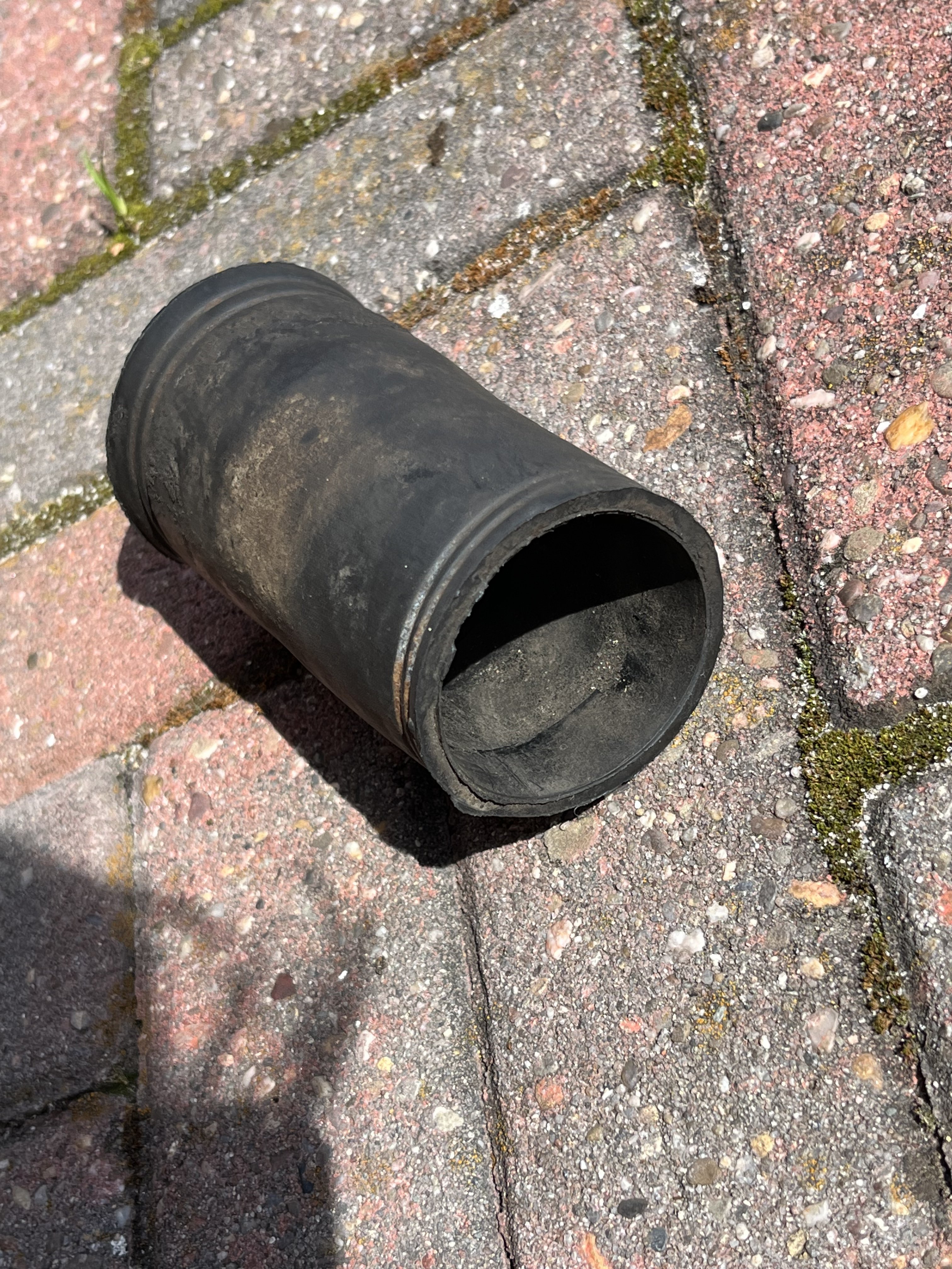

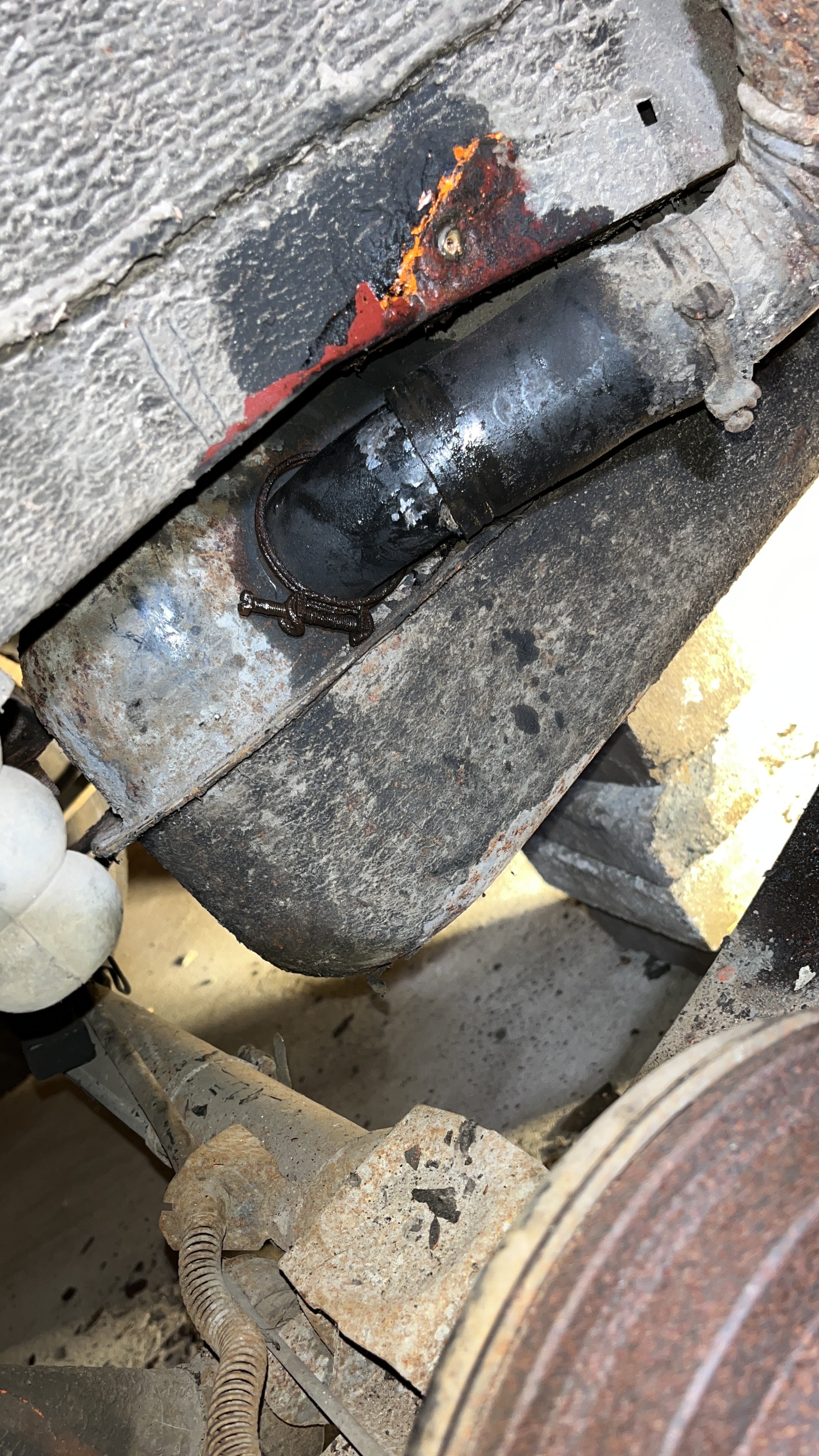

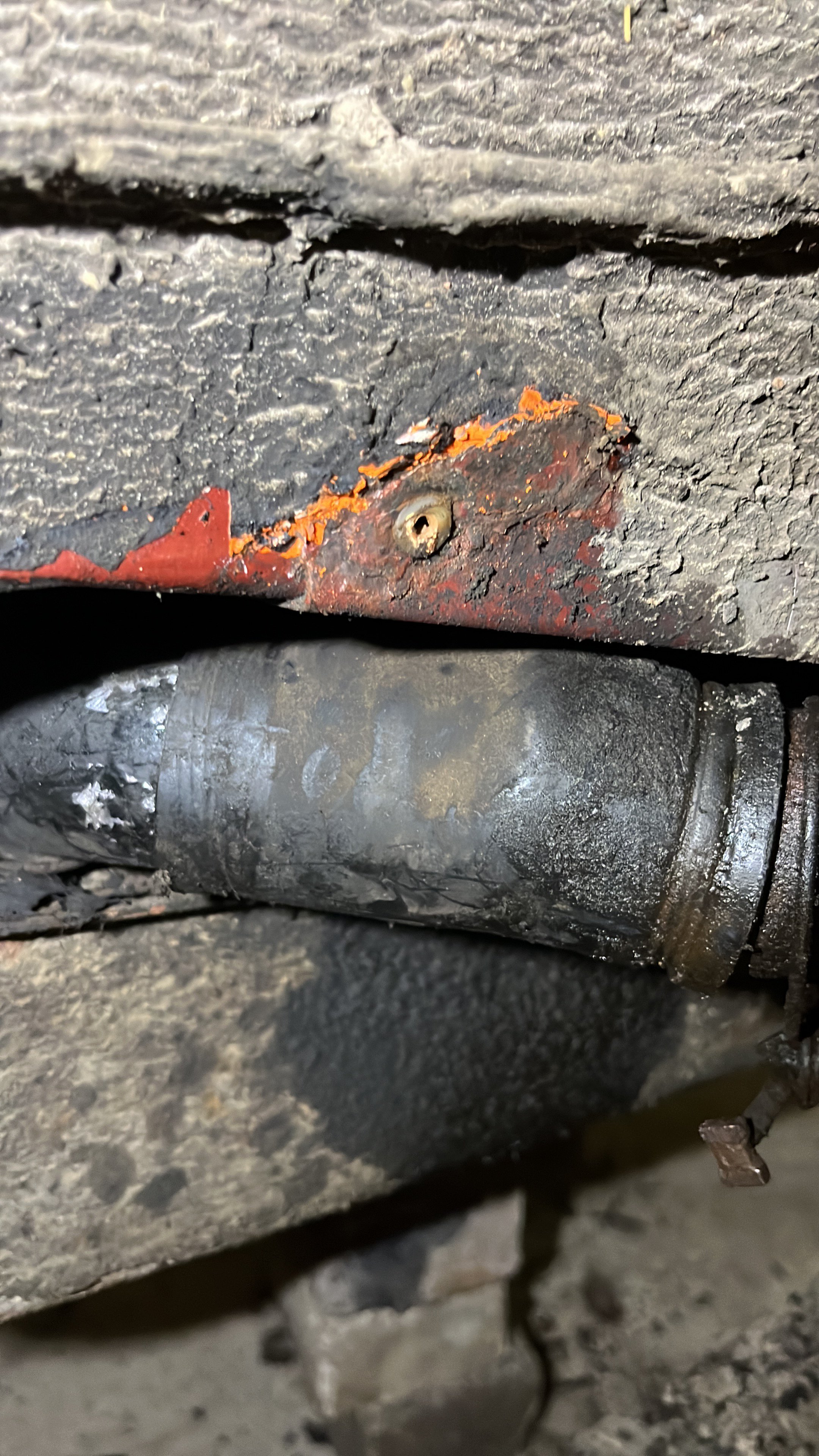

Hi there, this is my first time restoring a car up front. I have some technical experience, but its not necessarily mechanical experience.
I bought a 1985 Fiat Panda 4x2 (with the steel MK1 fuel tank). Unfortunately, everything seems shot and needs either fixing or replacing.
The fuel filler neck (all metal) I got out and got epoxy for to patch the smaller holes. Ill be soda blasting it. The fuel tank I found (expensive, 400+ euro) new alternatives for (but if any of you have one laying around let me know please!!!) and the hoses to the tank unit to the carb seem to be pretty standard fortunately, so I can get those easily.
Except one... the hose connecting the neck to the tank!!
It is 48mm inside diameter. I have gone to every local parts store, looked on this forum and evaluated the hose if it had a part number but it didn't. Its such a small but very important part since I cant properly use the car without it.
Im at a loss for where to look and how to find this part. It doesn't need to be 1:1, its not a part under pressure so I can hose clamp it down. It just needs to be fuel resistant for when the car is being filled and fit over both parts.
Any help would be very appreciated, thank you so much in advance!

You could go "overkill " and use the heavy duty thick steel braided rubber hose used for water cooled exhausts on boats, which comes in all sorts of diameters, the only thing is you will have to use Mykalor type clamps that you tighten with a spanner as jubilee clips would be useless.
Marine suppliers that deal with inboard water cooled engines should be able to help.
It usually comes in straight lengths and is not cheap, though you may find odd bits at boat jumbles.;)
I called them and just for future reference; the boat store I called offered to order it during the winter stop which saves a lot of money. Thankfully I shopped around a bit more and also online and found that certain old volkswagens also use a hose that appears to be the same size as the pandas, and it even comes in an extended length. It should arrive tomorrow so fingers crossed it fits! If it does I'll update the thread for future people struggling with this.
Allright! Good news everyone, the hose I ordered fits :). I think the diameter is maybe a bit smaller then the original but with a bit of handwork it squeezes on just fine. No tearing whatsoever.
Here is the link for future reference. Its actually used in retro volkswagens so hopefully avaliability should remain good:
VW part no's:
N90123501
311201219A
Do keep in mind that for the fillernecks with the flexible bits (e.g some 4x4's) there are still the proper parts avaliable. Just not for the all metal neck I have.
Thank you all so much for your help and please, feel free to use this thread now or later for any questions or info in regards to (rare) MK1 Panda fuel parts :)
