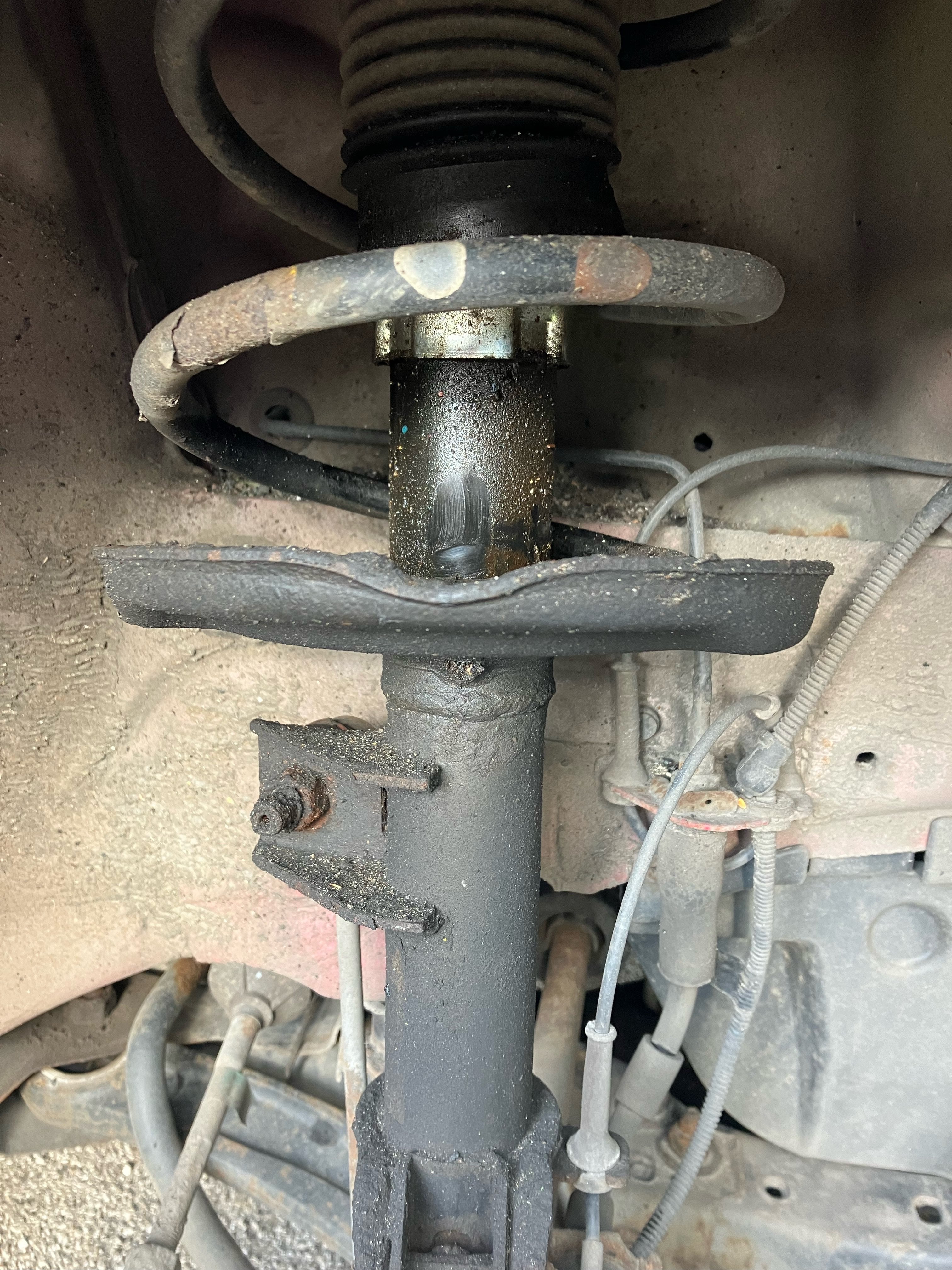

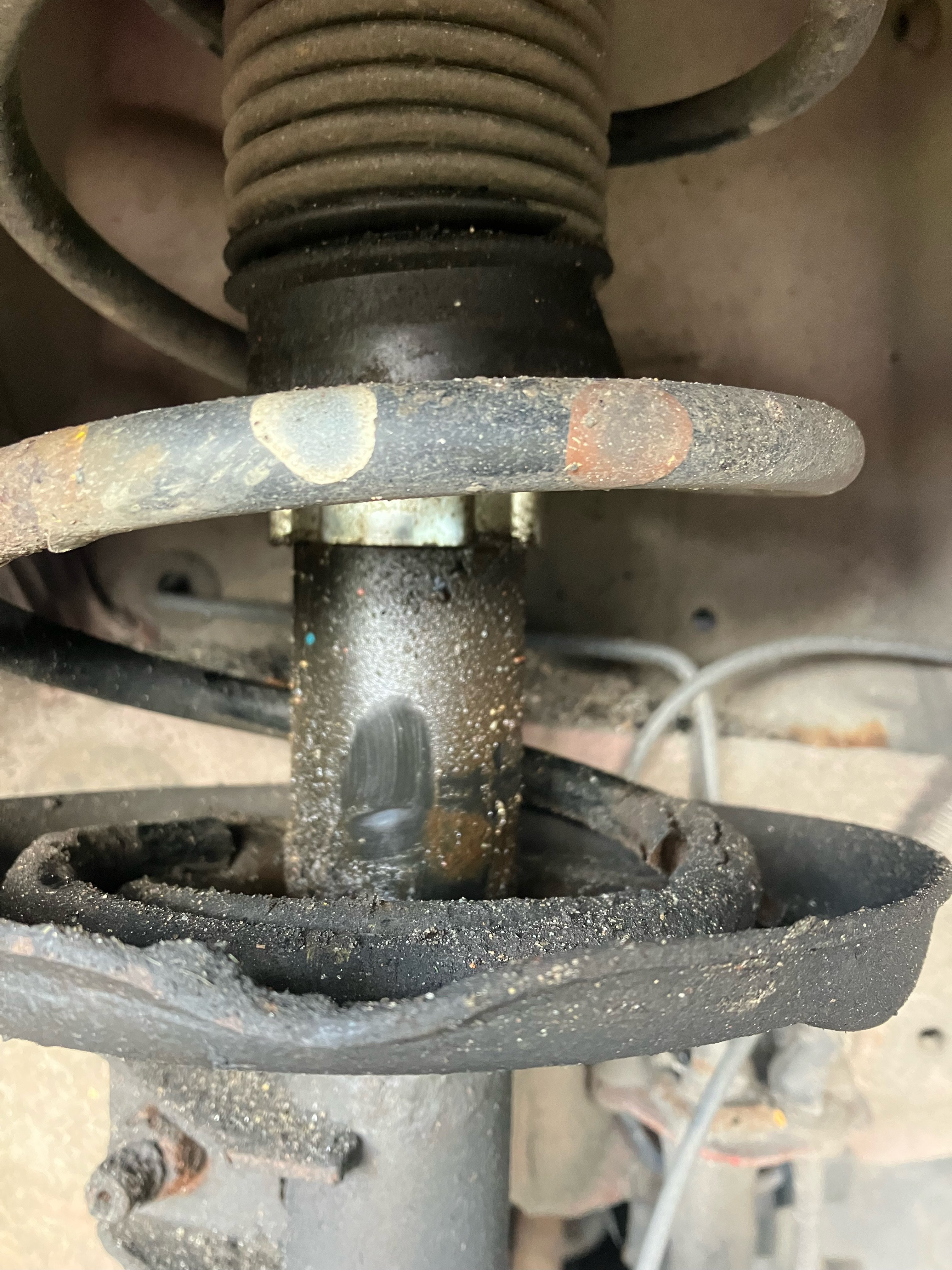

Hello Fiat friends - i gave my 500 TA 105 2014 51,000 miles a pre-MOT check over and found the front OSF drivers side damper is misting oil and leaking down the leg. So i'm going to refresh both sides springs and dampers. Does anyone have any recommendations please?
I think there is a bearing and a rubber damper too?

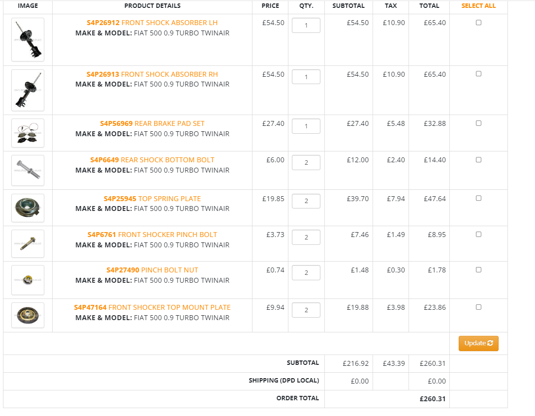

Heres my list of what i think i need (already done the wishbones and drop-links).

I would add drop links to that list by time you have the other removed an refitted they are likely to be worn even if you get them off without the nuts being sized
Note you need 4 lower shock bolts and nuts, I would add top mounting/bearing, Lemforder make, yes drop links, might aswell do shock dust covers too, you could clean up the top spring cups, the ones under the wing, and the whole hog new lower control arms

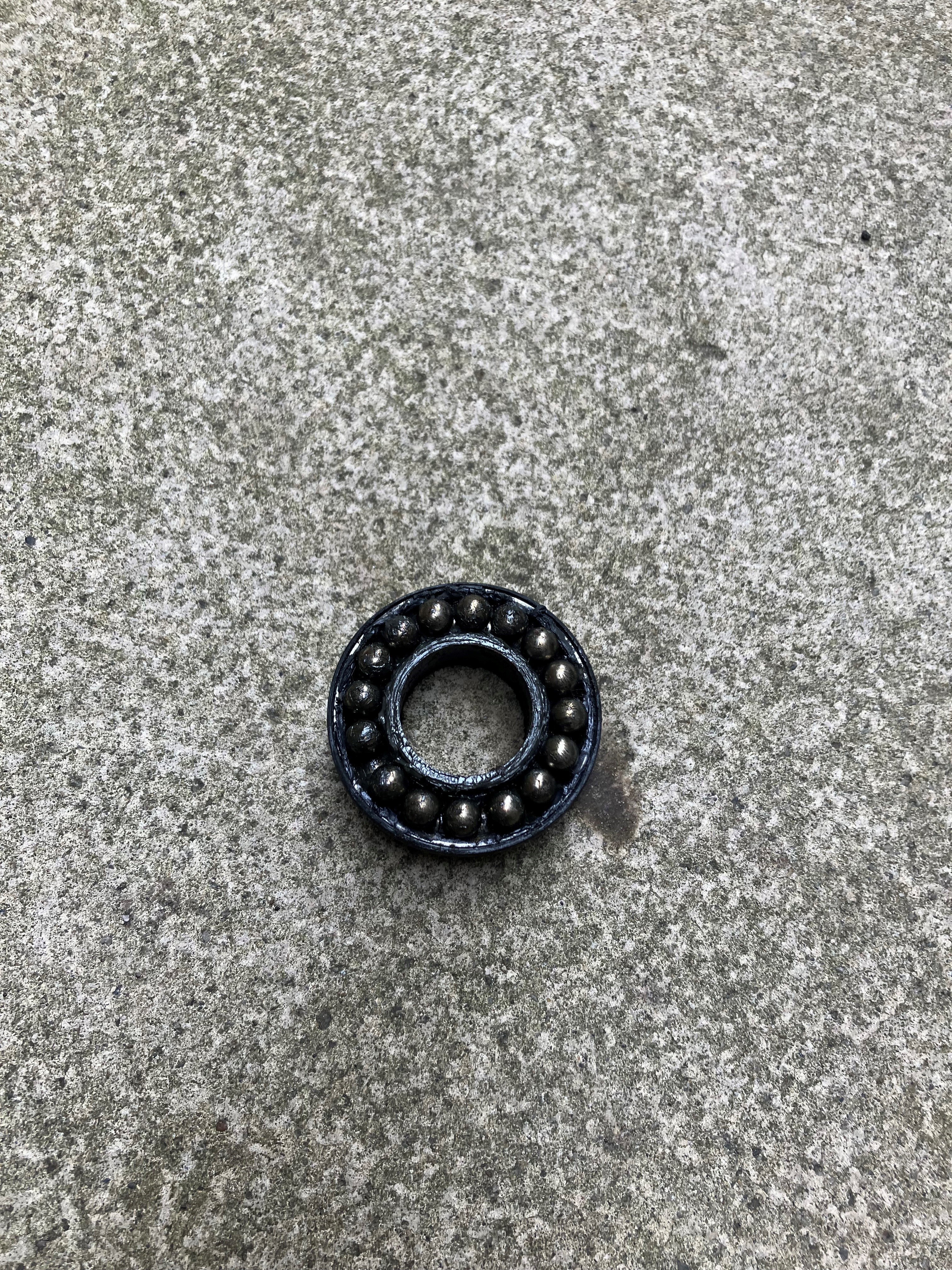

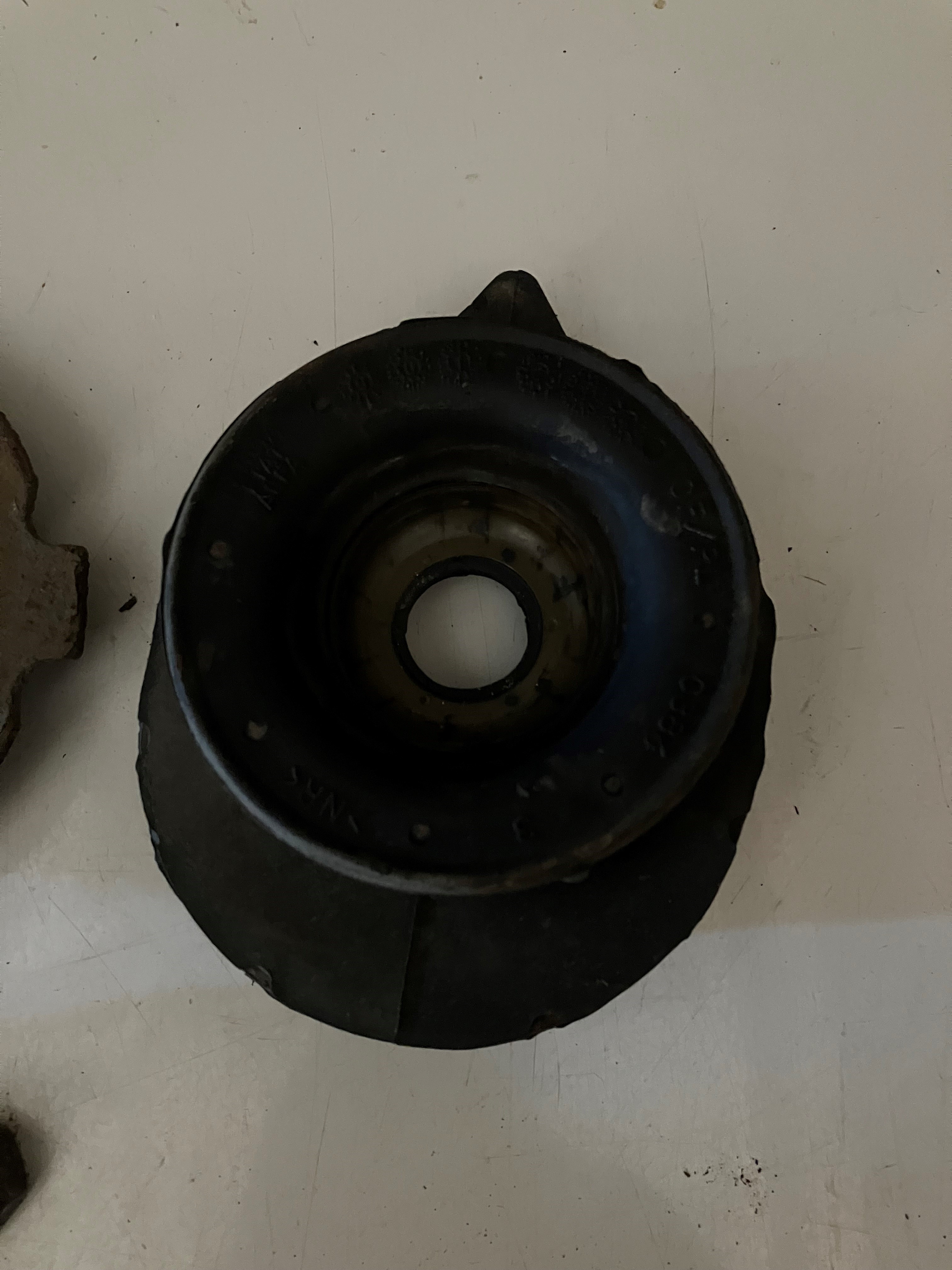

Update, i've refreshed the front suspension (re-used the springs) and it passed its MOT today. Whether it would have passed without the refresh i don't know because when i had a rear damper go all i got was an advisory for 'misting'. I've wanted to replace the front suspension for a while now and this was my prompt. Things to take away:
1. It was really easy, 2 bolts/nuts on the hub/carrier and 2 nuts on the damper stanchion for each side.
2. I applied PlusGas to the nuts/bolts 10 minutes before starting.
3. I didn't remove the plastic windscreen panel i just wedged it up to get my allen key and ring spanner in.
4. Hardest most boring part was winding the spring compressors in.
Looking at the pictures of the stuff i took off i probably didn't need to replace the spring-top cups as there is nothing wrong with them and i could have just cleaned them up. Same for the rubber damper as they look in good condition. The bearing fell a part but i'm not sure it is a closed part. The top cups where the water pools were really rusty. In hindsight i would only have replaced the damper, bearing and top cup on each side. Even the bolts i took out of the hub carrier are ok.
