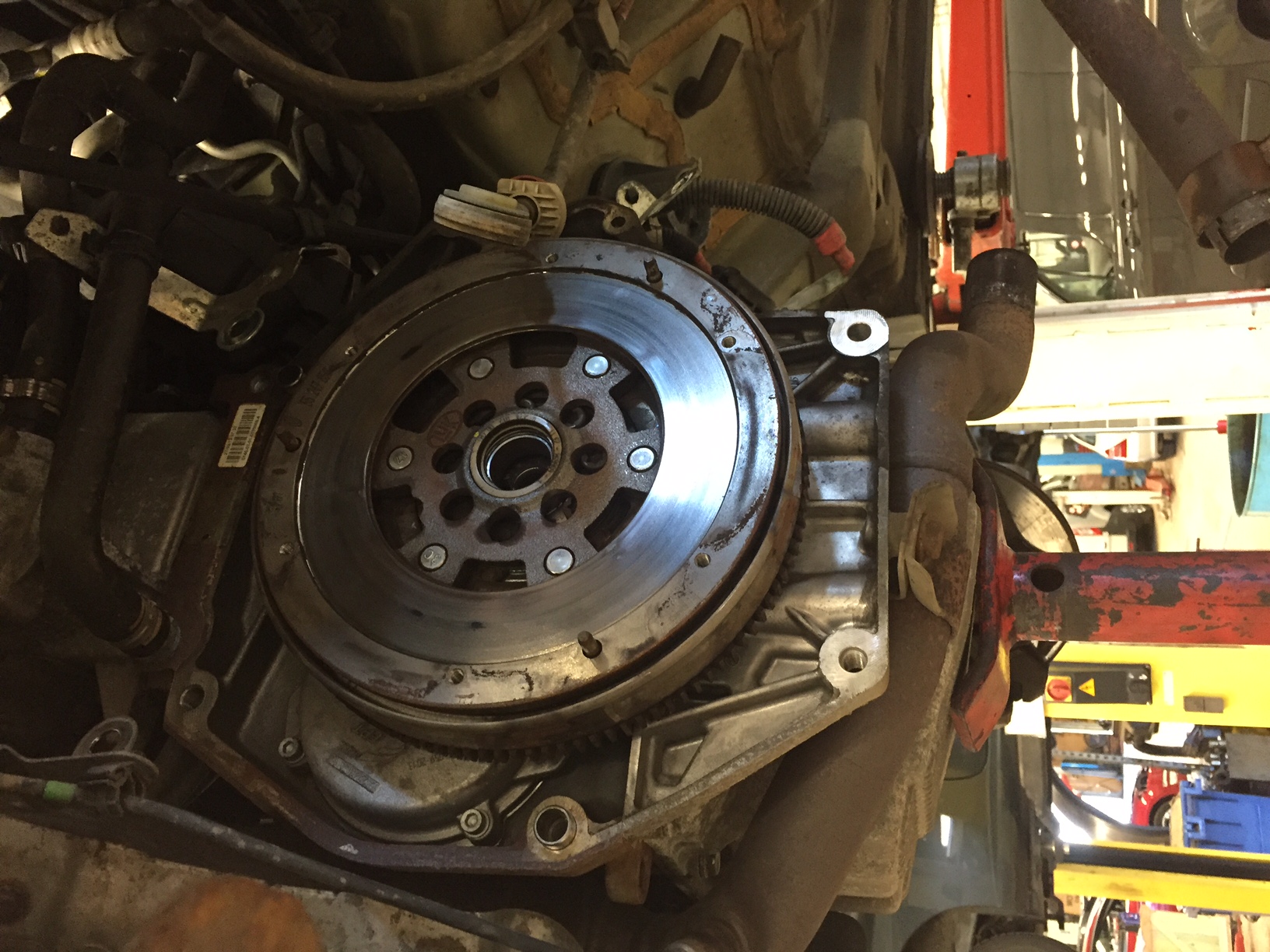

Can you post some pictures of the 'broken' flywheel.

It is important that the cause of failure is diagnosed. Anyone can point at broken bits but identifying what wore/broke first is more difficult. Get some good clear pics, of all the affected parts, we may be able to help.

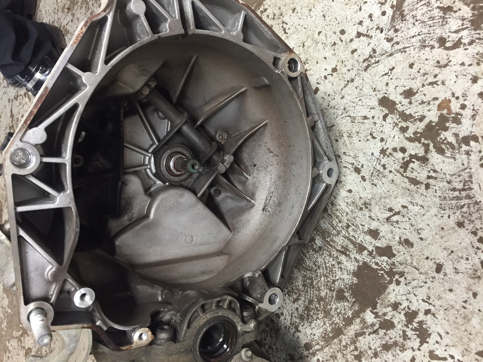

The guide for the release bearing gets chewed up by the flywheel failure. Seen it on a raft of MiTo twin airs. Parts list is bellhousing, input shaft seal, both driveshaft seals, clutch release arm plastic guides (top and bottom).
It takes around 50 mins to pull the box from a mito, takes longer in the panda due to the subframe design. If you know a decent engineer or machine shop, they may be able to manufacture and fit a new guide, but Fiat don't sell them, have to buy complete bellhousing and strip a rebuild the box.

A solid flywheel distortions wouldn't require gearbox repairs or replacement either, so this car has a dmf (for some unverified reason) or the garage is going off previous experience and trying to get more of a job out of it. The centre bearing of the dmf collapses which causes the guide wear, a single plate fly couldn't do that as it has no bearing

Have been to see car in current state. Attached photos of bell housing and flywheel which is a dual mass flywheel.
Mechanic said this is wear and tear and is known on this model panda. So I will be pursuing fiat to treat as though under warranty.
