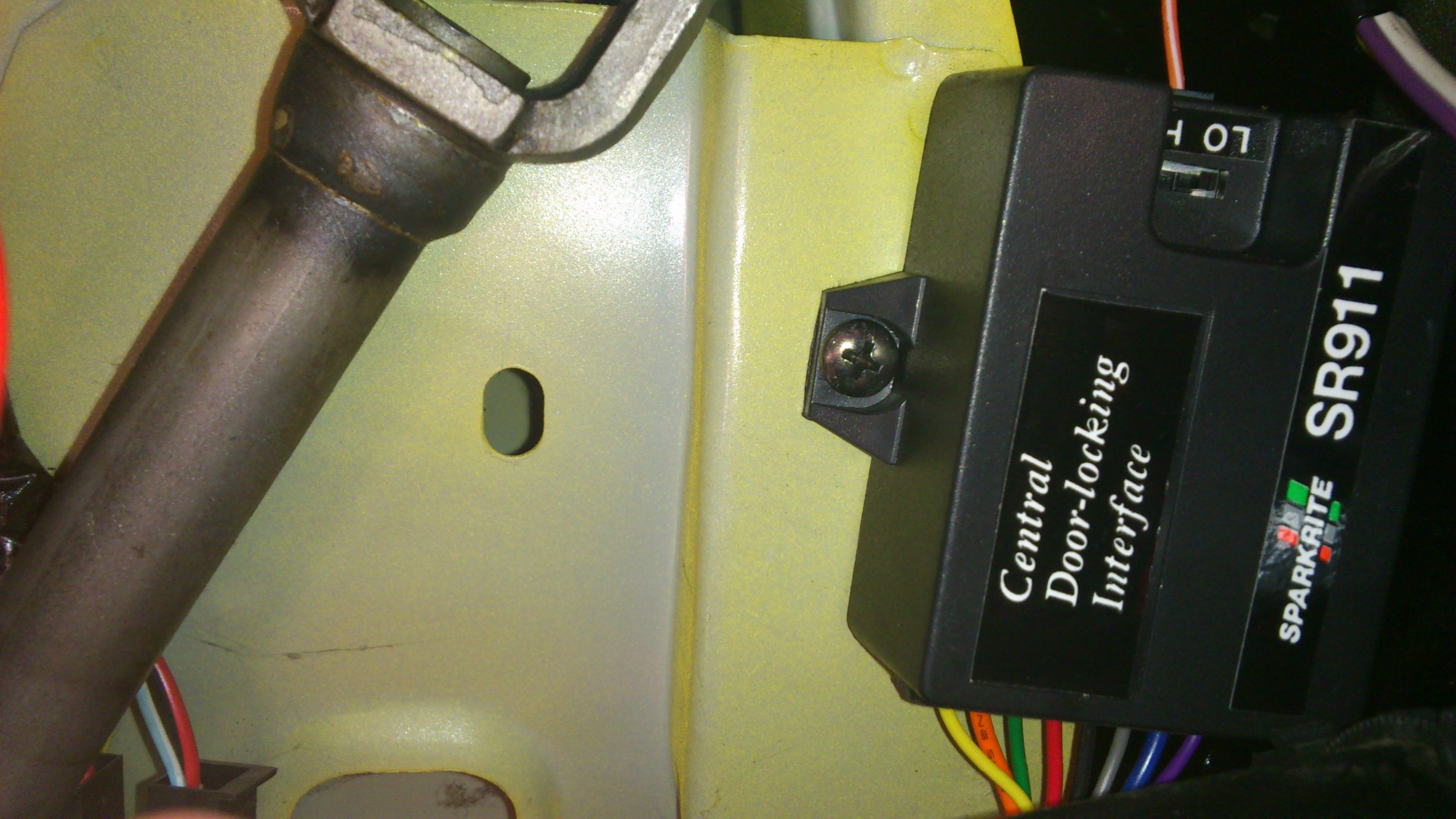

Once I’d bought the alarm I found out another annoyance: the output for the central locking is apparently insufficient to activate it directly. So I had to look for an interface box. Ultrascan’s version, part number AN0012, is no longer available. Further research unearthed information on the Sparkrite SR-911, and the fitting instructions seemed very similar to Microscan’s. So I took a chance and bought a new unit I found on eBay (another£21 + P&P). This I have now got and wired up, and happily it works! I mounted the box on the steering column bracket, like this...
...more or less behind the fusebox. The lock/unlock wires were taken to the central locking control unit (the white/yellow and blue/red wires) which is fitted very inaccessibly underneath the dash, behind the document tray. In order to get better access to it, I unscrewed its bracket from the document tray, and unscrewed and removed the tray itself (also the clutch cable/ linkage cover).
