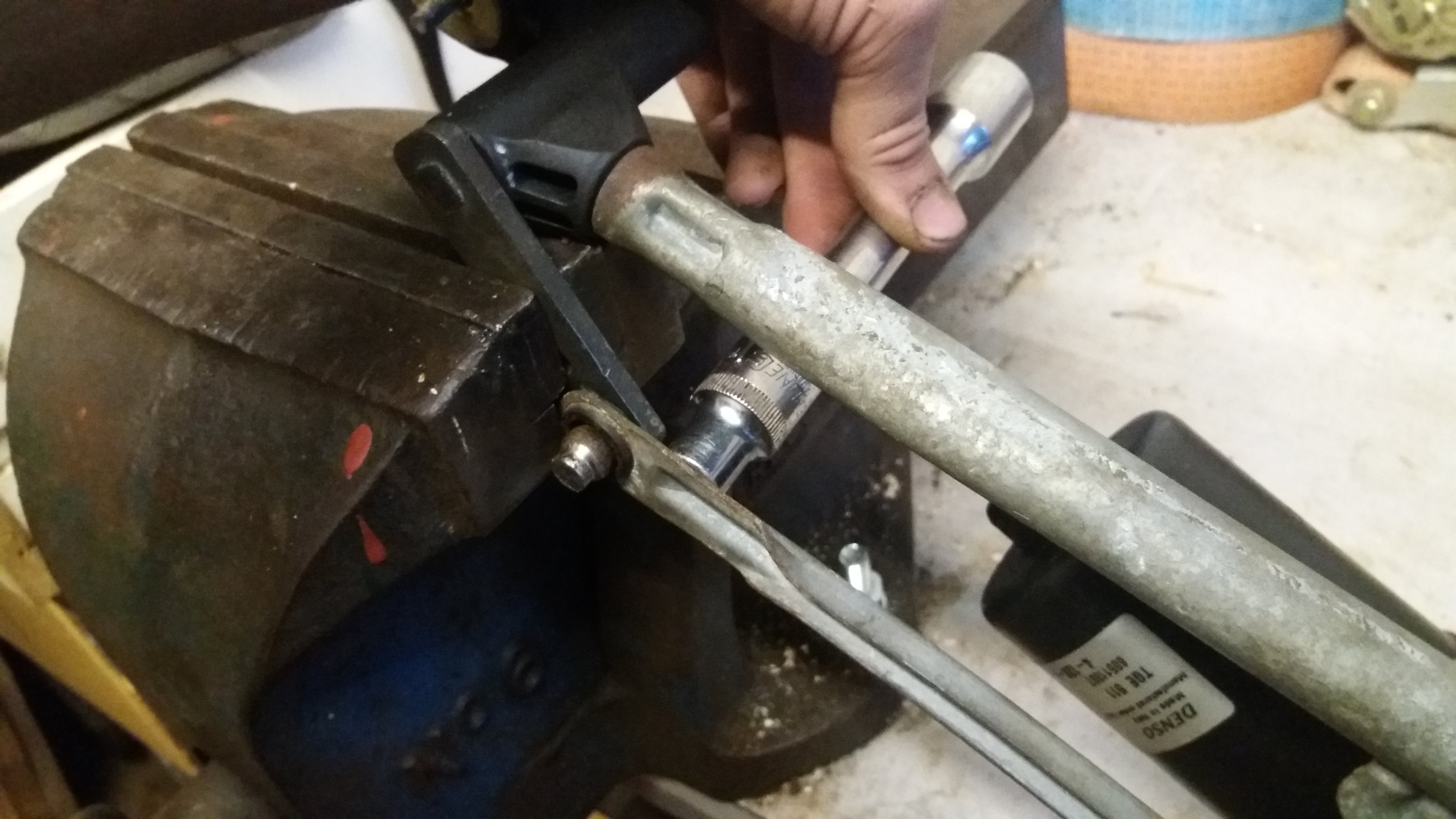

6. Take the linkage and place it in a vice gripping it the metal arms with the metal balls on the end. I found this the easiest way to remove the linkage bars.
7.Take a suitable drift or object to hammer the bar of the ball socket. You may have to improvise with a pry bar or something for the ones connecting to the motor.
