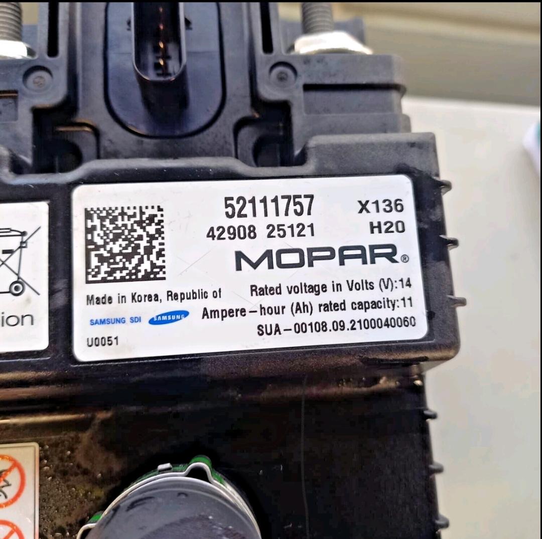

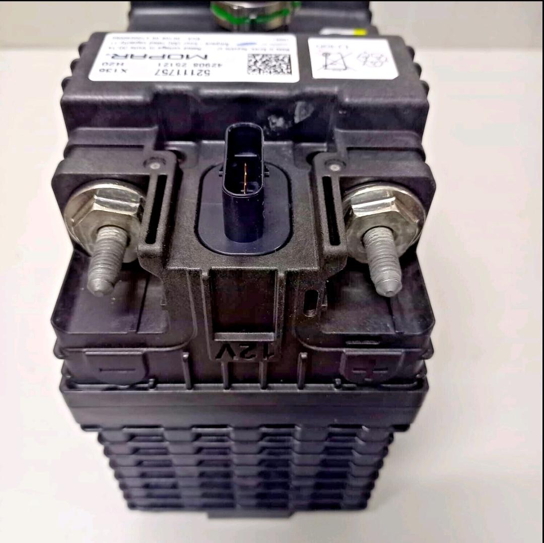

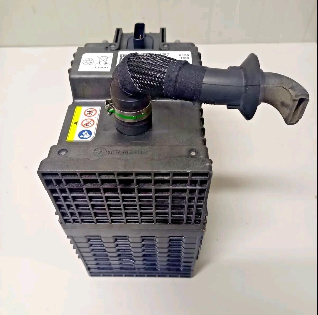

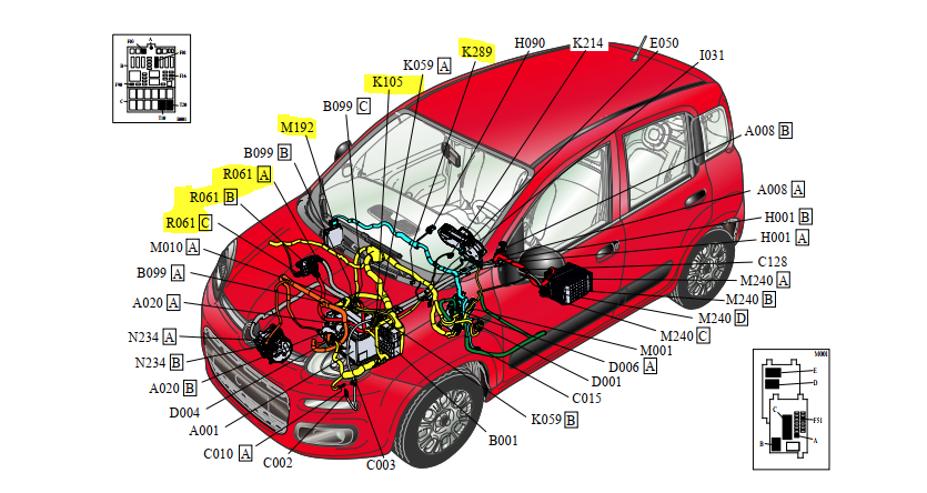

For future reference if anyone ever needs to replace service the Hybrid Battery I am attaching some useful pictures. The battery is air cooled from the cabin no filter no fan just a vent and is also engine coolant cooled and has 2 connections 1 for water and 1 5prongs for electricity. The MOPAR Battery is built by Samsung SDI and you can remove it yourself without high voltage risk (not more risky than the 12 Volt Battery in the engine bay sitting at 14 Volts full). The battery is NCM Nickel Cobalt Manganese

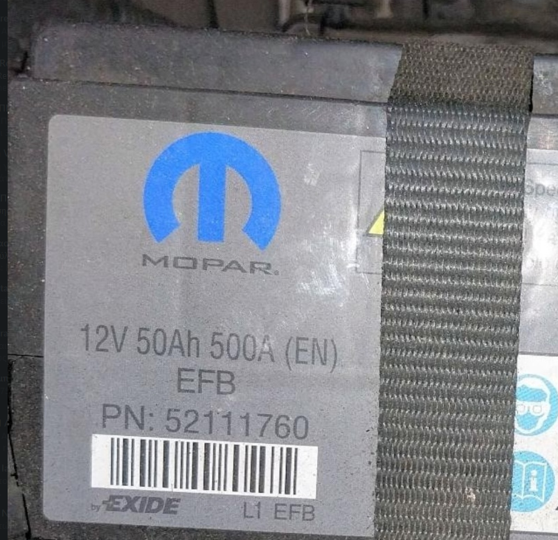

The original 12 Volt battery under the Bonnet is MOPAR made by EXIDE 12Volt 50 Ah 500A (EN) EFB PN:52111760 L1 EFB Battery. The original battery sells for over 250 EUR from the Dealership in Greece. EXIDE does not offer under its brand any battery that is close to the Capacity AH or the Amperage.
If you need to change the battery you can NOT use BOSH AGM 60AH battery with more Amperage the car will not start as the Magnet Marelli ECU does not allow.
The only after market battery option that works better than the original and goes bad after double the times sitting in the car is a battery from Japanese Maker YUASA. You can use this battery (model name varies but it is the same battery worldwide) that has the same Amperage and the same capacity or it advertises as a little smaller capacity ie 450 AH or 455 or 459 AH. It is exactly the same battery and all of them work and start the car.

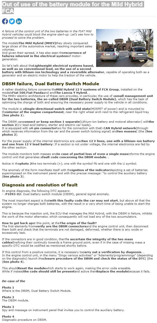

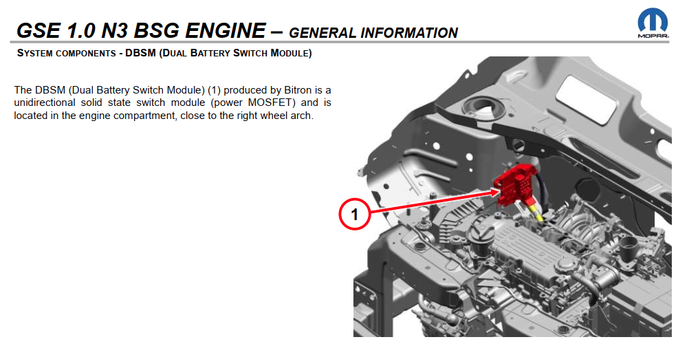

Focus here. This module in connected on the negative pole of the 12Volt battery. It is made from MOPAR not FIAT and is made in ROMANIA not Italy.
This module C861 does 3 things.
1. It is a Voltage Regulator Balancer (protection)
2. It is the "sender" unit ie it reports to the OBD port the battery Level of the 12 Volt Battery. If it reports 50% or less and specifically 48,6% then this Unit will do set the Stop Start, Mild Hybrid battery Charging, Regenerative Braking Offline.
3. It protects the battery and car electronics when jump starting this Car or another car. When giving Power to the Panda DO NOT connect to the negative Pole but on another metal not painted part

For example the Factory Installed battery is MOPAR made by Exide EFB Model L1 PN:52111760 12Volt 50 AH 500A(EN standard) this has 500A CCA cranking power
This battery costs 180 EURO new and it will last maximum 3 Years. It has actually been discontinued by Exide and there is a new model
The new Model L2 is Exide EFB 55AH 550 540A (EN Standard) this is the same battery but an enhanced model ie it is same dimensions but 5AH more
It has a higher cranking power of 540 A than 500A previously. It uses some king of Fossil Carbon Boost Tech to protect itself from degradation (could be marketing it is definitely a little less in weight)
So you go out you buy a brand new battery and then you need an official Fiat, FCA OBD and a laptop to declare the battery as new
(new model costs around 110 euro new with VAT 24% in Greece - including the 30 euro discount for giving your old battery at the point of sale for recycling)

It is my opinion that all Problems regarding Stop Start for the Mild Hybrid Fiat Panda 2021-2027 models start & end with the Sender Unit pictured below.
Without this the car will not work and you can only find order this car from any FCA dealerhip (does not have to be Fiat) as it is used in multiple cars.
After discussions with Service Gurus in Greece and trained stuff ex Fiat there were problems with the Fiat 500, Fiat Panda 2013-2014, Fiat Tipo and the Ducato and Doblo with this Sender Unit.
I higly recommend to all Owners to get your hands on 3-4 of the Sender Units and keep in Storage for Future use.

The EFB Battery is perfectly capable to Start and Stop the engine even at 35% charge level or even at 40% AH capacity...
They did not have to do this ie set the Stop Start System offline.
They have the Mild Hybrid Battery Start & Stop the car and not EFB Battery which is okay but both batteries could be working together and charging each other if necessary ..
The sender Unit will not allow the Vehicle to work with a NON Start Stop EFB battery.
Other makers WINNER & Yuasa also work so you dont have to go with EXCIDE if you don't want to.
There is no Chip reporting as a MOPAR "genuine" factory or Fiat battery.. the Stupid Module ONLY measures Voltage & Amper and runs diagnostics and keeps stats... but does not do this LIVE but on a periodic cycle ie keeps the values for 8-15 hours.

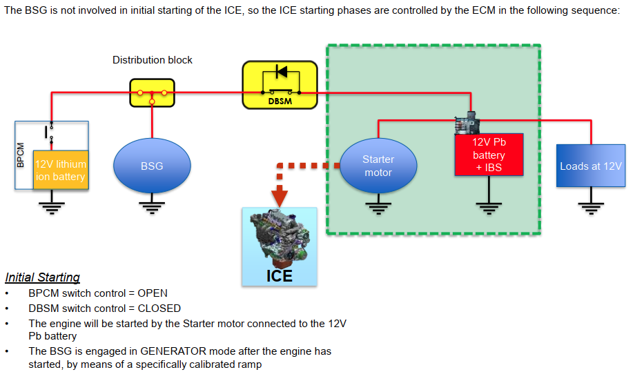

IF your symptoms are the Following: Switch on the Car, the car works perfectly and after 10-15-20 minutes of driving you LOOSE all blocks showing battery charge level in the instrument panel (Mild Hybrid Battery)
AND you have no regen braking, no battery charging, no start-stop etc. You have no engine light or battery light indication no nothing at the instrument panel
If you lock the car and leave it for 2-4 hours or overnight the next day everything works perfectly for about 15-20 minutes.
THEN
if you plug in to original from maker Fiat OBD Scanner or after market multiecuscan you will get the infamous
P1093-02 Dual Battery Switch Module (DBSM)
I am attaching here a link with more information
https://www.notiziariomotoristico.c...so-del-modulo-batteria-per-il-mild-hybrid-fca (Notice)

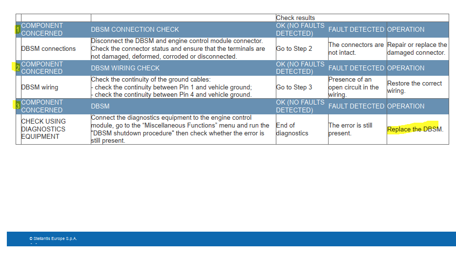

Troubleshoot guide for this Error is this :
As you see the DBSM Module is located about opposite of the battery at the passenger side inside the boot behind the Water Bottle.
The function of this module is to receive 2 wires with 12 Volts each. The module checks which battery has less charge and charged this Battery.
WHEN this module fails you will soon be left without power because after the 10-15-20 minutes of normal working condition the module stops charging both batteries.
How to check this DBSM Module a How to and more information to help you understand truly how the Mild Hybrid System works
Original Article in Italian translated to Engish with Chat GDP 2.0 (older version - not excellent translation)
IF the DBSM Fails you are on the RED Zone here
In this picture R061 is the DBSM Dual Battery Switch Module
K289 is the brake pedal position sensor
K105 is the Brake Servo Vacuum
M192 is the Voltage Stabilizer (pictured in previous post above) and is connected to the negative pole of the 12 Volt Pb Battery.
These sensors have to be checked measured by a automotive electrician that are working within parameters and spec before reaching the conclusion that the DBSM is at fault.
However in most cases expect to find it at fault.
The Mild Hybrid Battery under the drivers seat can also fail.
Replacement Parts for the infamous DBSM : 52181596 or equivalent 52216842<- this is better
