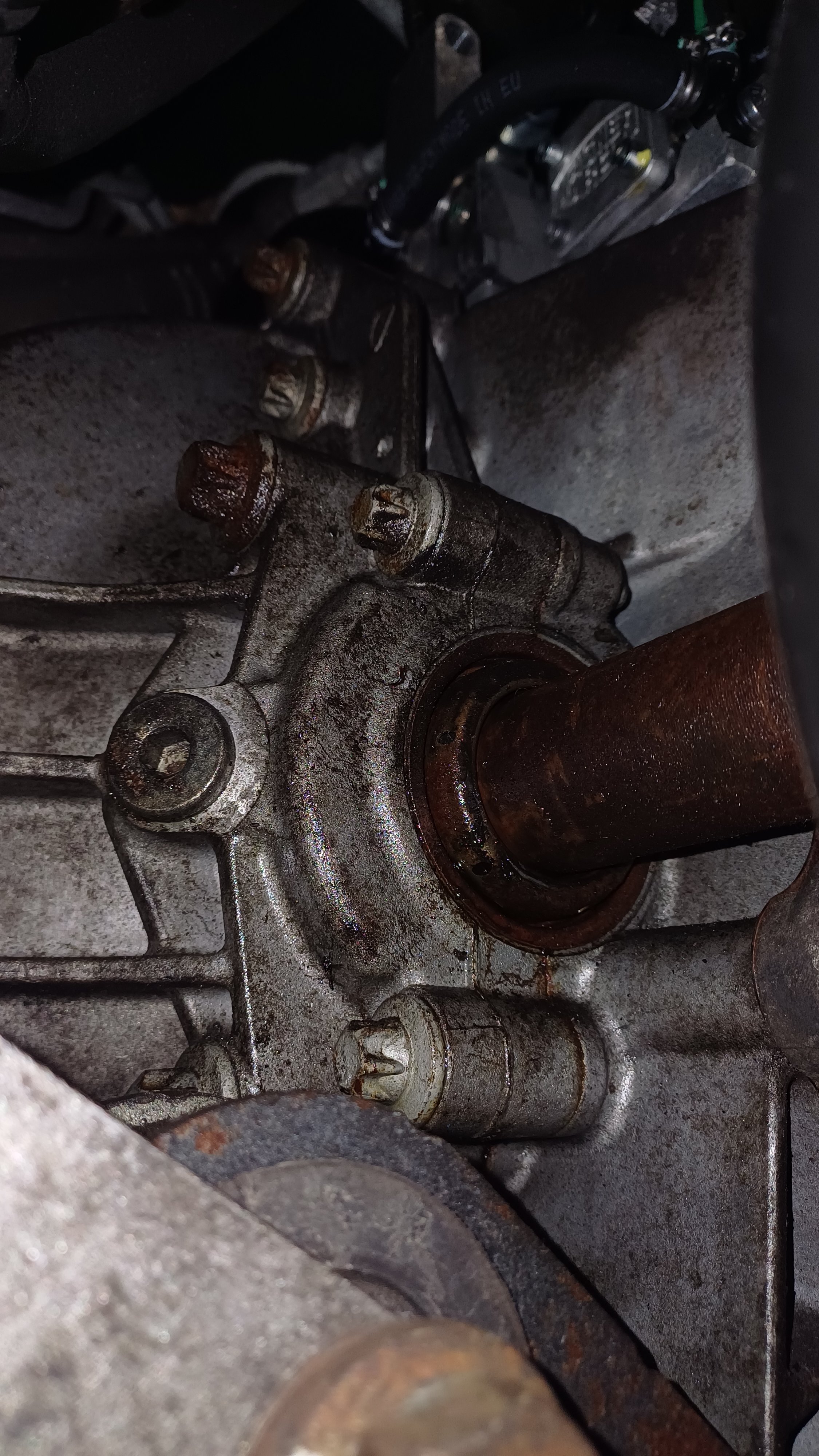

Good afternoon,
Got a question, Can anyone provide me with an exploded view drawing of the gearbox of an ducato 250 multijet 3.0 ? One of the oilrings is leaking and I'd like to know if it's possible to replace the ring without having to dismantle the entire gearbox. So.... a technical drawing will provide me with information to determine of it will be possible to pull out the shaft and somehow replace the oilring from 'the outside'. I know the shaft will probably have to be fitted with "jackets" also because of the wearing throught the years

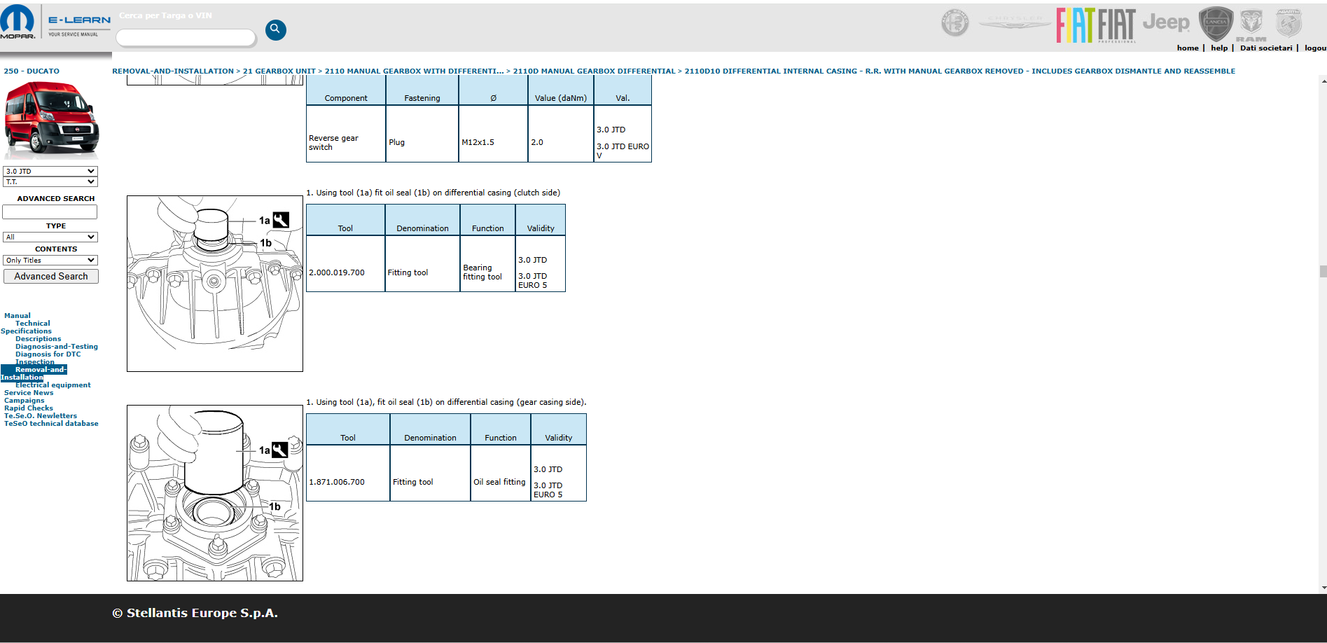

With the driveshafts removed it is possible to fit new seals to the differential housing without dismantling the gearbox, subject to having good enough access to drive the seals in squarely. The eLearn manual available under the downloads section above shows this as being the way to do it after a gearbox rebuild. See attached screenshot.
