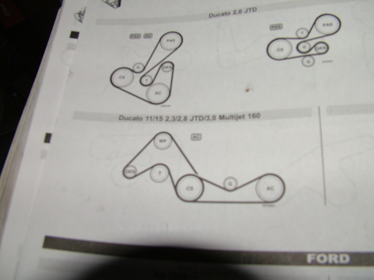

Incidentally this may be wrong but I can only find one photo of the serpentine belt for the 2.8 JTD in my manual, it doesn't show a pulley driven pas pump. This would tie in with my experiences on many Sofim 2.8 engines mostly but not exclusively in Iveco Daily's where they use the cam belt driven PAS drive unit on the side of the engine which also powers the diesel high pressure/injector pump and the brake vacuum unit etc.

Sorry about photo quality.
