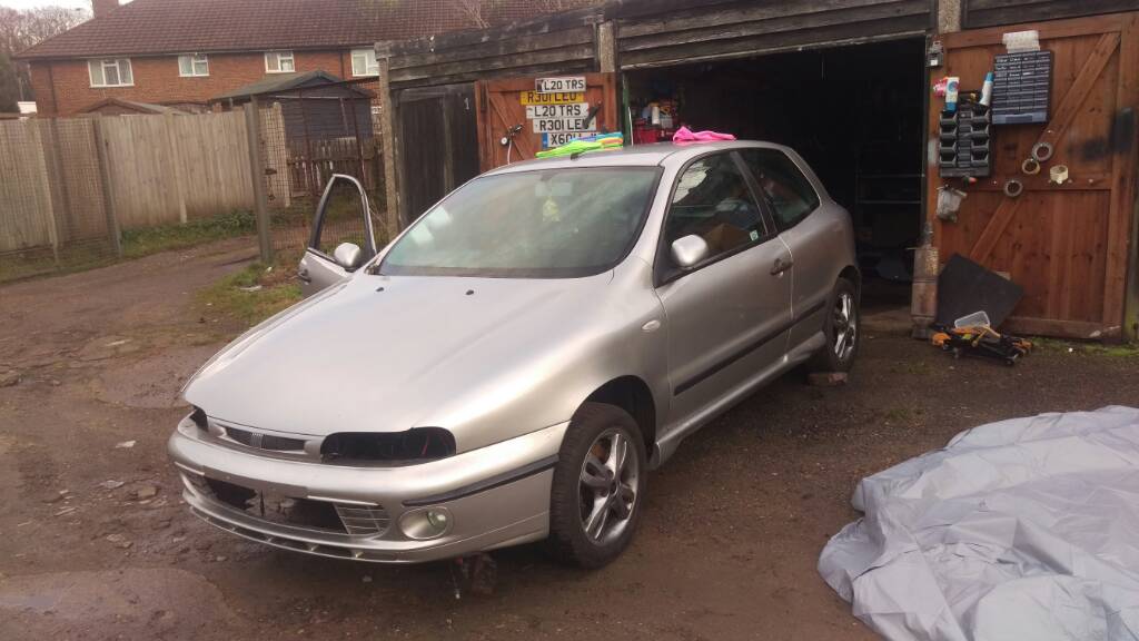

Yes still on old subframe as the time I got of work to swap them was taken up by the gearbox conversion
The suspension on the drivers side collapsed on Sunday taking the drivers wing and abit of the side skirt,
They are both abit tatty so rather than just replace one I'm going to replace both then get the whole front end painted apart fro. The bumper as that at the bodyshop already

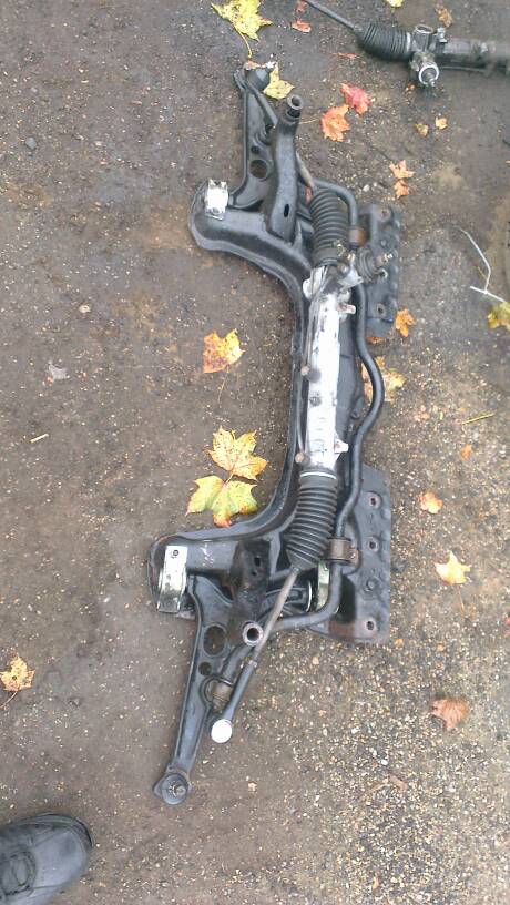

Bought a 20vt steering rack and had it completely refurbished even sandblasted the body
It very darty now but a 3 point turn is now a 20 point turn lol

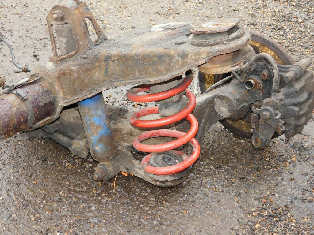

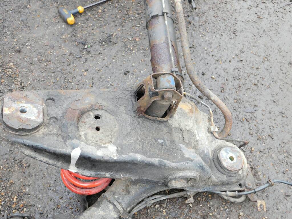

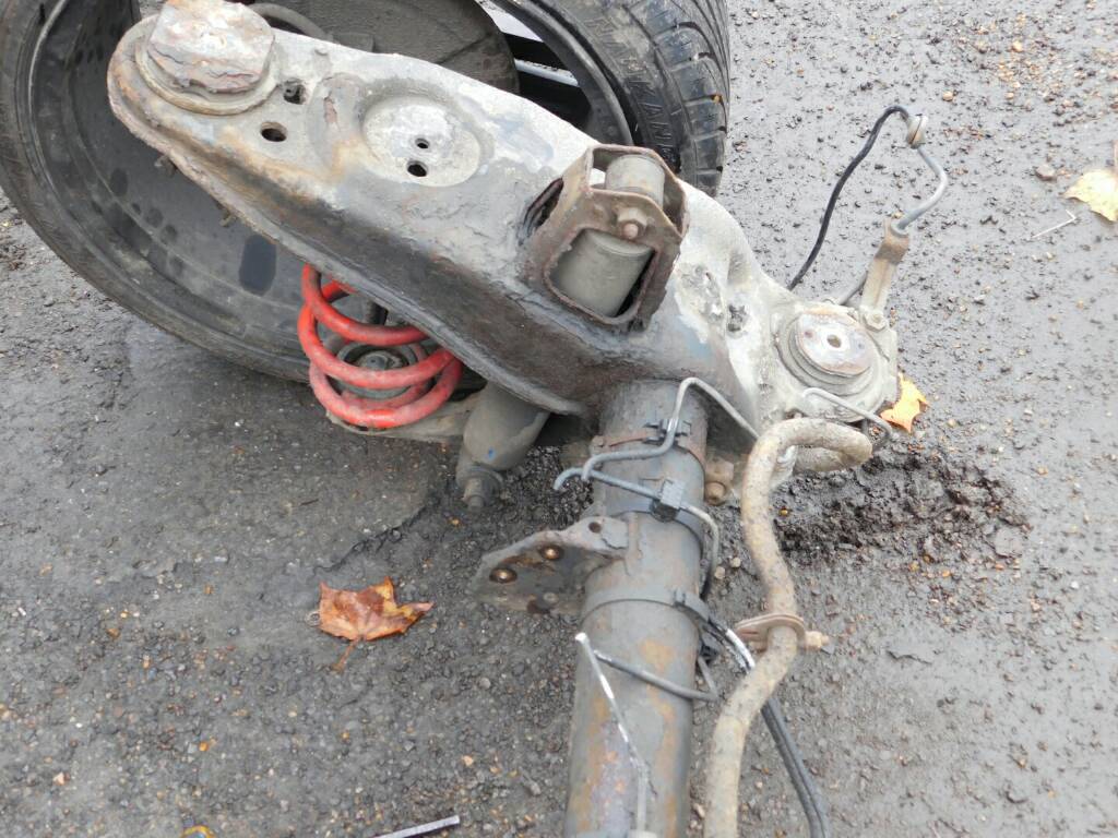

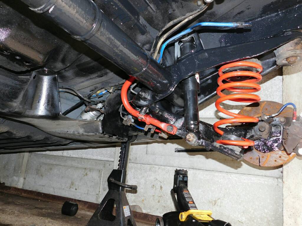

Well rear subframe finally fitted
Old one is in very poor condition

Looks like good progress, I'd love to have a tidy back end like that. I'm sure my Brava must be quite like yours was underneath - maybe I've had a go at rustproofing but I'm sure the subframe needs dropping, cleaning and new mounting bushes.
Is it all fairly straightforward to do? I suppose pressing in the bushes would be a bit of effort (couldn't do the whole job myself so would use my mechanic..)
The frame I got had recently had new bushes so I didn't have to worry as it looks really tight
The rest of the job is straight forward
Just dropped the tank undid the four mounting bolts and down it came :D
haha i love the easy version! :rolleyes:
for us mere mortals, to do this for a for a daily driver, this is somewhat more involved! i imagine a stripped down version of events would go something like this, take off back half of the exhaust from the catalytic converter, secure brake hydraulics and remove flexibles' from subframe, remove handbrake lines, ABS sensors, rummage in boot to remove the carpet (which is screwed down in the weekend), fold down back seats flat, unscrew fuel tank access cap, undo fuel lines and electrics from tank, (possibly siphon fuel out from the tank first) release the holding straps from tank, drop tank, and after all that (and maybe more) you at last, have access to the subframe :D if you have a spare just ready to put in place, you could count a day for all that and getting it back together afterwards, a proper weekend project for a if you have to refurbish the subframe once it's down i reckon.
how do you make these projects sound like childs play? :worship:

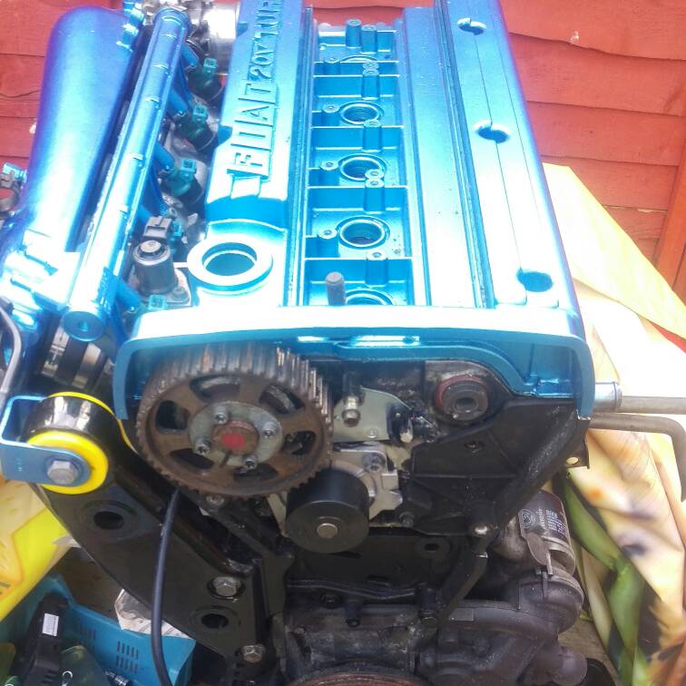

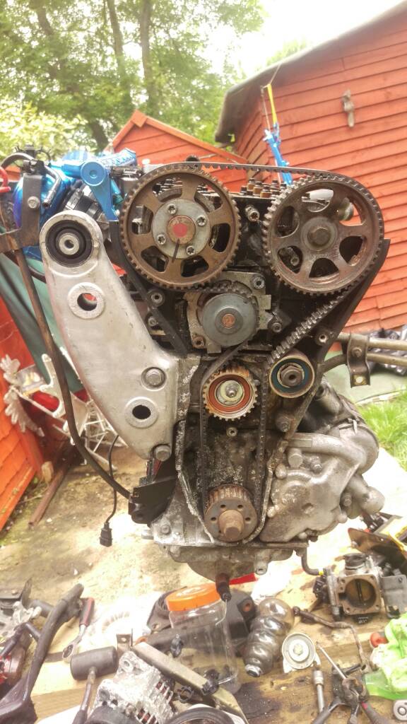

Right ....haven't updated in a while soo here goes....
Engine is out .....conrods snapped on 3rd and fourth pistons
Soo a temporary refurbed engine with 38k miles will be going in with all new top rebuild ...ie headgasket, skimmed head valve guides redone

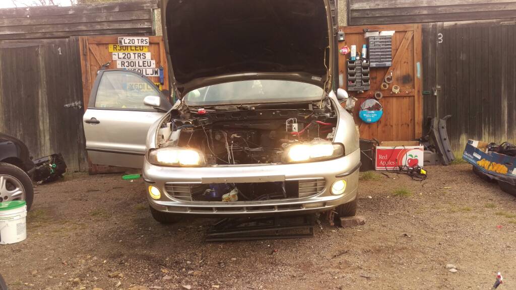

Also started stripping the front ....ready for painting
Wiring also started repairing as a shoddy job was done when the car was originally built

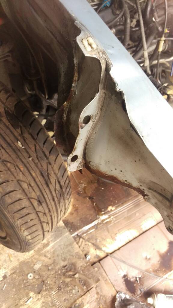

Alot of surface rust but thankfully nothing deeper

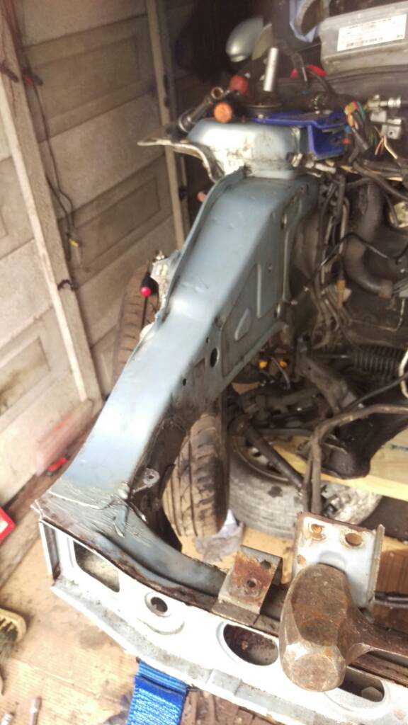

:Quick question has anyone removed the crash bar at the front ?? And that is slightly damaged from rot from the bumper support

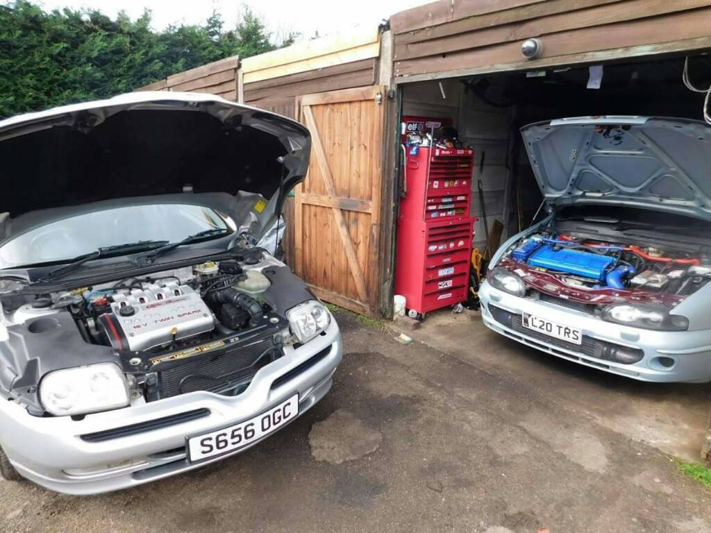

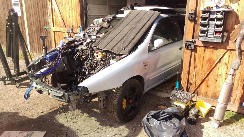

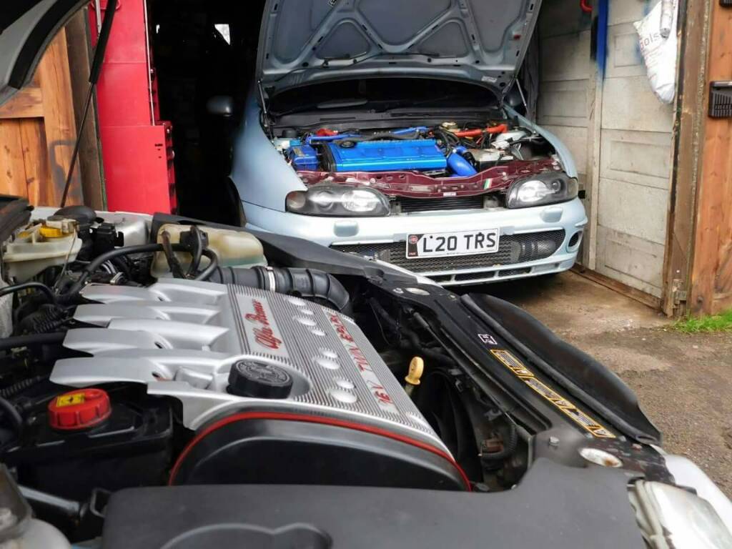

Right not been on the Fiat forum for a while, so thought o would update ......
The old shell has gone as was too rotten to deal with .....so I have reshelled the good bits into my 155 HGT shell .....
This includes a complete 147 HGT body wiring harness ...

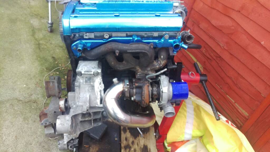

Engine is almost ready to go back in .....
Just waiting on the oil cooler pipes and filter relocation kit
The Garrett GT2871r Turbo is on and also just needs oil lines completed
3 inch downpipe is also finished
Bits that still need finishing :
Vibratecnics engine mounts
Apexi AVCR boost controller
Helix organic clutch
Gearbox cables for my 6spd box
Rear Axel swap
Fuel tank swap
Should be ready for its first outing at Brooklands for the Italian car day IMAG0545.jpegIMAG0548.jpegIMG_20161007_172604.jpegIMAG0513.jpegIMAG0276.jpeg
