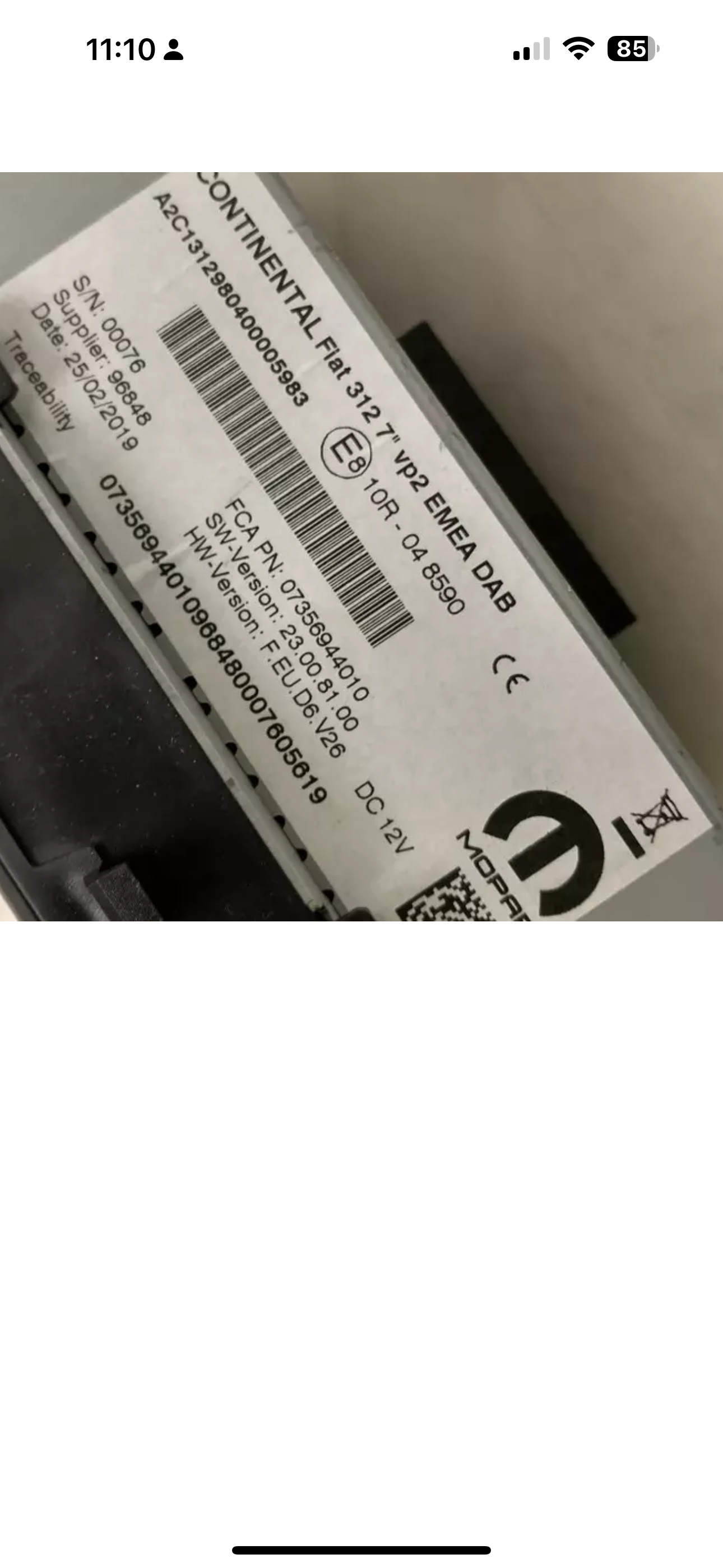

The model number of the radio/Sat system is
07536944010968480007605619.
The car is a 2 door hatchback.
When I was talking to the fiat dealer who was trying to sell me the new one he said Fiat need the vin number of the car when ordering a new radio. No idea why.
Many thanks for your interest.
I think that's the serial.
The model number should start with VP1 or VP2 then usually ECE or EMEA in it.
Thanks.I’ll bid for it on EBay.

I've just checked and I did another one of those the other month (312 dab nav), it needed method two though (open the unit to get the qr code from the motherboard)
There was a year when that switched. So as long as you're comfortable doing that, it can be unlocked.
