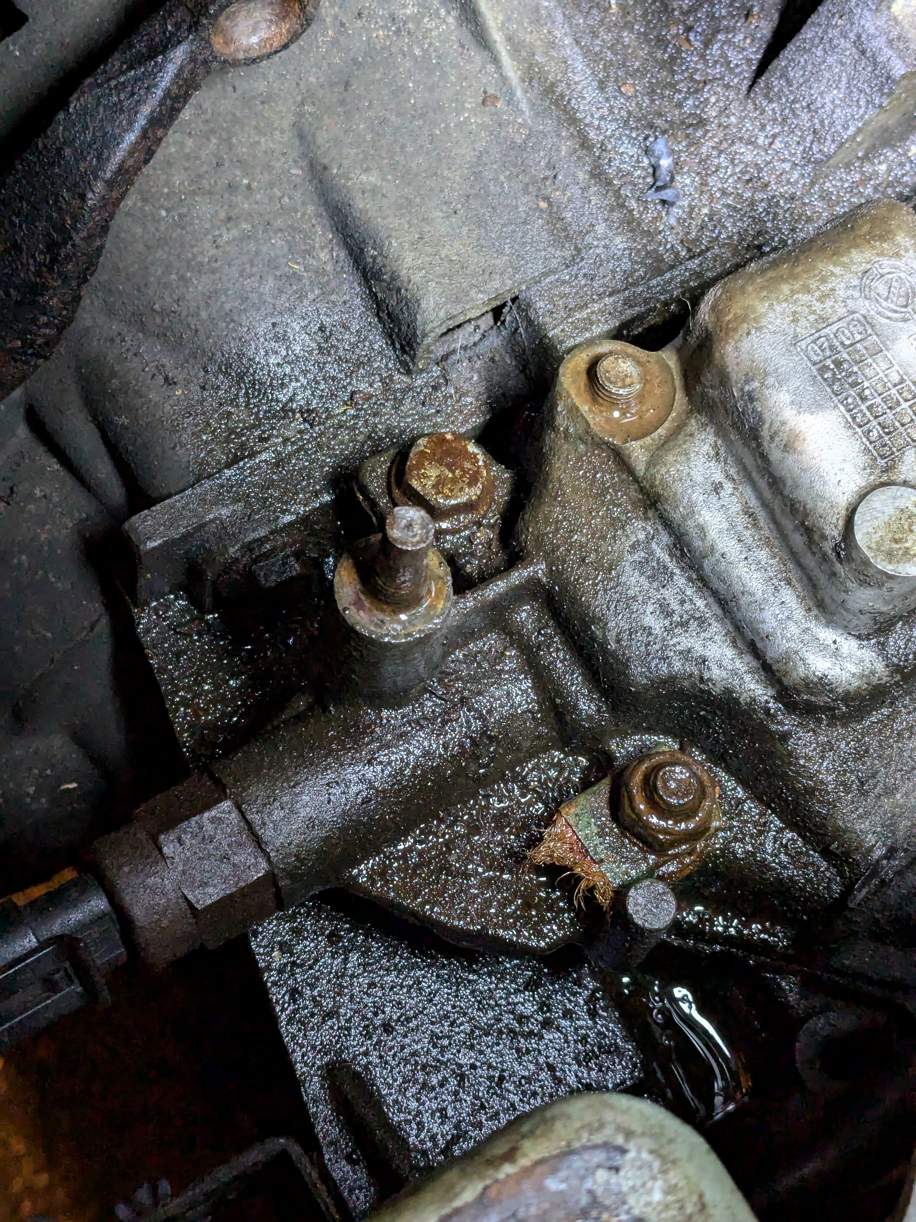

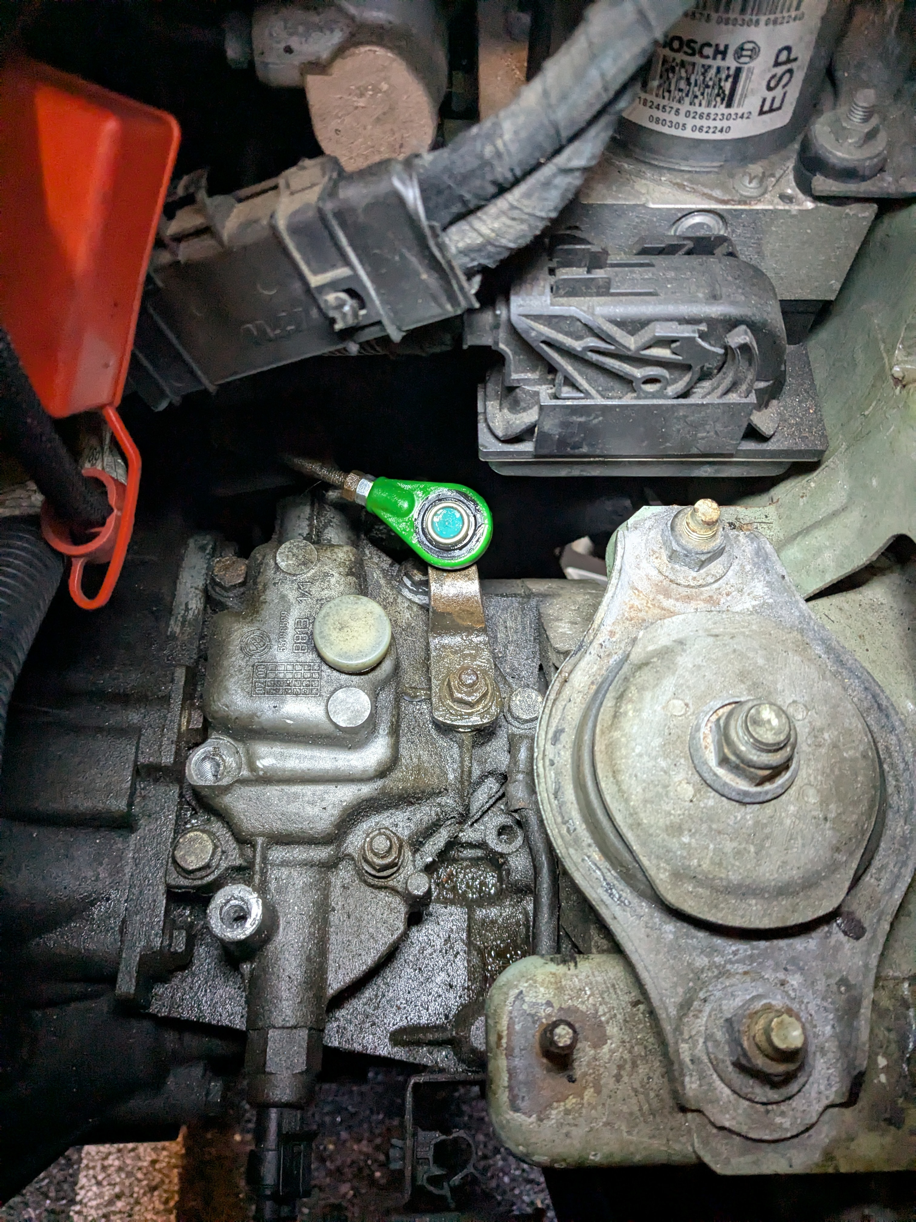

The stud for the earth is through the transmission cover and threads into the transmission body. Dual nuts on top to secure the strap. I took a photo cos of snapped slave cylinder bolts.
The nuts totally seized and I replaced the stud minus strap end. Previously an additional earth had been bolted to the transmission housing. Next to gear selector.PXL_20250206_144926470.jpg
The stud for the earth is through the transmission cover and threads into the transmission body. Dual nuts on top to secure the strap. I took a photo cos of snapped slave cylinder bolts.View attachment 461559
The nuts totally seized and I replaced the stud minus strap end. Previously an additional earth had been bolted to the transmission housing. Next to gear selector.View attachment 461560

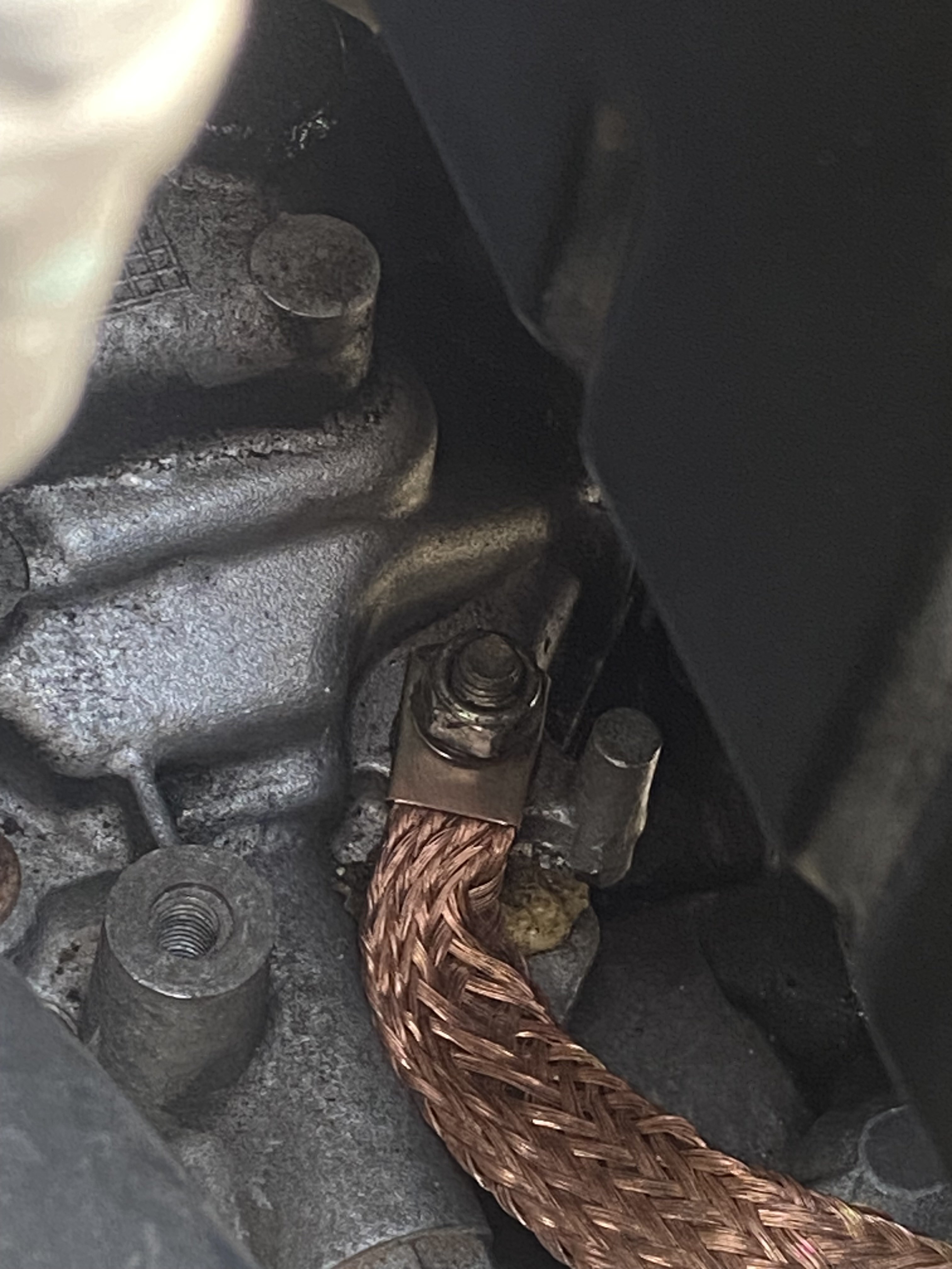

I just finished checking the main earth strap and totally forgot to take pictures. This is how the strap looks now
Previously the strap was black, covered in oil gum. I cleaned it with a wire brush and cleaned the points of contact (surface area, bolts, etc). I will take the car for a drive now and see how it behaves. Thank you for the help!
I just finished checking the main earth strap and totally forgot to take pictures. This is how the strap looks nowView attachment 461566
Thats in very good order. Great job of cleaning. You should offer a service on here!
