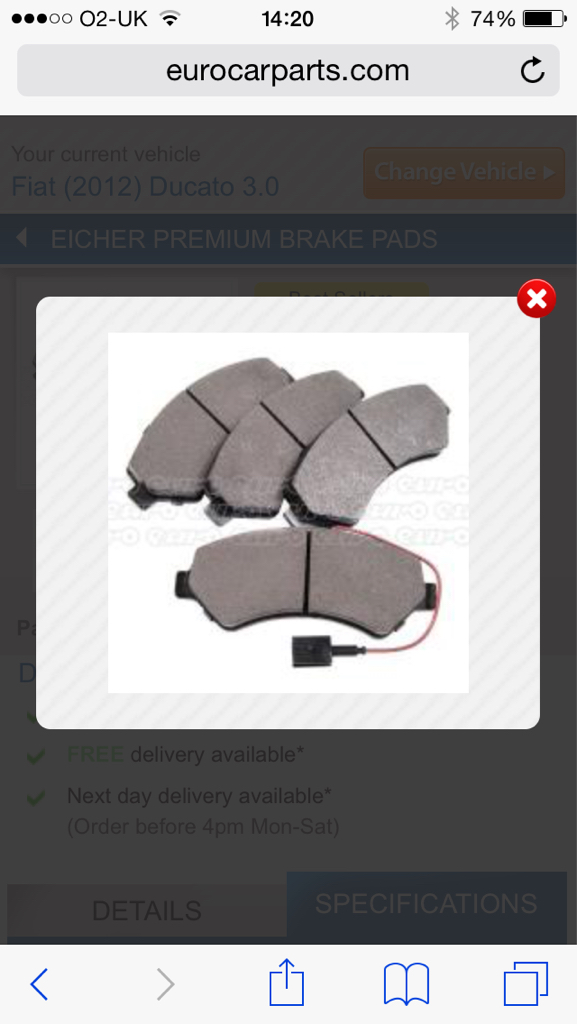

Can anyone with access please to parts catalogue (if it accepts chassis number) help me out,
Struggling to get hold of front discs, pads took two attempts
Now euro car parts are struggling also on front discs
The van is a Maxi L4 H2
Which I believe has heavy duty brakes and suspension
The pads are the ones in the picture
Discs are 300mm dia
Internal hole 80mm
But they say there are different thickness 24mm and 28mm
They say mine should be the 28mm thickness due to the pads fitted
And they're struggling to get them
I think they are the 24mm
(On they're website under my reg the 28mm choice States 73mm internal (hub) hole which won't fit
But they measured 1 disc they have and its 80mm!)
So can anyone shed any light on fiats part system on what discs are fitted please
Chassis number is ZFA25000002152601

Don't trust what factors say!
In end I went to fiat and obtained p/numbers
And put the factors right
Now have shiny new discs & pads fitted

51858362 is the gen part number for my van 300mm 80mm 24mm thick
Choice of two pads at factors, mine and all in the past have been the "shouldered lug" design as above,
Pagid part numbers
Pads 101545658
Discs 104735058
(Euros list for my van the correct discs but the other pads, when I told them pads were wrong they decided my discs should be 28mm thick but they are 24!
Took them 4days to get the 28's in, I started thinking somethings wrong, surely discs are avail as the vans common, I was right to look into it)
