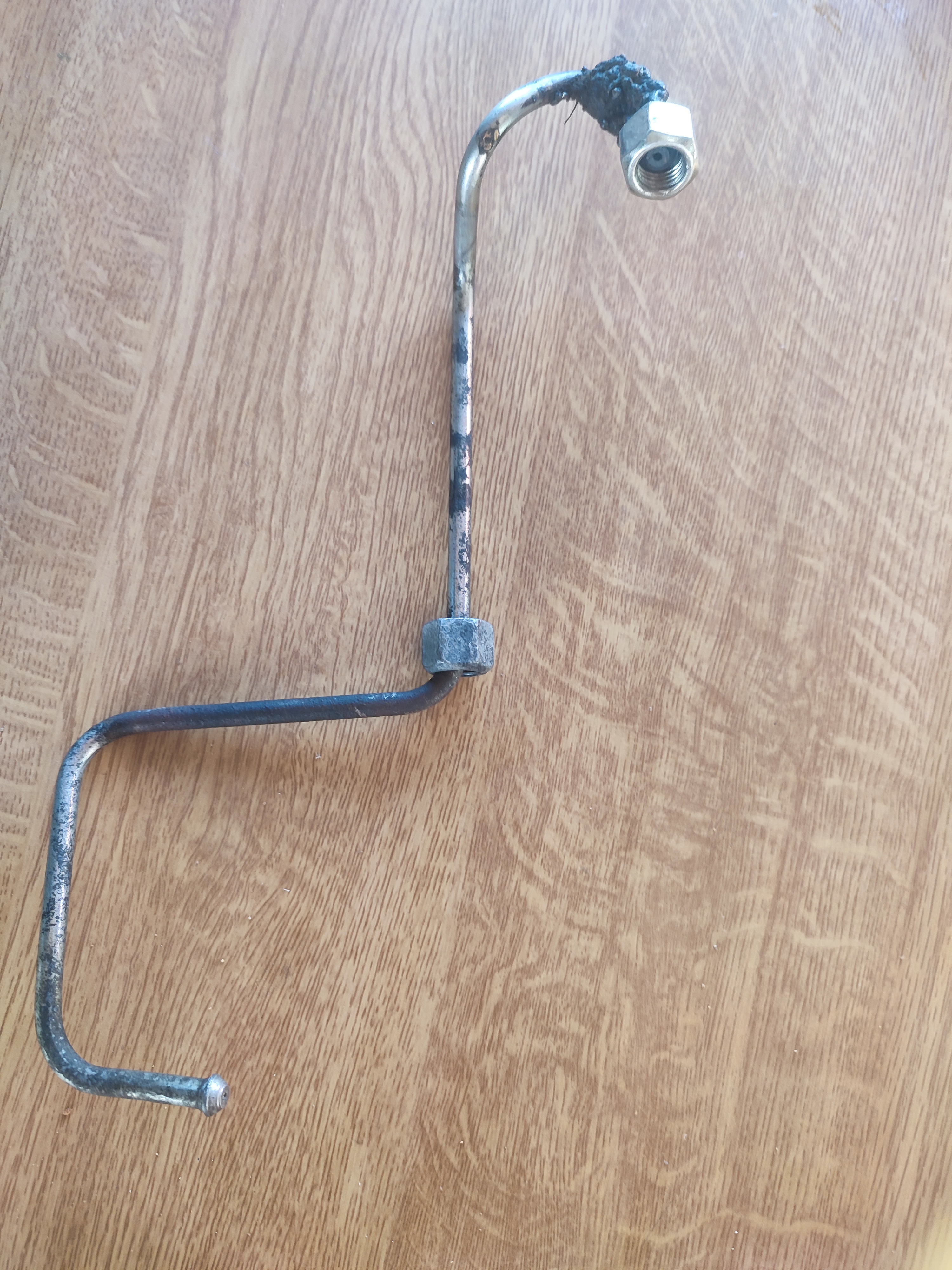

I have a Fiat Ducato (280) 1987, 75 hp, 2.5d, engine code 8144,67.
Its currently in spain.
One of my fuel pipes has broken and im looking to replace it but i cant find one, I looked online both from new and used. Ive asked local mechanics and no one knows how to get it.
Anyone have any idea how to find this high pressure "metal" pipe?
If nessecary ill buy all 4 of them.
Thanks for your help!

A quick search reveals union nuts, and olives offered for sale. Perhaps you could have a custom made copy of your original pipe?
Thanks for your reply! I dont know whah unions nuts and olives mean in this case :)
Ive asked around in many difrent places and on one knows anyone who could custum make one.
Sorry, I had incorrectly assumed that it was an injector pipe that had failed.
Can the broken pipe be repaired/replaced with diesel proof rubber hose, with end fittings reused.
From what I understood, the pressure is to high for them to be safe.
Yes if this is a high pressure injector pipe. I am sorry but we may have a translation/identification problem. When I mentioned component parts of injector pipes you did not recognise them. For picture of those parts see here.
Have a look at this UK website, I was thinking of your using a similar company.
Thank you for your answer! Yes the second link you provided looks like they could make one. I'm supposed to drive the car in a few days so I still hope I can find one intact somewhere.
