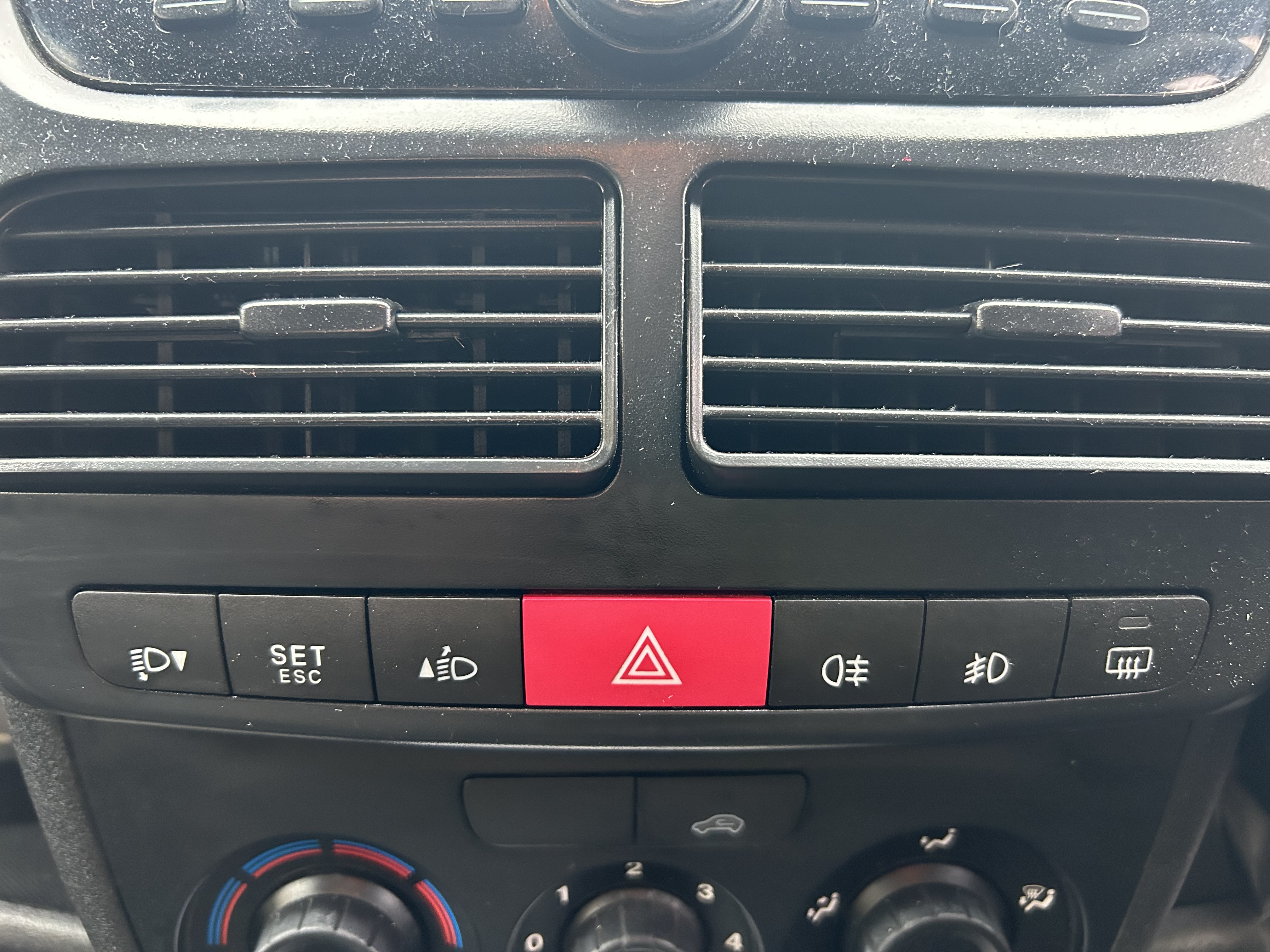

Hoping someone might give me a place to start.My 2013 Doblo cargo just failed MOT on headlight levelling.It appears that when you press either up or down adjust button it goes straight to vans menu rather van adjusting headlights.The tyre centre that done test don’t fix things like this.Any suggestions?.Thanks for your time

Just had a quick play with my 2014 Vauxhall Combo1.3MJ (Doblo in drag);)
All I did was the up and down on the dash control with headlights on without touching the menu select button and apart from the wobbly photo you may be able to see it worked fine.
So what I suspect is your centre "menu" button is sticking on. You may be able to spray it with good electrical switch cleaner and work it a few times, otherwise probably replace it.:)

What I mean by hazard light switch is the whole switch cluster which encompasses menu/headlight up/down buttons etc.Just going by what it’s called by fiat shop
This is what I’m talking about 👍

Hi Paul.Not sure if you’ve sorted your problem but I installed new switch today and it’s working perfectly,so obviously switch had gone faulty.I bought a brand new switch/button cluster for £33 delivered from a firm in Hampshire.If you want their details let me know
