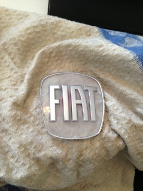

you need to get the paint thinners (nail varnish remove is best) and put it onto a cotton pad and take off all the red paint and the grey fiat emblem this will take a while but with some persuasion should come off.
you are then left with a clear transparant plastic badge with fiat pressed into it.

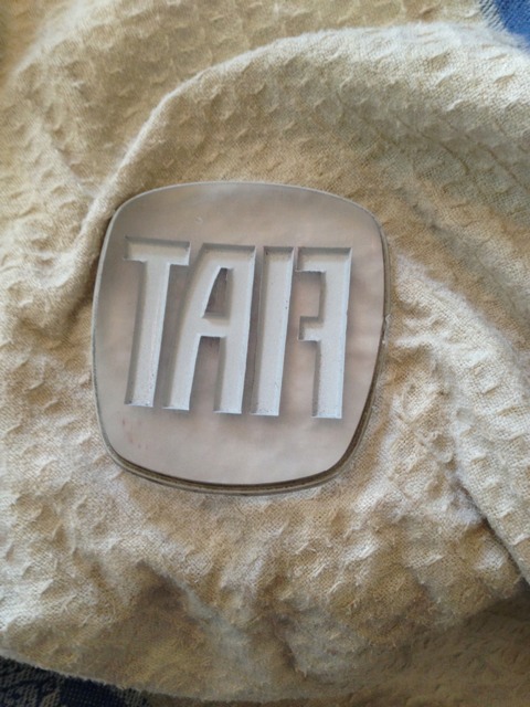

you then need to choose what colour you want the fiat emblem to be i chose black so i got a 2 letre bottle top and poord some black plastic paint into it. i then pourd the paint onto the fiat emblem so it made like a mould
i then left it over night to dry. dont wurry if the paint goes all over
it is easy to get off the exess with a cotton bud with some thinners on it wen it has dryd (just make shure you dont let the thinners drip into the recess were you have pourd the paint or it will eat away at the paint and you will have to do the whole pouring paint buisness again.
when you have removed all the exess paint and made shure it is all dry you then need to turn the badge around and make shure there are no gaps in the paint and you are happy so far if you have gaps just pour more paint into the recess and leave to dry again.

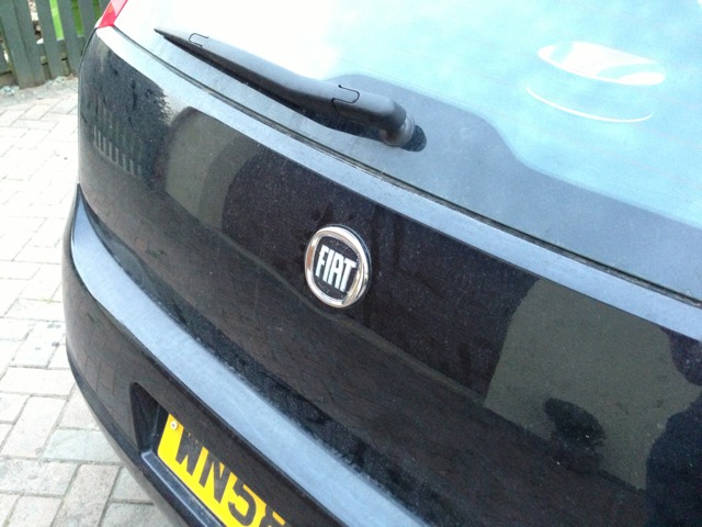

i then waited for it all to dry then got some double sided sticky foam (the same as the stuff you 1st had to remove of the badge) and cut it to the shape of the white and black fiat insert and stuck it back into the backing. the finishd product should look somting like this
(the reason the black outer ring on the picture is so dull is because it only had a black base coat and not the 3 coats of gloss)

(as before i didnt have a picture of the before i started the work)you need to get the paint thinners (nail varnish remove is best) and put it onto a cotton pad and take off all the red paint and the grey fiat emblem this will take a while but with some persuasion should come off.

(this picture is after the 1st coat of black paint)i then waited for it all to dry then got some double sided sticky foam (the same as the stuff you 1st had to remove of the badge) and cut it to the shape of the white and black fiat insert and stuck it back into the backing. the finishd product should look somting like this
(the reason the black outer ring on the picture is so dull is because it only had a black base coat and not the 3 coats of gloss):worship:I AM SORRY ABOUT MY SPELLING :worship:
