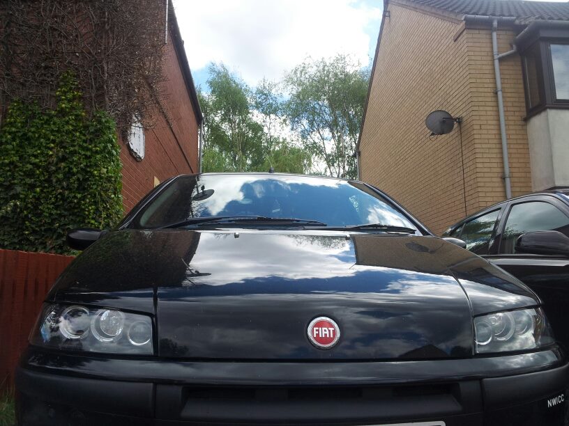

Here's the result you should have:
One of those cheap but effective mods that will make you're Punto stand out from the rest out there
